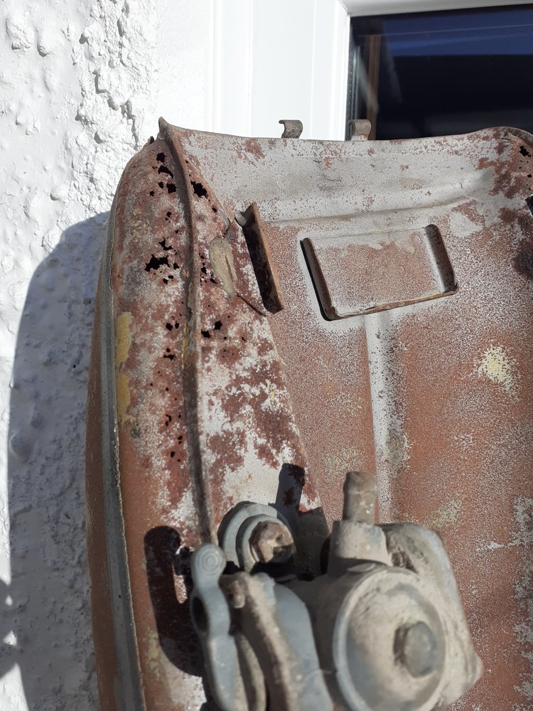

Which will look terrible if not done extremely well.I'm with GraemeVW on that one, but if you do solder, those holes are too big for just solder, so standard procedure is to tin the tank, then float a copper patch over.
Some very optimistic suggestions being made here
Soldering or brazing.Lol, which ones?
No it's called "Air soldering "Soldering or brazing.
Im no expert dont you need to have some metal there for the solder to stick to ?
Learned something new todayNo it's called "Air soldering "
Brazing across small gaps isnt tricky at all . One of the best things about brazing is that it works on thin things relatively easily without destroying the parent metal , and the ability to bridge small gaps makes it great on old car body work , and dodgy old mot repairs that were never seen again.
Brazing is a fantastic process , I have used it in the past on lots of things , you can reinforce thin steel work , bridge gaps and holes , and put things like less than perfect wings onto less than perfect cars with results that are every bit as good as welds in that application , braze tends to spread the load over a larger area which helps things along too , as your not actually melting the parent metal , if it goes wrong you can just melt it off and have another go , braze flows well too , with practice , plus it will skin and you can then go back and lay braze to braze and build up an area or bridge a gap , its a skill well worth developing , and if you have a heat source , either oxy acet or even oxy prop all you need is a few rods and a tin of flux and your off .That's interesting. I've never tried any brazing. Sounds like a better option than soldering then.
As usual though, the best option is the one you think you have the best chance of making a success, which is very much dependant on skills and experience.
