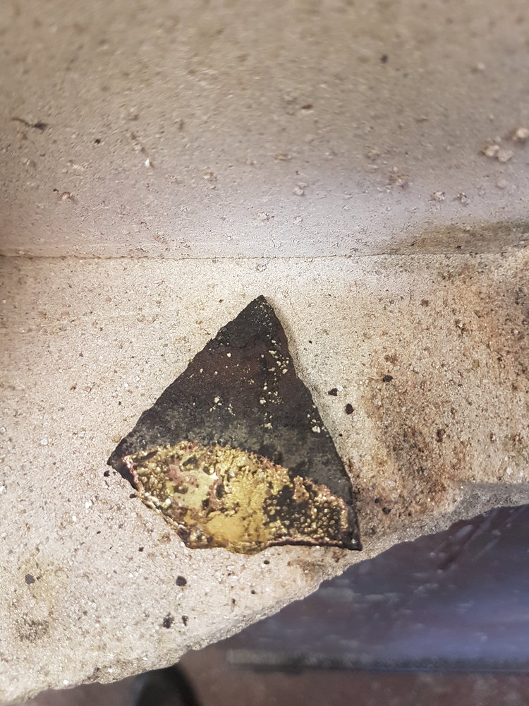

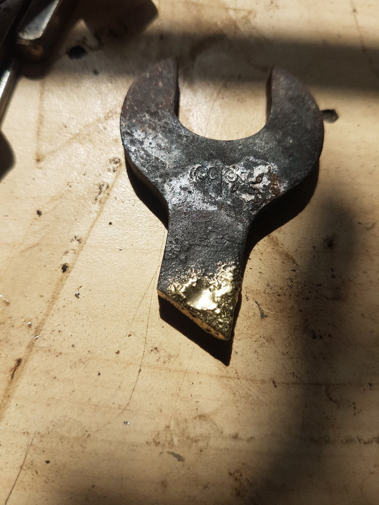

Dunno, I watched a mate (sadly now gone) do it many times with OA with steel of various thicknesses. He always used to get the subject red, dip the rod onto a big rusty square tin of white flux powder, and it always seemed to take, and then chase the molten brass around with the flame.Surprisingly, heat wasn't an issue. I had it pretty much yellow!
snap ,,,,Yellow is probably too hot. Warm Red is all you need. Dull red is about 800 degrees.
If your metal is too hot the zinc will boil off immmediately and the filler will ball up and just roll around on the surface. Also you'll pass the working temperature range of the flux

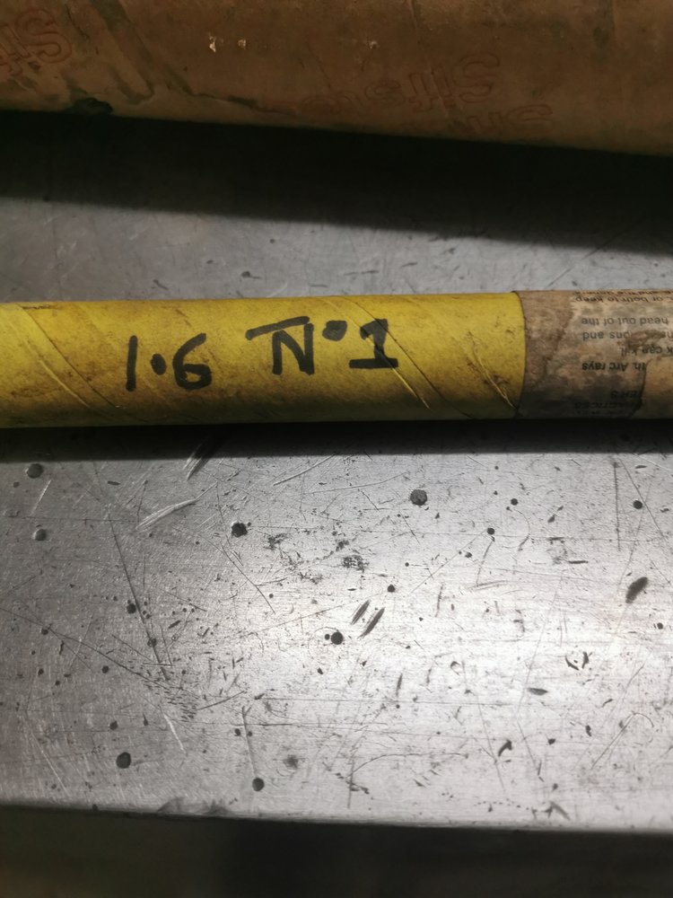

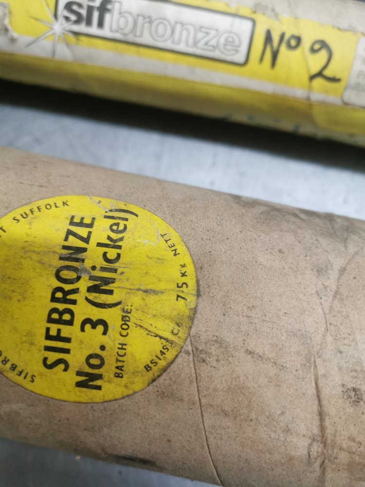

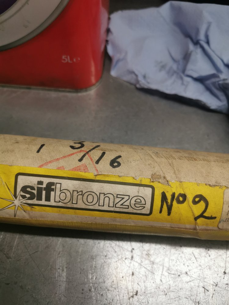

Went to my local welding suppliers today and they couldn't help.Think We have some old Sif rods will look over week end might have other makes as well
Would be free except for post
Thank you.
i just know they flow well and do the job
