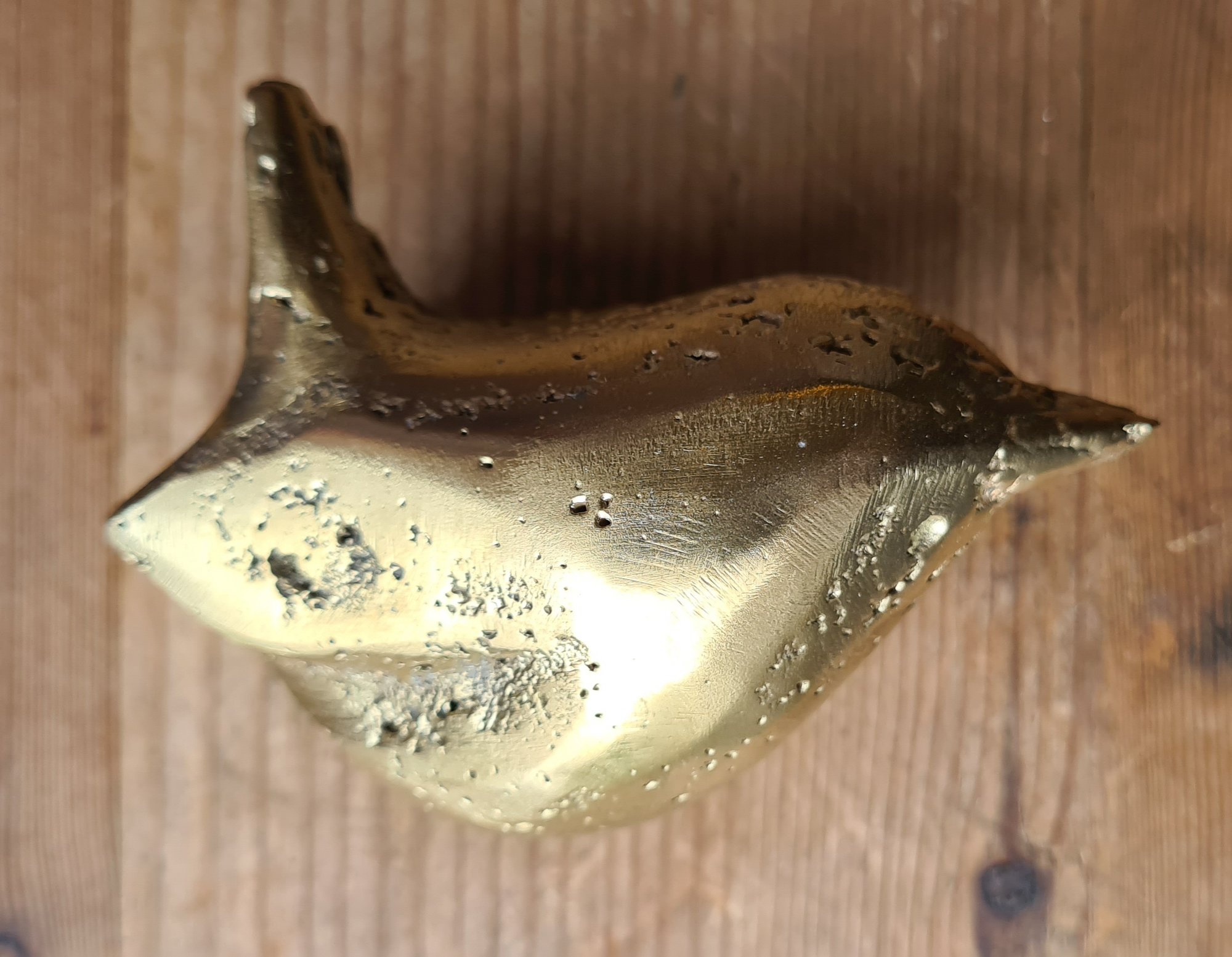

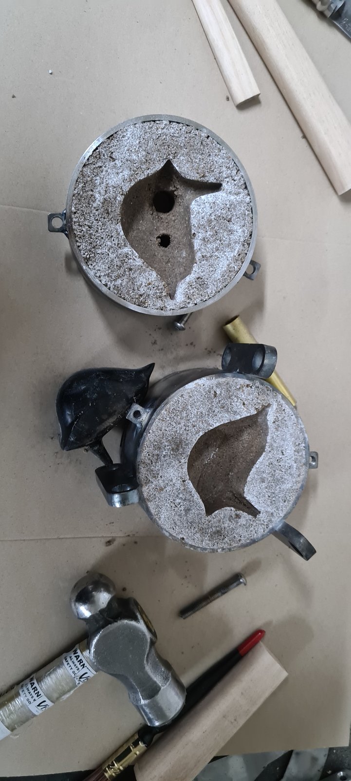

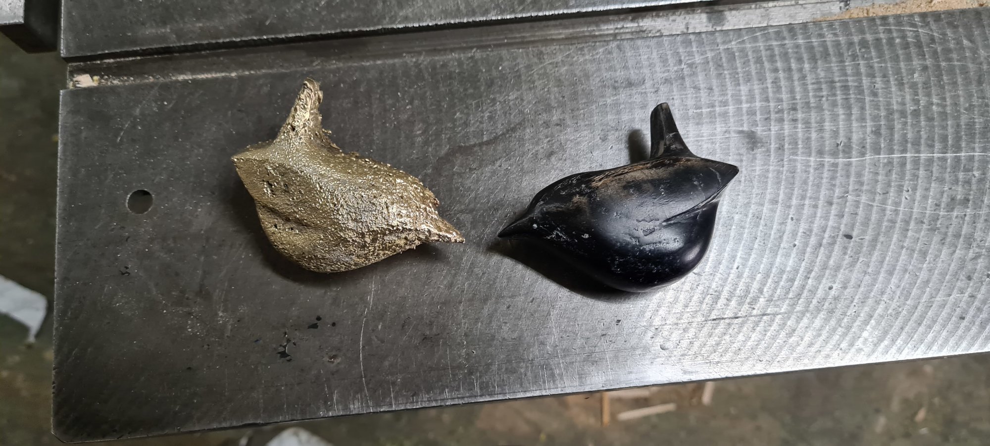

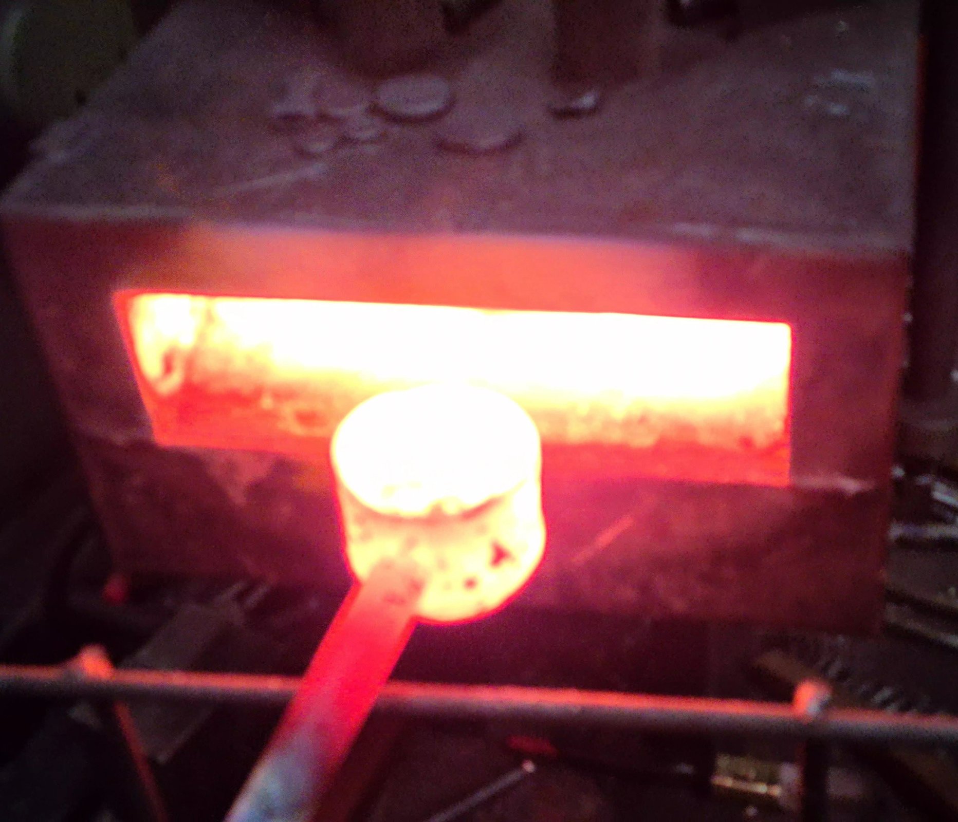

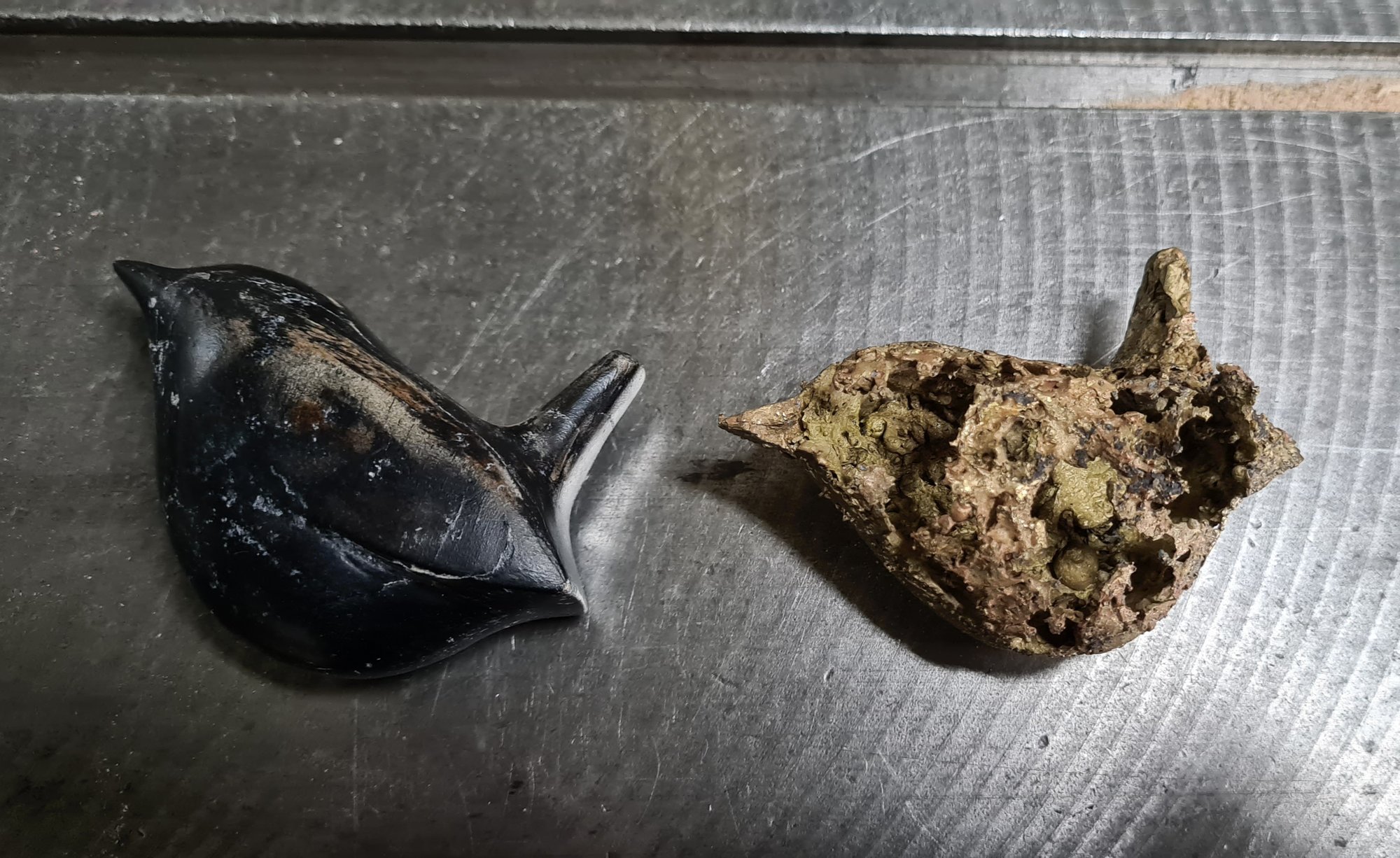

I've been contemplating casting something for a while (I bought the clay for the greensand over 5 years ago
) and finally decided the other day to crack on. I glued three pieces of wood together and whittled a stylized wren. Trying to get it as smooth as possible it's been filled and painted a few times. I made some greensand with bentonite clay, silver sand and water and made a container to cast it in. I went with brass for my first attempt cos we've loads of scrap and heated it up with the forge in a crucible made from the bottom of a disposable gas bottle. I don't know if my vent hole was too small or the sand is too wet, but after I'd got a bit of brass in it blew some back out. All in all I'm pretty happy with the result for a first go even if it is ugly. Next up ally and copper bronze, I'm not keen on the brass the zinc is a too smokey and I'm sure partly responsible for some of the pitting, I've used ally bronze in an open mould before and it was a lot cleaner.
