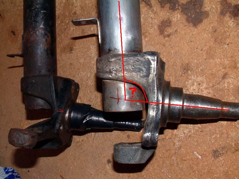

Hang on a sec are you sure the struts are the same damper rate and more important spring rate ??
I had a volvo xc 70 here and it was a right pain pulling under braking steering etc I did everything turns out Volvo had fitted wrong front spring to one side that took a while to sort.
The full strut units are near new and the springs are what came of the other and its was running fine, well on the road untill the engine blew.
i did say check the tracking
