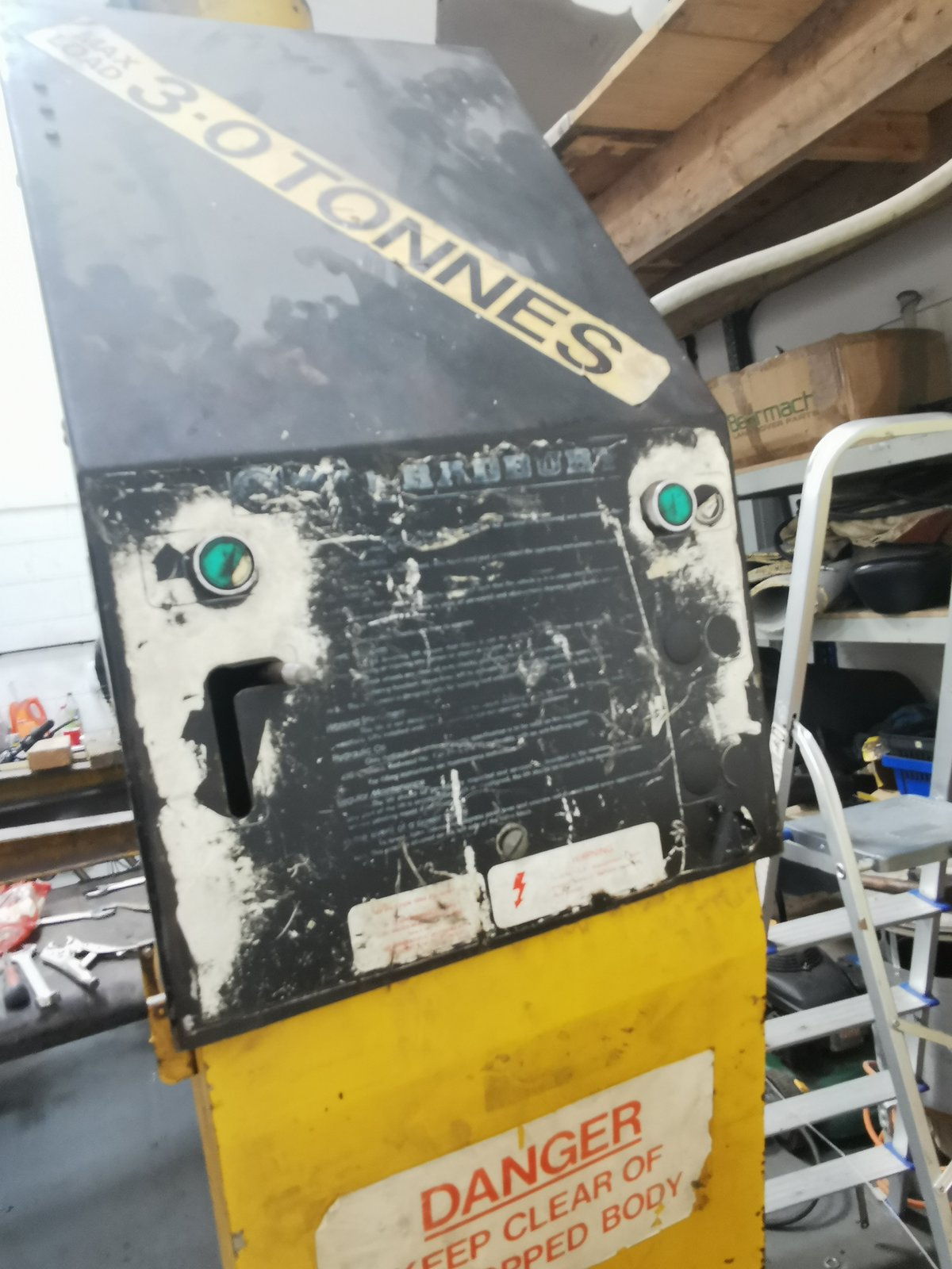

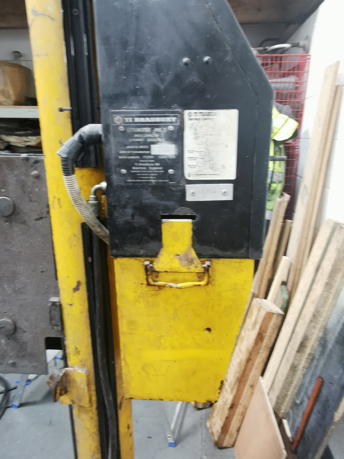

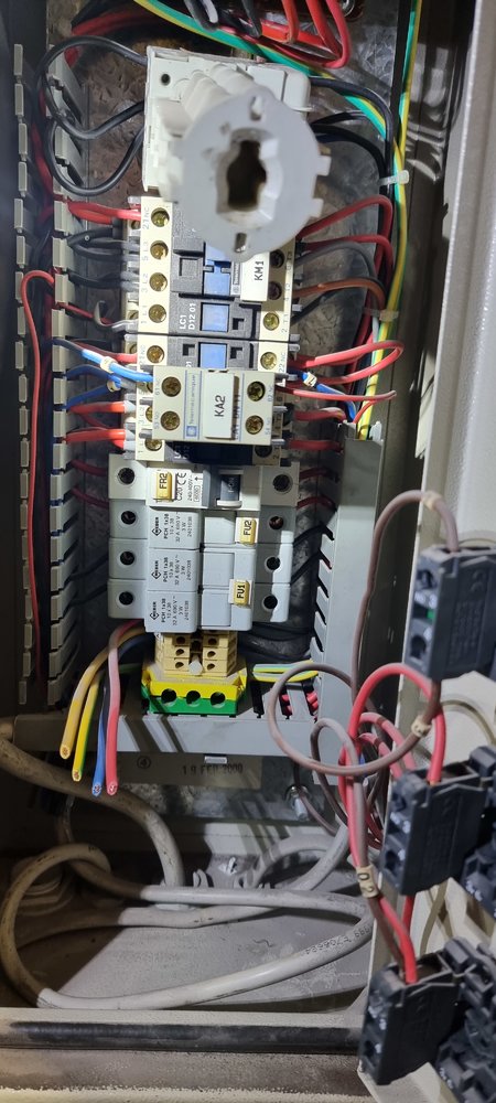

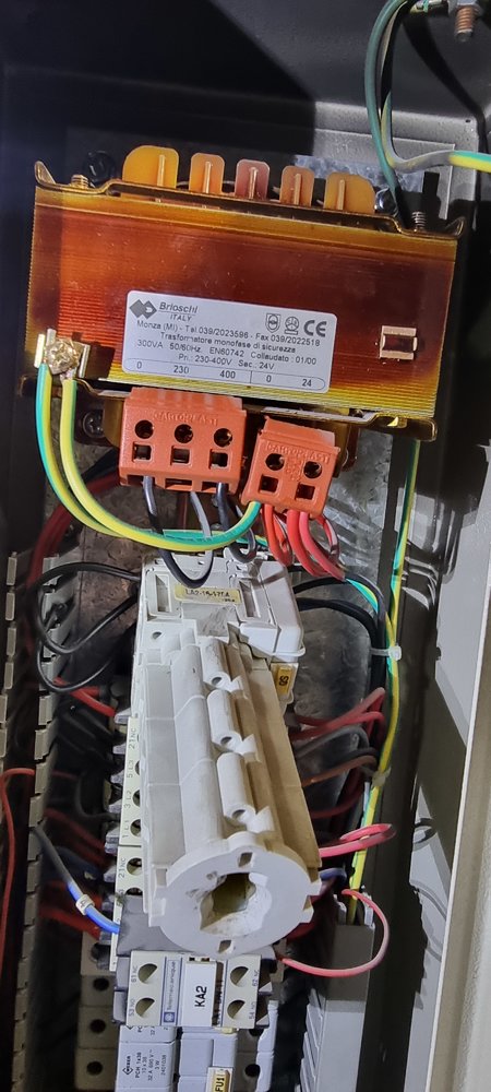

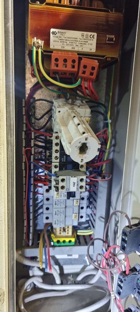

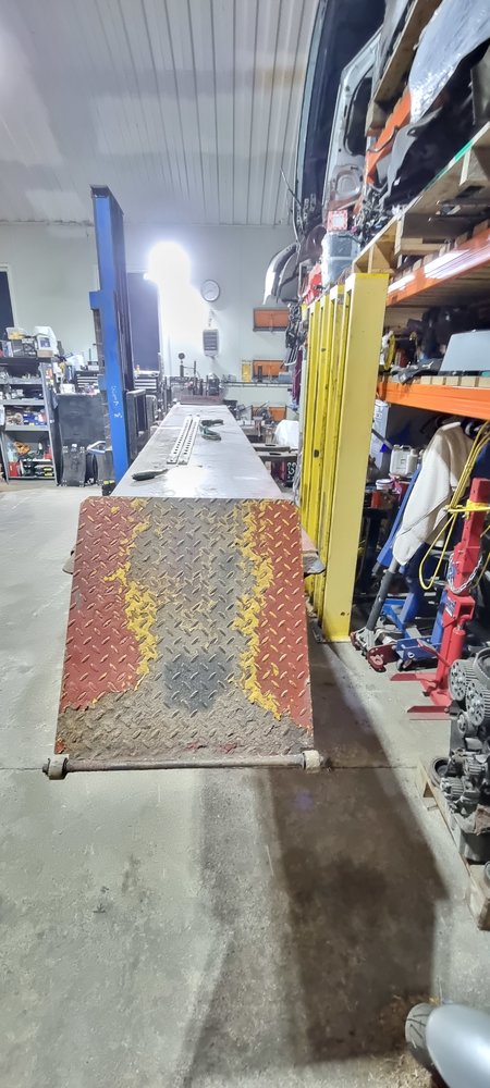

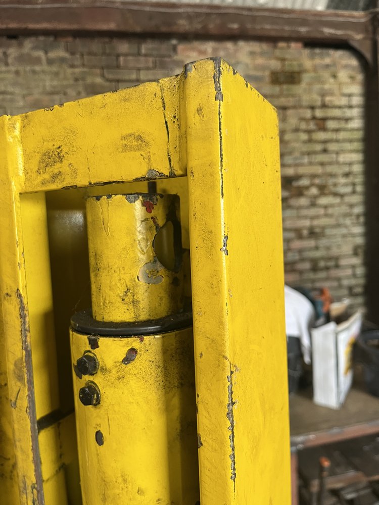

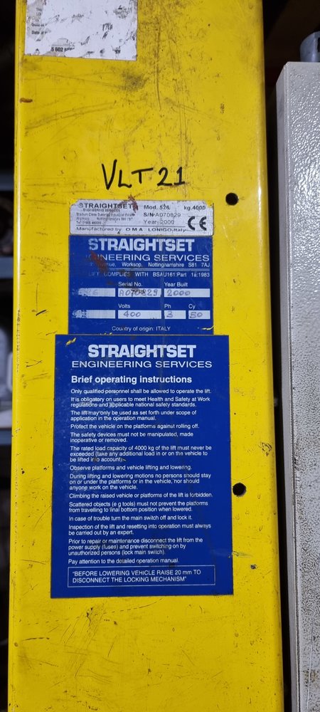

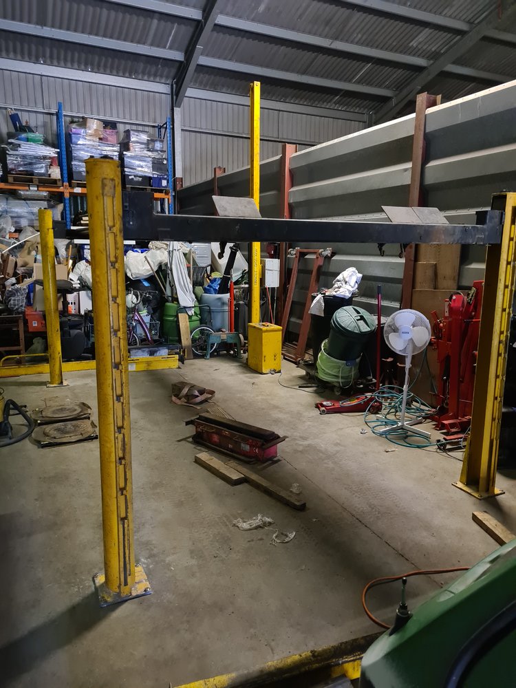

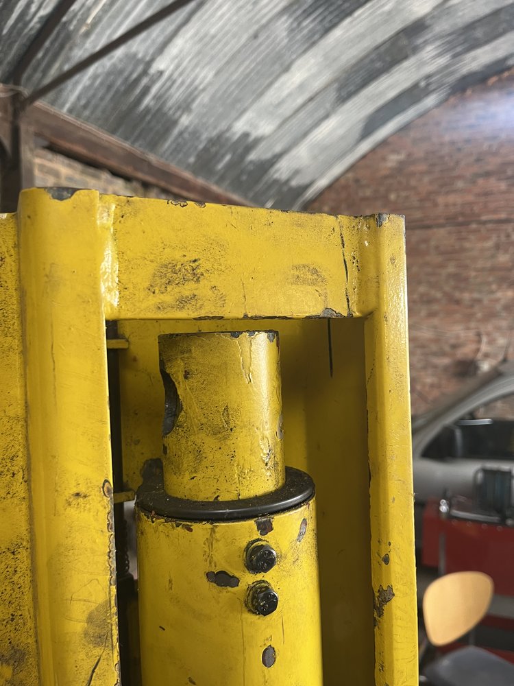

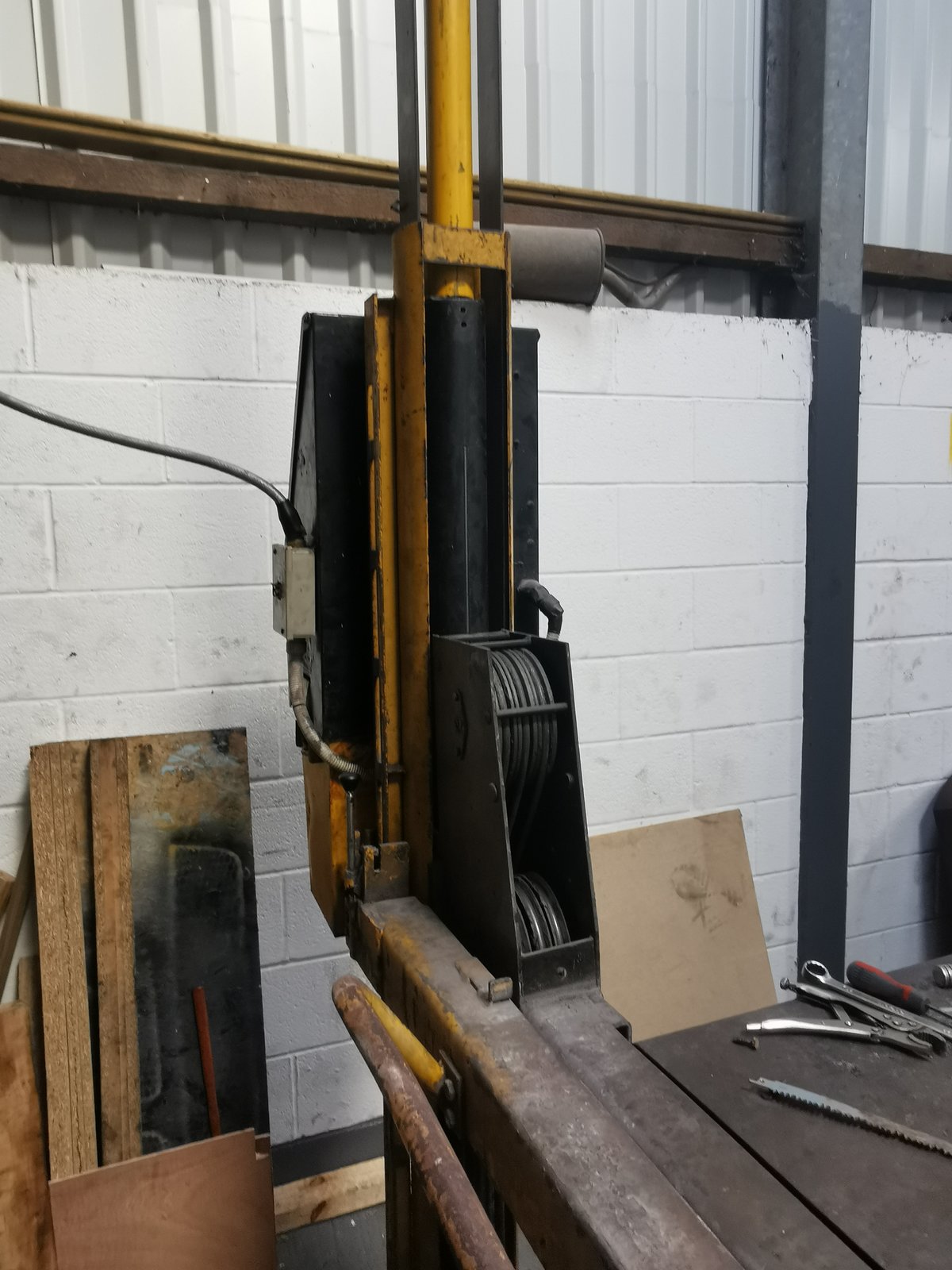

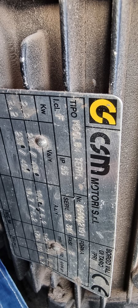

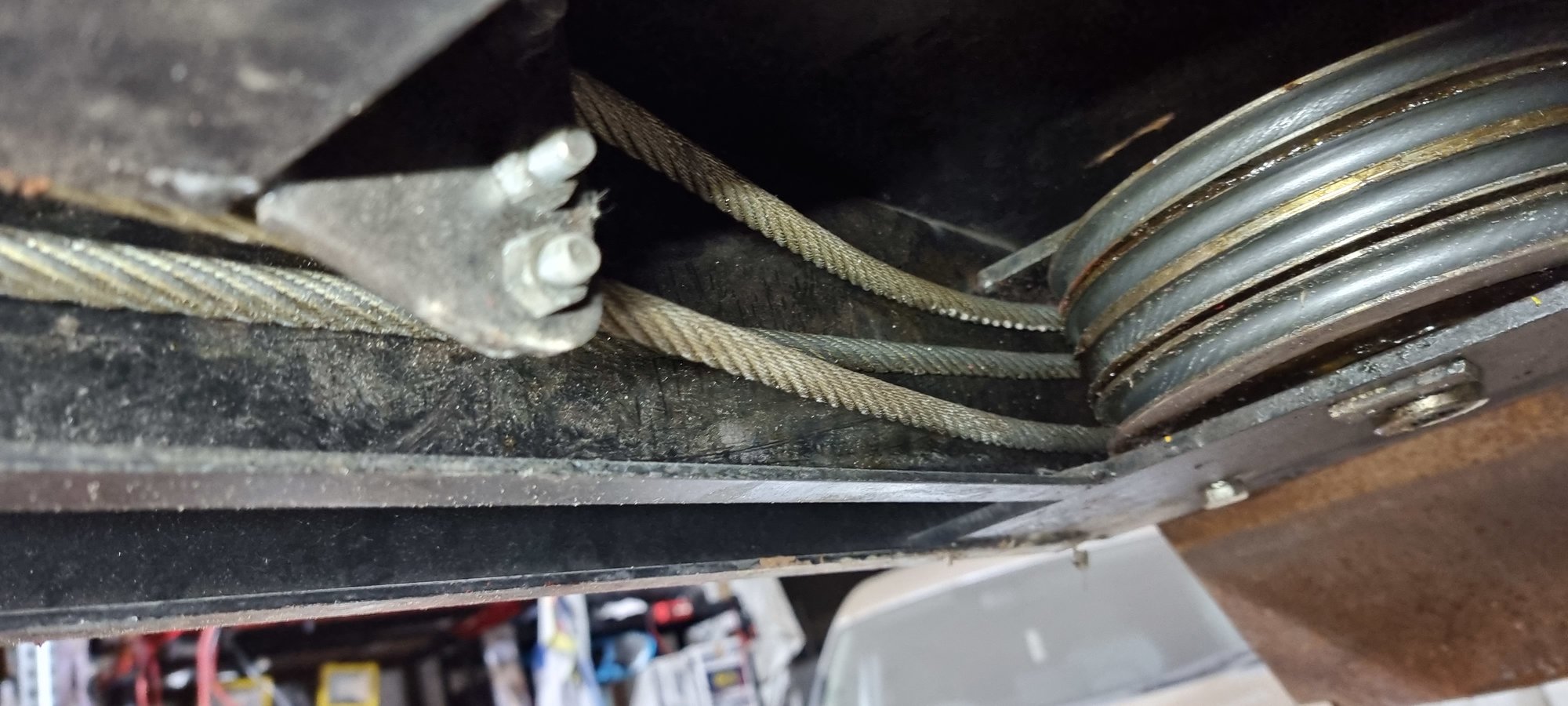

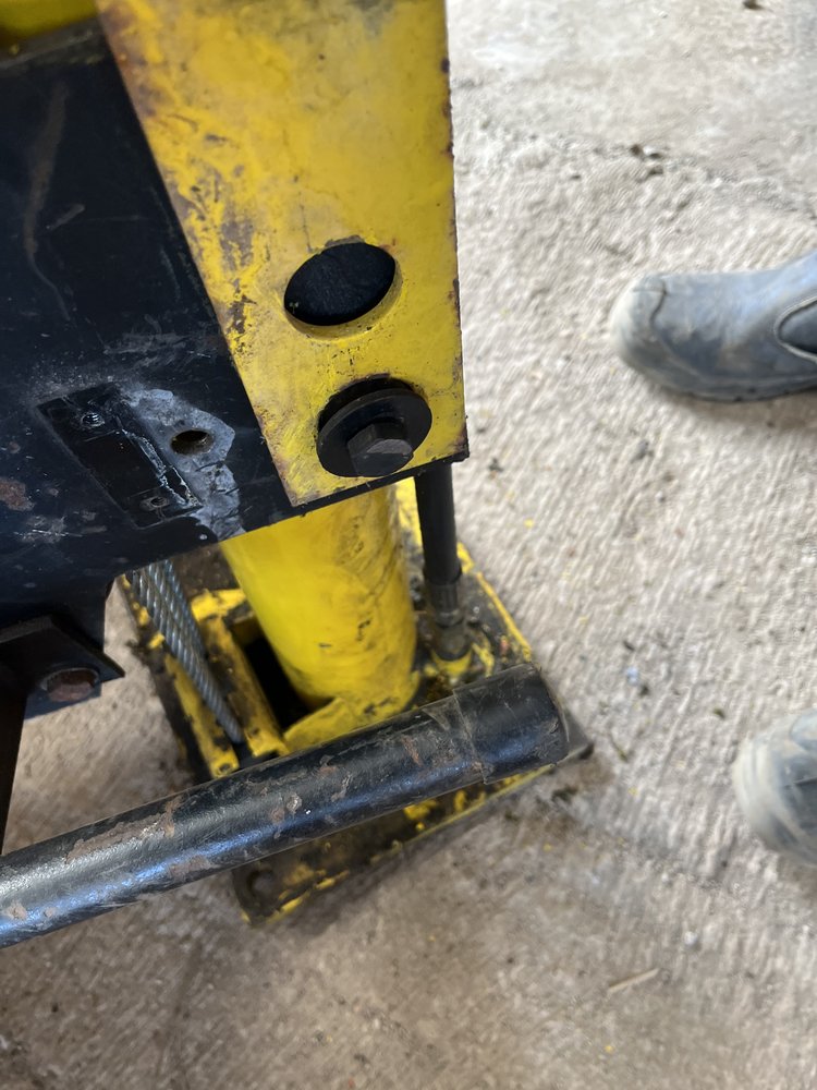

Hi, new here, just bought a mk3 Bradbury 4 poster lift, have got it in position where we want it, cables all connected but no up, or down motion when buttons pressed, worked fine when we went to view it but since got it to our unit, nothing, motor is engaging but no movement, any ideas please thanks
post a few pictures of the main pillar and hydraulic tank to refresh our memories! on my Bradburys, I had three at one time, the motor ran a pump so maybe the motor is running backwards?? or the hydraulic system has an open valve and so cannot build pressure in the ram? one of mine had the tank seperate to the main post, one it was at the bottom of the post,
