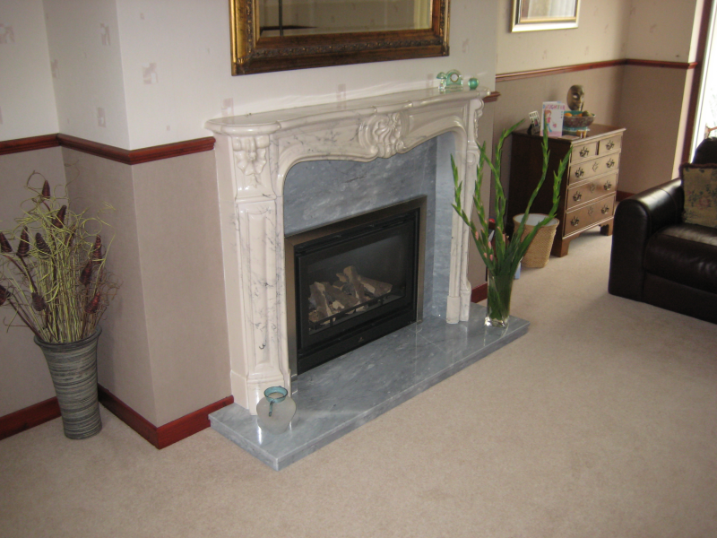

The distances around the stove, there are 3 main factors.
Distance to combustables, which isn't an issue for you.
The manufacturers distance, if they have one, which is so the body doesn't overheat and buckle/crack
And having air space for circulation. Air gets drawn up from behind the stove. If its too close, heat will go into the wall instead.
You may also have to consider heat into the fabric of the building, but from what I saw in my skim, your all good.
What stove are you fitting?
What grade liner?
Got all your connection and termination details sorted?
It's all quite straight forward but if you want to know how info anything, just ask. I've pretty much worked out the easiest ways to do things well as I probably fit 3 a week on average.
