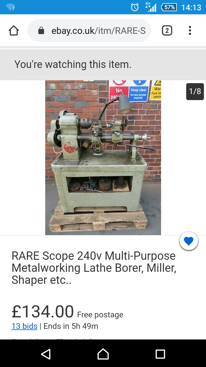

    Hi all,
    Another newbie questions.
    Ive been looking at buying a small lathe, just as a hobby lathe, i had some good advice from here last time with a model c boxford,
    Im now watching another model c, it is advertised as having manual cross feed, and change wheels etc, the pictures dont seem to be a model c, would i be right in thinking this is a model BUD. As i can see the clutch under the cross side.
    It has a lot of extras, and is only 15 miles away. the price will probably rock nearest the end, so i also looking at the scope lathe, any advice of what to look for or avoid would be much appreciated, the scope i can views, as its too far away, but has free Delivery.
    Many thanks
    Paul Screenshot_2020-06-29-14-14-32.png Screenshot_2020-06-29-14-14-32.png Screenshot_2020-06-29-14-13-53.png

    That looks for all the world like a BUD but it's a mixture. It has a MKII head and it's on a MKI stand. The lever on left hand side of the stand is the belt tensioner. MKII/MKII used an internal arrangement.
    I've found the auction: As above, fixed steady, no travelling steady, clog-heeled toolpost (replace with a QCTP). Some changewheels but does have the 100/127 Imperial/Metric converter (so 8tpi leadscrew). Metric cross slide feed screw with a damaged handle, so the screw may be bent. Catchplate with one drive dog and a two-way toolpost that I can't identify.

    I'd expect to get a Model A for the money. But, as you say, they are starting to attract a premium price. You want one that's as fully loaded as possible. It's the things like steadies, changewheels, milling slides that really push the cost up if you have to buy them separately.

    There's a much better equipped MKI Model C. Dickson Toolpost with lots of holders, DRO, steadies, and collets, on Home Workshop.
    No mention of change wheels. Wrong end of the country, but might be worth considering. they're not too difficult to move.
