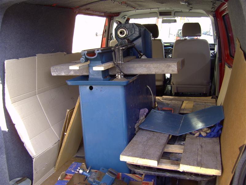

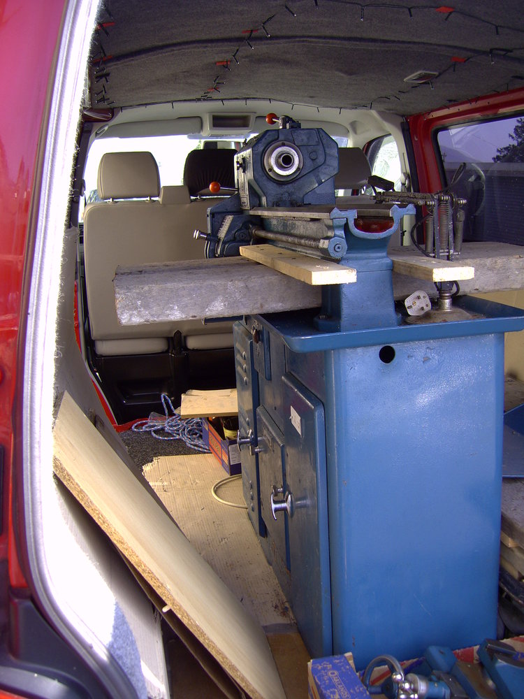

Fit in my VW Transporter with overhead room to spare. Loaded it by using a couple of 4" x 8" timbers under the bed so it could be loaded and unloaded with a forklift, after I removed the carrige & tailstock.

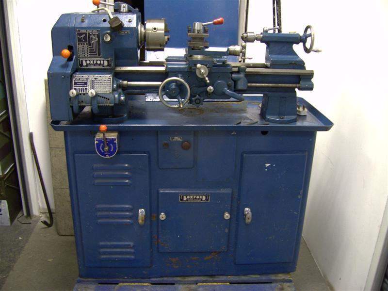

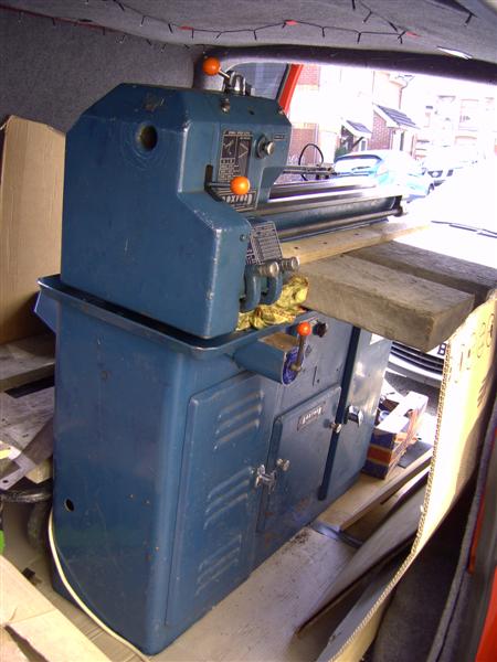

I got a BUD into the back of a Berlingo car, took off tailstock, headstock, saddle, motor out etc. Leave the bed attached to the cabinet. Fairly simple strip down, but the bolts which attach the headstock are fiddly and need a thin spanner.
