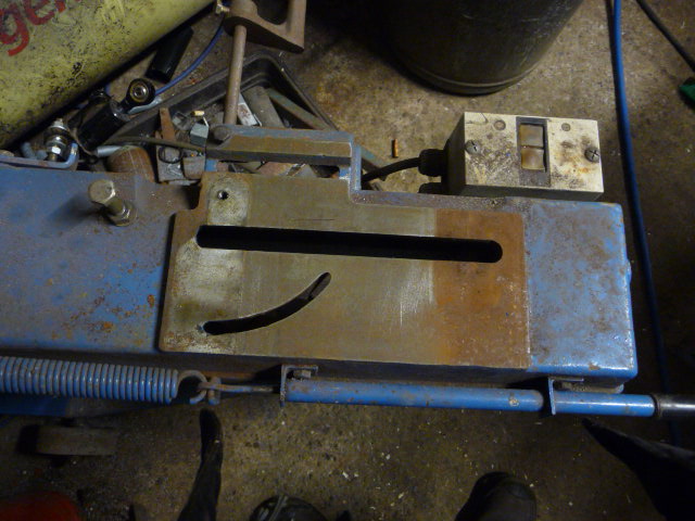

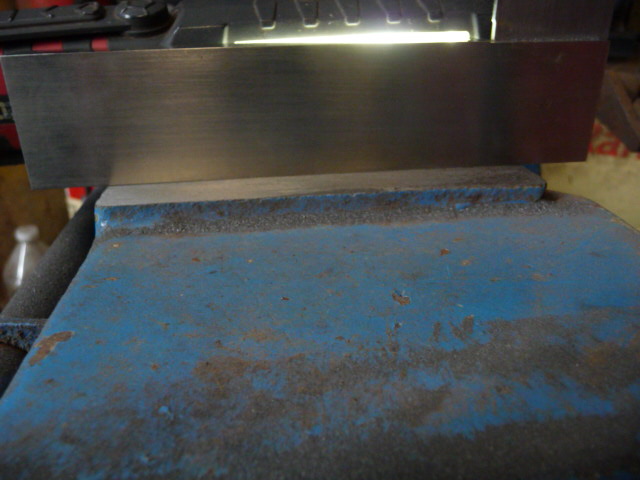

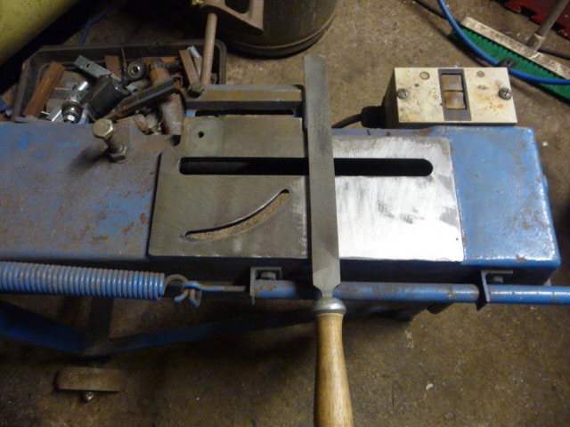

Roughly what height is the bow? 1mm, 2mm, etc.? How long forward to back is it? If it is local to the end near the pivot, maybe moving the fixed jaw away from the pivot would work. That would reduce capacity but maybe that is not a big loss for you. If the bow is not too much a 12" coarse file might sort it.
Its bowed the whole way along the slot so moving the jaws will not work.
