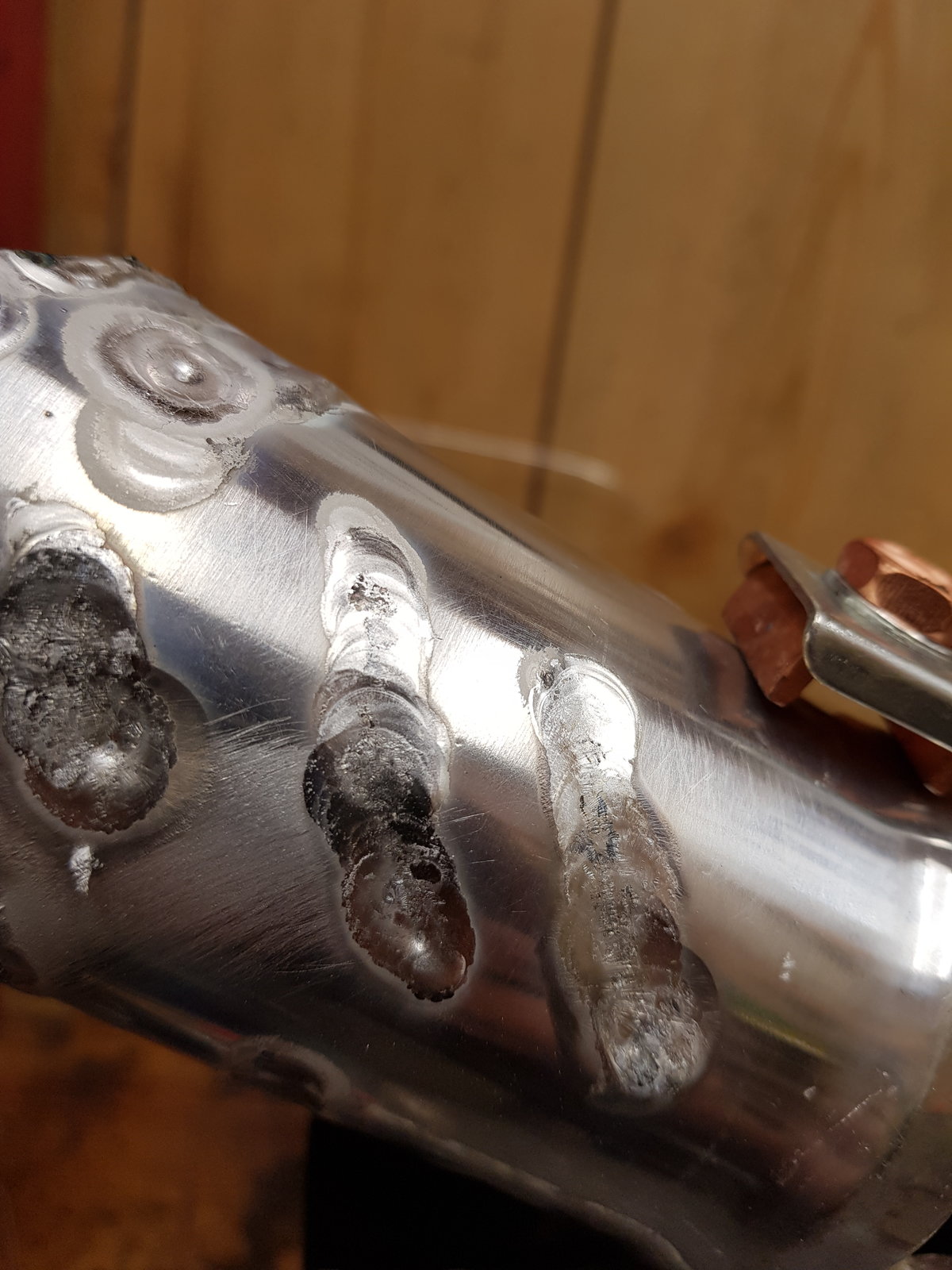

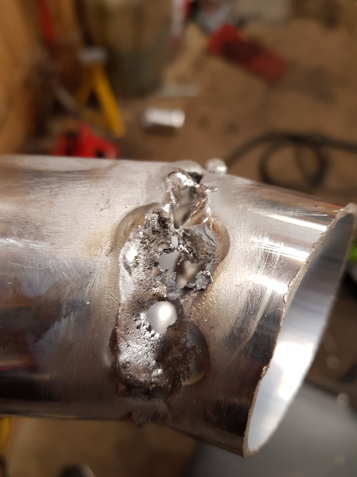

    Just Bought myself a new Rtech acdc 160amp tig welder, the first job I had to do was extend the exhaust leading to the back box on my Integra which was stainless. Started practicing on a spare bit of stainless exhaust and just made a mess to be honest and got me thinking this isn't how it goes down on they YouTube vids I've watched lol. I didn't have a clue where any of the settings on the welder should be so just kept playing away. Eventually got the machine dialled in to where it worked the best for me, got the exhaust done but not to the standard I would've liked so I'll probably do it again once I've practiced a bit more.
    But today's job was just horrible and couldn't seem to find a sweet spot with the welder. I needed to make some intercooler boost pipes for my Integra (2mm alluminium) tried 1.6mm red tungsten and it just kept balling the tip so stuck in a 2.4mm and it was slightly better. My biggest problem was butt joining the pipe, the edges would burn away almost instantly making it impossible to even start a puddle, also most of the time the arc was causing violent splattering and when adding filler it was burning green and splattering. The welds were hideous, all porous and burnt, any ideas where I'm going wrong? I got a full bottle of argon today so there's plenty of gas, waiting on a flow meter coming so I can regulate the gas better. When just laying weld on a piece of metal I seem to get an almost acceptable weld however can't do a joint without the edges burning away. Any help is massively appreciated, even just a starting point with the settings on the welder, and sorry for the massive post 20181008_174853.jpg 20181008_174841.jpg 20181008_174853.jpg 20181008_174841.jpg 20181008_173540.jpg 20181008_152402.jpg 20181008_153404.jpg 20181008_152417.jpg

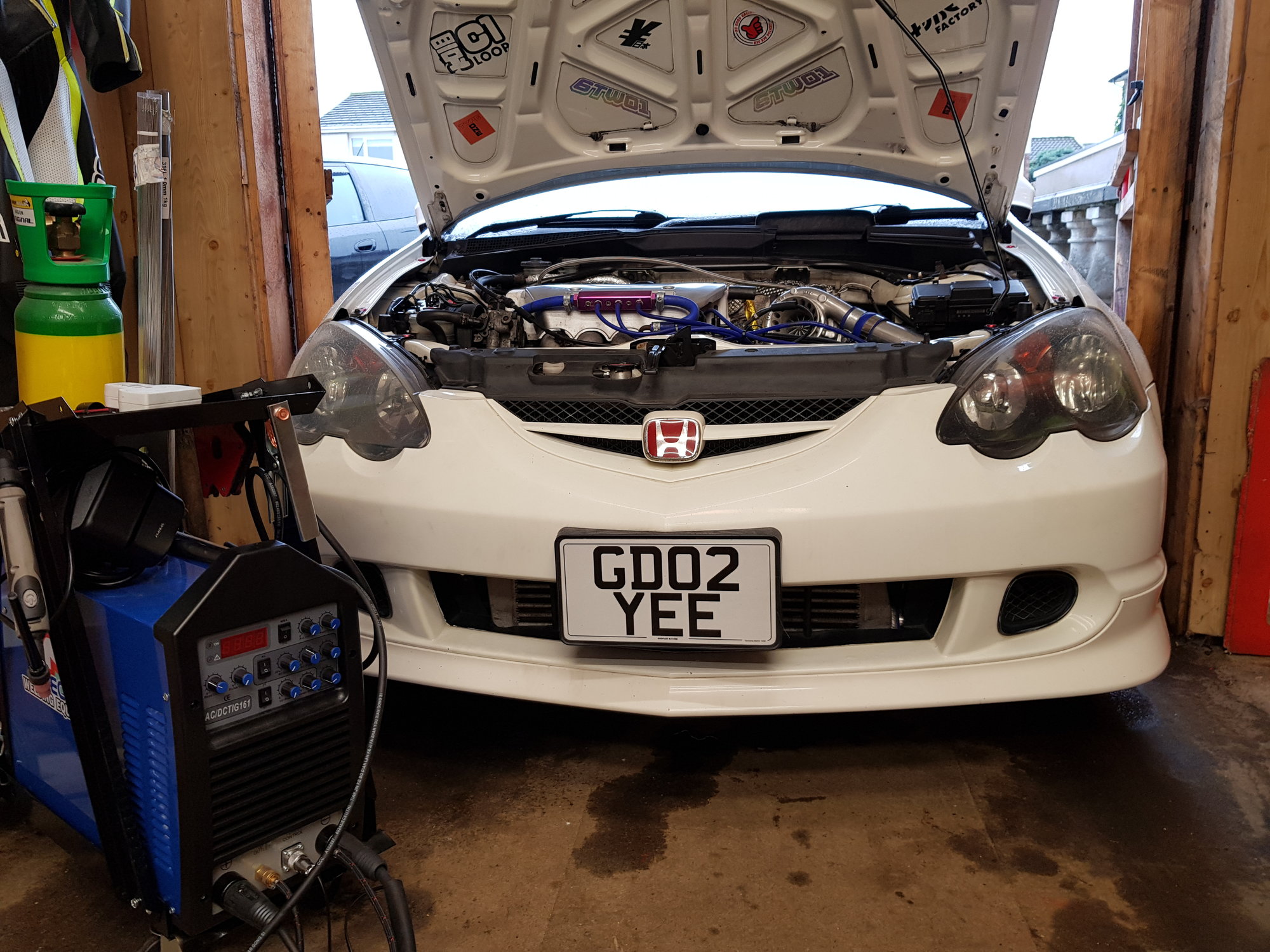

    Never mind the welder, tell us more about the car :thumbup:

    Were you purging the inside of the pipe with gas?

    Red Thoriated ? Get some 2% lanthanated or ceriated, thoriated are DC tungstens.

    No i didnt back purge it, I thought you only needed to back purge stainless?

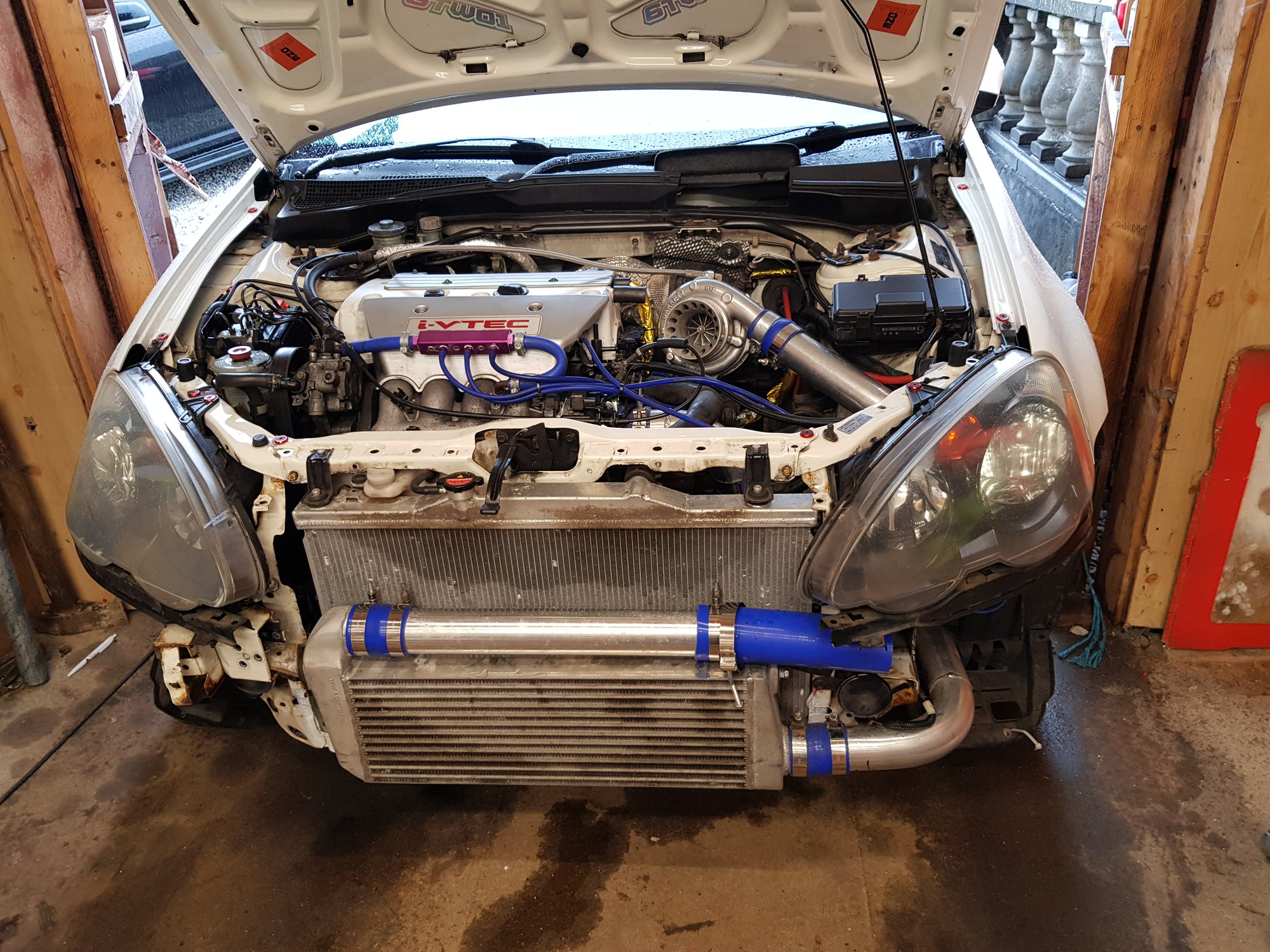

    And the car is a Integra type R that I've stuck a Garrett 3071r turbo on , makes 450hp at 14psi, it's a handful lol

    Also I thought a red tungsten was stable at welding all materials but after having a look online it seems I was wrong. Would it make that much of a difference?

    Your taking on way too much mate.
    You’ve bought a piece of equipment that devotes time, practice and skill. Then without any of those 3 things you’ve taken on a difficult process and tried to apply it to a highly skilled joint. Forgive me here but you stand no chance and if that motor is your pride and joy I’d suggest you stop right there and leave it well alone.
    You can’t just buy a tig set for the first time and get fired straight into aluminium tubular joints. You need to start off with some flat plate of sensible thickness and perfect the basics laying down some runs. Some tuition will move things on quicker. YouTube and forum advice is ok but it can contradict and picking out the good from the bad is tricky when your starting out.
    You don’t need to purge aluminium and ref the tungsten type while reds are not the best choice for ac, changing them out at this stage won’t make a blind bit of difference to your results on tube.
    Follow the guide I wrote, understand it and apply it to beads on plate. All the settings and info you need are in it to get started
    Anything that doesn’t make sense just ask. I’ll be reluctant to help though if you continue to fight with thin aluminium tube. You need to absolutely nail the basics of tig in the easiest position before moving on. I’d start out on dc personally because you get more time to think and it’s less volatile when you make a mistake.

    C4irney, I was in the same boat as you a few months back with my new AC/DC Tig set - getting good beads on mild and stainless flat plate on the bench but trying to weld thin wall intercooler pipe for my Turbo bike project was just a nightmare.
    Can echo the comments above about practice,practice,practice - start on thicker material and it will all come good then work your way down to your intercooler pipework.
    The aluminium tig tutorials put up by Richard are a goldmine of information to someone starting out and along with the help from the forum, you will be getting great results.
    Nice Integra by the way and the Garrett 3071r is a great spooling turbo

    I bought some cheap piping for the front mount Intercooled, reverse intake manifold Impreza, running a GT3076 (it's a great turbo indeed btw) and the piping was absolutely terrible to weld.I first checked all the machine settings, checked the gas, checked everything, and after giving the piping to a mate of mine who does aluminium welding as a job (mine is just hobby stuff, I am not a welder perse, just a mechanic who can weld)
    it turned out to be the piping itself. It wasn't anodised ,it was cleaned with acetone etcetera, but after striking an arc a whole lot of soot came into the puddle (with a big gas lens,cleaning set way up, without even adding filler)
    Bought some different piping and though my welds where nowhere near show quality it in an instance looked much better. (with the same settings/etc)

    Stainless is more about getting weld power in and getting out again without toasting the material. The heat stays close to the weld as a poor conductor of heat. A by product of this is it often buckles it. Back purge is a good idea.
