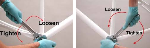

See how you go first before you start worrying. Just make sure the spanner is fully engaged and square so you don't knacker the BB. Also make sure you are going the correct way. Now I hope I have remembered this correctly, left hand thread on the chain side and right hand on the other. Take chain side off first, by turning clockwise.
