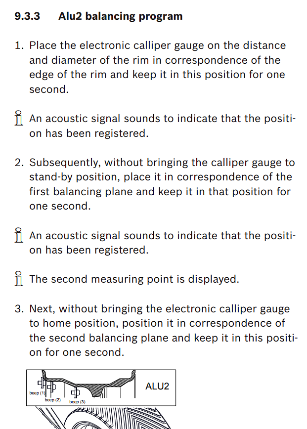

I have this issue with the Bosch balancer though and am not confident it's right. It might be that I'm using it wrong, although I think I'm doing it right.
The issue I have is that it tells me to put 30g on the inside. I do that, then spin it up again, and it tells me to put 20g about 30 degrees anti-clockwise to the 30g that I just put on. Then I spin it up, and it tells me to put 15g about 30-degrees anti-clockwise to that too.
Isn't the idea that it gets it right first time? I did my mum's wheel today and after about 3 or 4 lots of loading up weights, it says it's balanced.
Any tips? I haven't attempted a calibration. I suppose I should at least calibrate the spindle. I don't really have a known-good test wheel.
