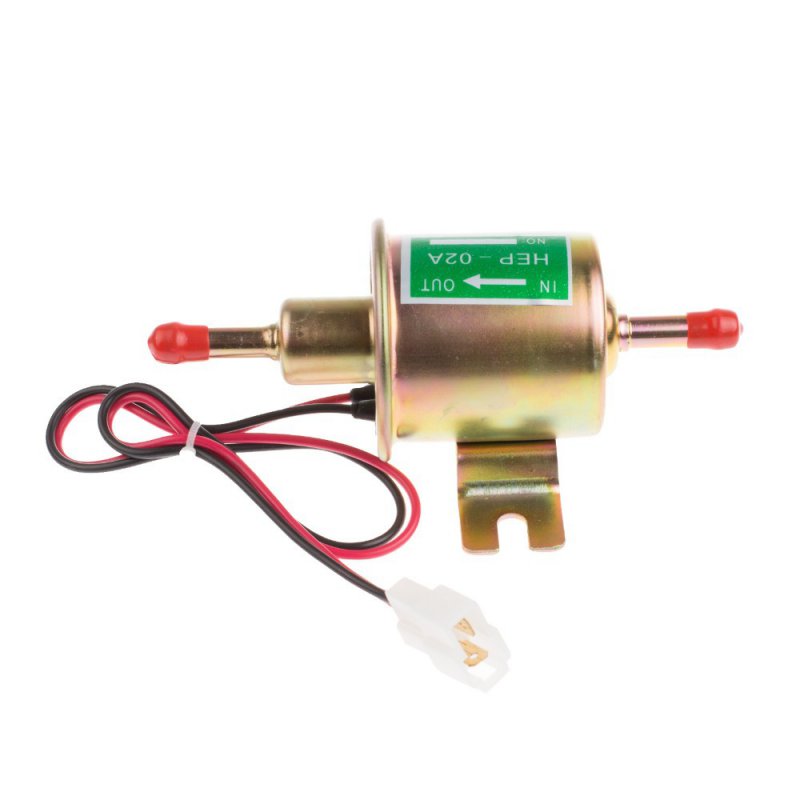

You could use an injection pump and use a filter king which is as said a filter but has a built in fuel pressure reg http://www.dellorto.co.uk/wp-content/uploads/2015/05/Filter-King-Instructions.pdf that could be belt and braces to regulate the flow because you would still need a fuel rail reg in the line to return fuel to tank. IMO a injection pump is way over the top flow wise and will just waste power if you have a limited charging system or as some dont have a charging system.
facet red tops usually go to 7psi but I think you can get stronger springs but one of these would do I think http://www.ebay.co.uk/itm/Facet-Posi-Flow-Electric-Petrol-Fuel-pump-Race-Kit-Car-10psi-34g-hr-60107-/290953265440
But still use a filter king.
