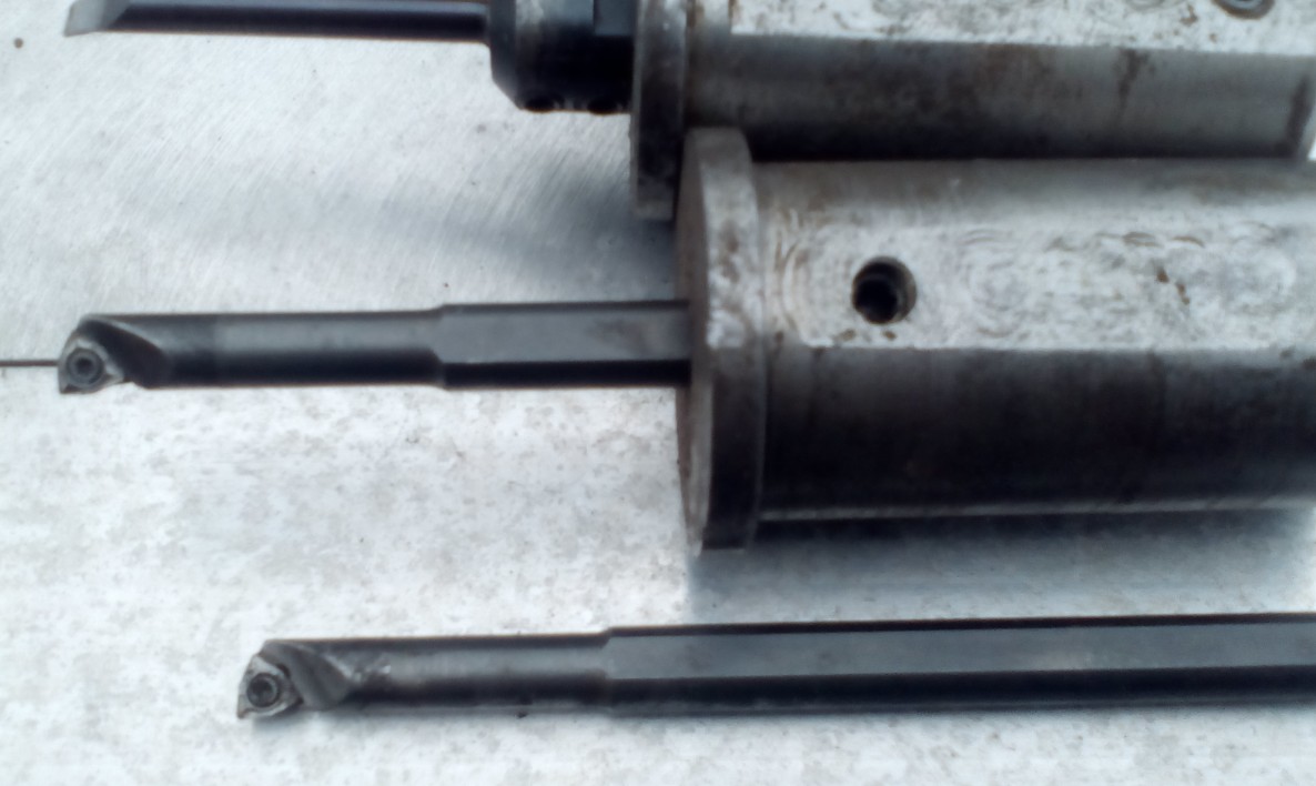

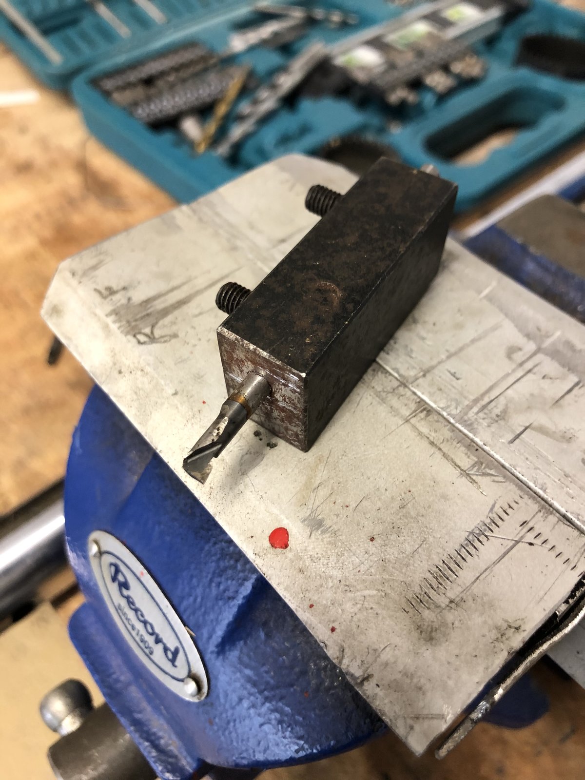

Does carbide weld?
Dunno about welding but it does braze very well, but I suspect you already knew that
Does carbide weld?
use hss tools all the time unless its something hardJust to cause upset hss anyone?
Why not use a 5mm bar and get rid of a load of chatter?Made a quick video to show how good these are. This is a 2.5mm head, 2mm shaft mini bar cutting silver steel 0.4mm doc. And very blurry, but you can see the swarf. Final hole in video 10.2mm, couple more cuts I cant be bothered to swap tool. It will be 11.95mm.
I never had the speakers on until you said that, could be the lathe, certainly don't get that flex when I use them, then again I tend to stick to 0.5mm on dia with the wee bars.Why not use a 5mm bar and get rid of a load of chatter?
Does carbide weld?
