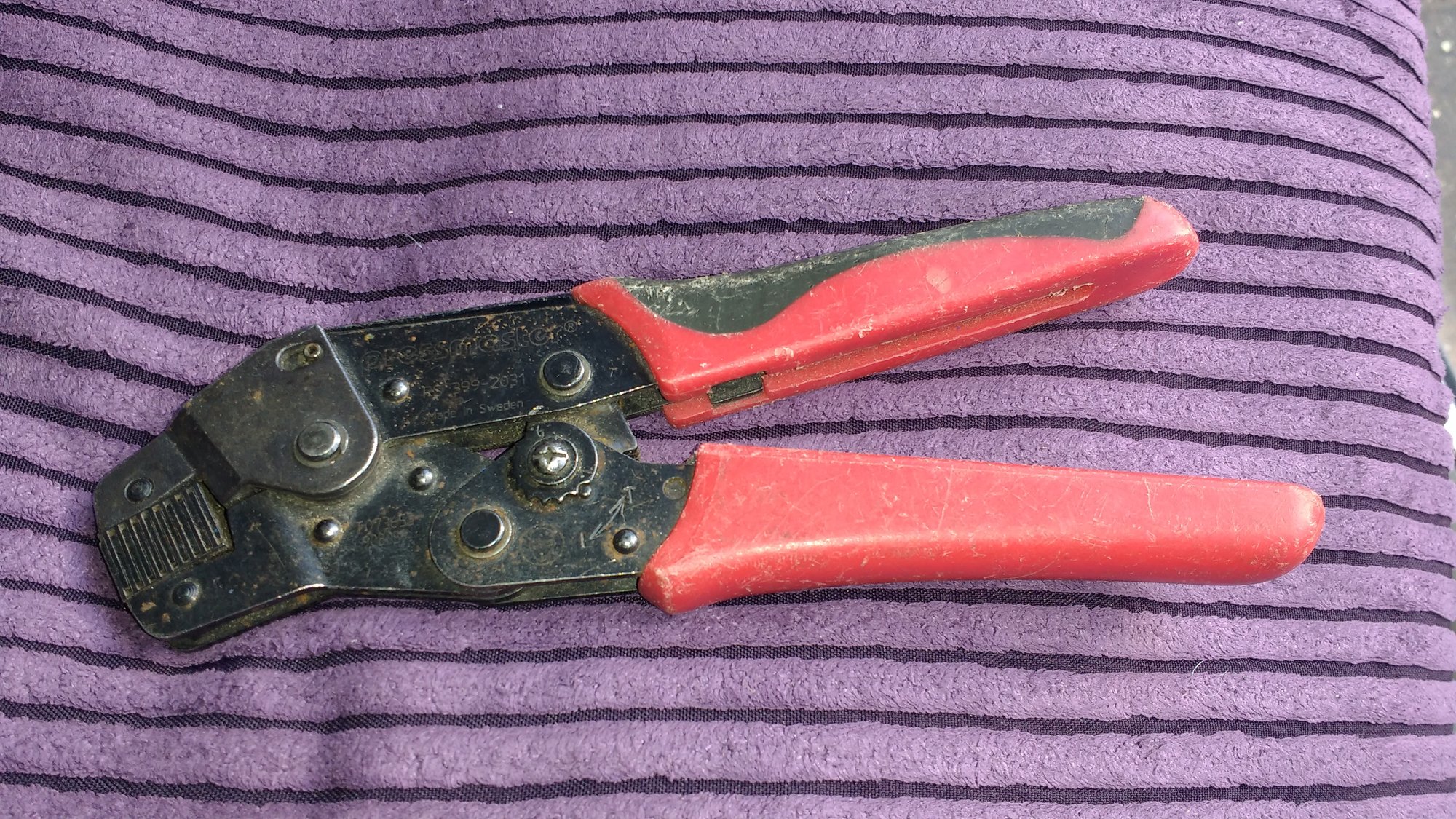

Very little thinking, but then I've used a simple pump pliers, end on. Gives a nice 6 or 7 pressure points. Once the terminal screw is down on the ferrule it's not going anywhere is it? Re an earlier post, the point of these is to prevent that screw cutting the multistrand conductor.why?, crimp on, press and release, how much thinking do you need for that.......
compared to what?

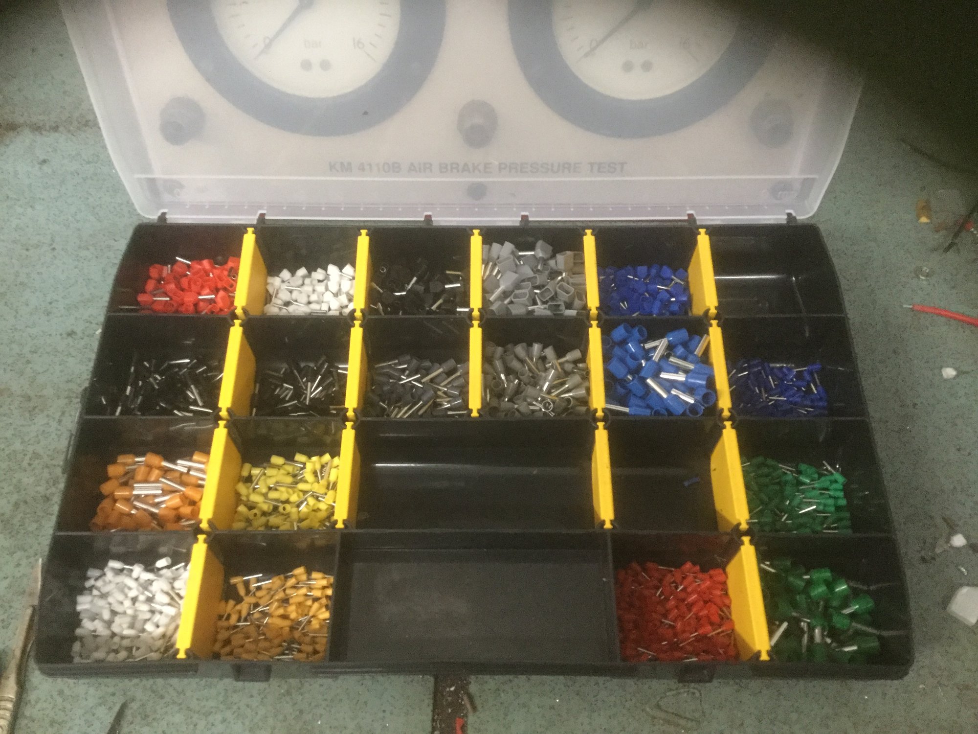

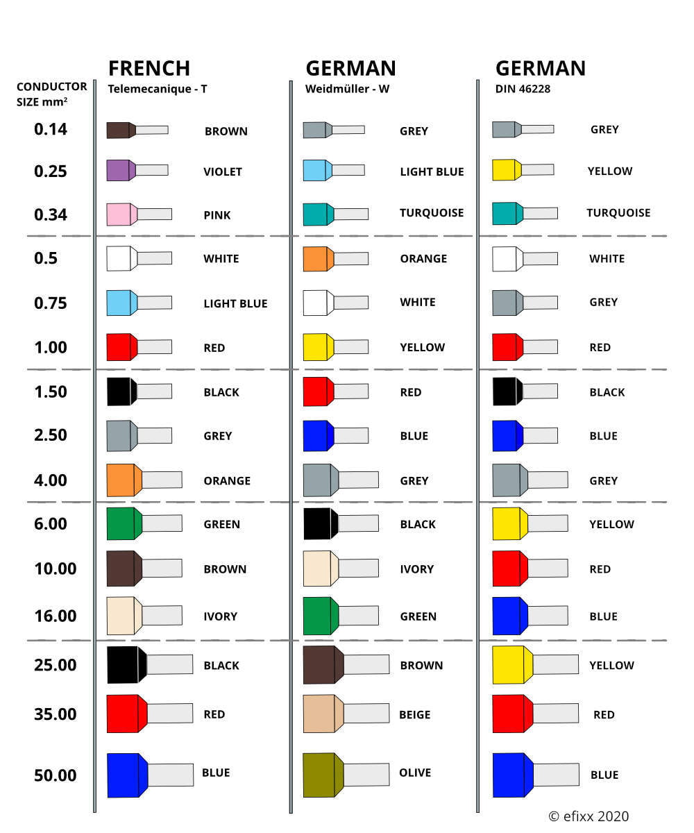

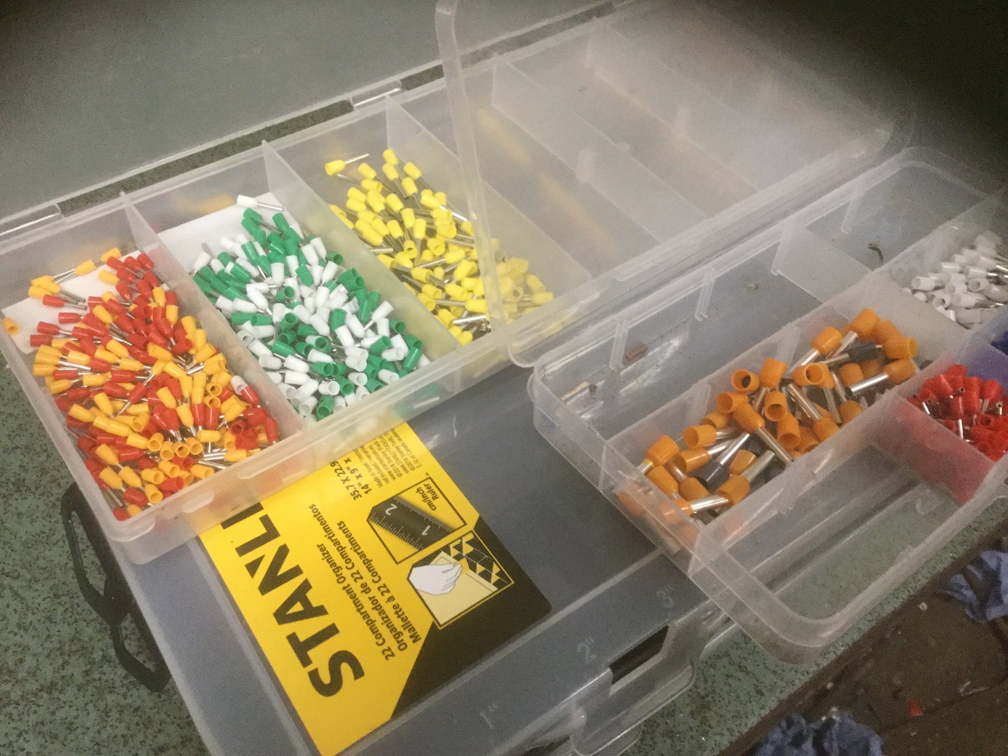

Bootlace ferrules are the plain round type, either with or without insulated ends - not the ones with different shaped shaped ends.
Sorry I don’t understand? They are indeed available in a range of sizes with different coloursYes, I know - but I thought that they would all be available in range of sizes, and with the same sorts of plastic covering - both in colour and type of plastic.
Obviously not...
Sorry I don’t understand? They are indeed available in a range of sizes with different colours![]()
