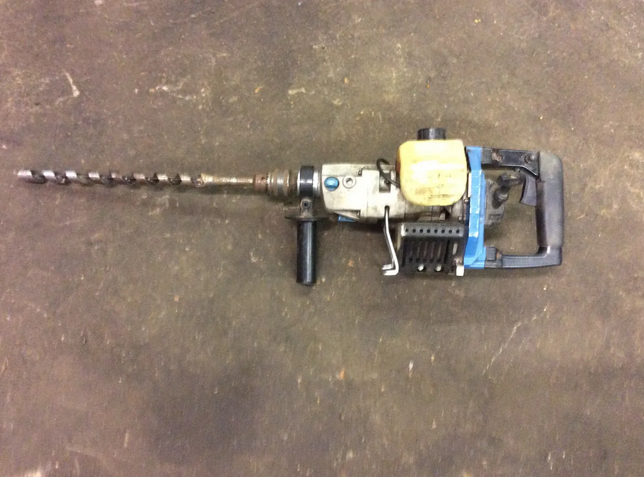

Having done exactly this a long auger will work as suggested (with any long spade bit the shaft will wander). If you know of a local company doing oak framing I'd be tempted to pop in and ask nicely if they'll blow a few holes in it with a chain morticer.
