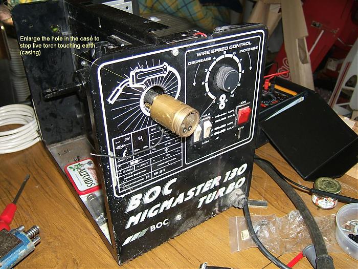

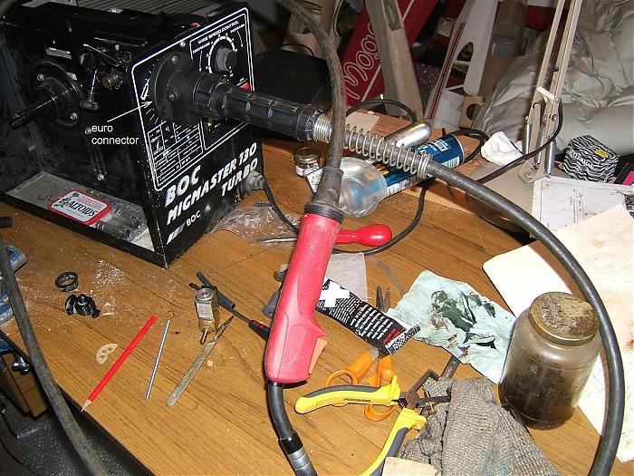

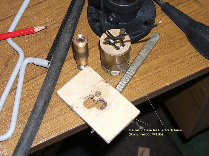

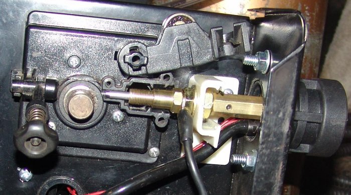

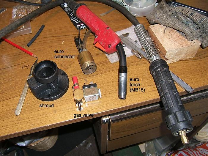

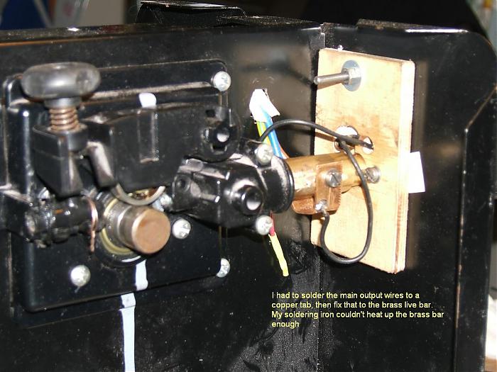

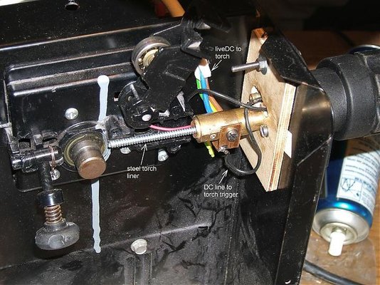

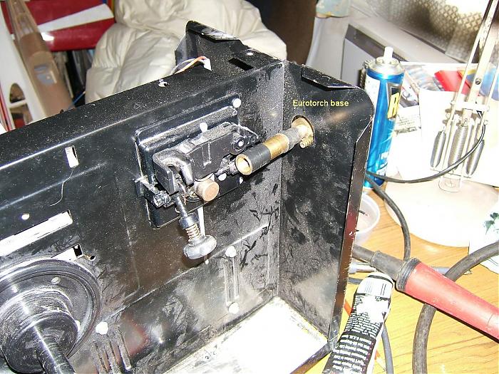

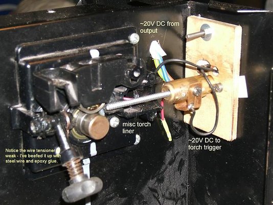

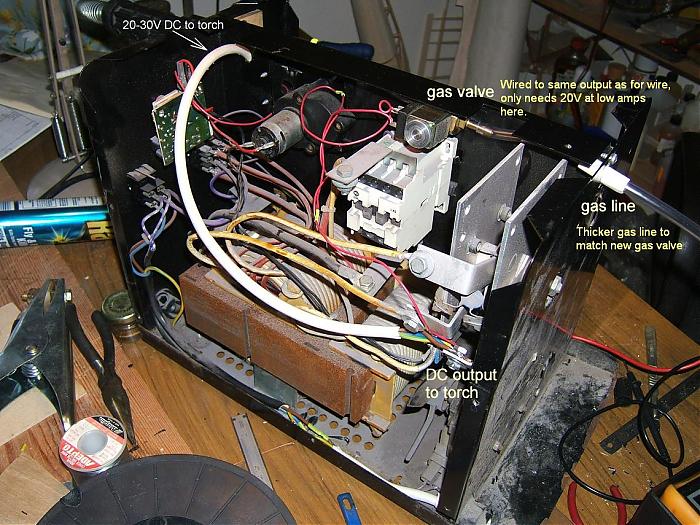

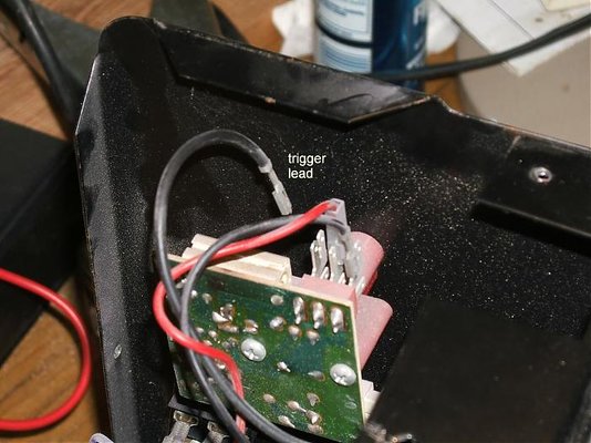

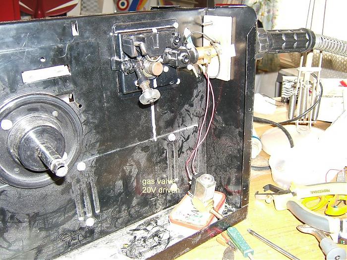

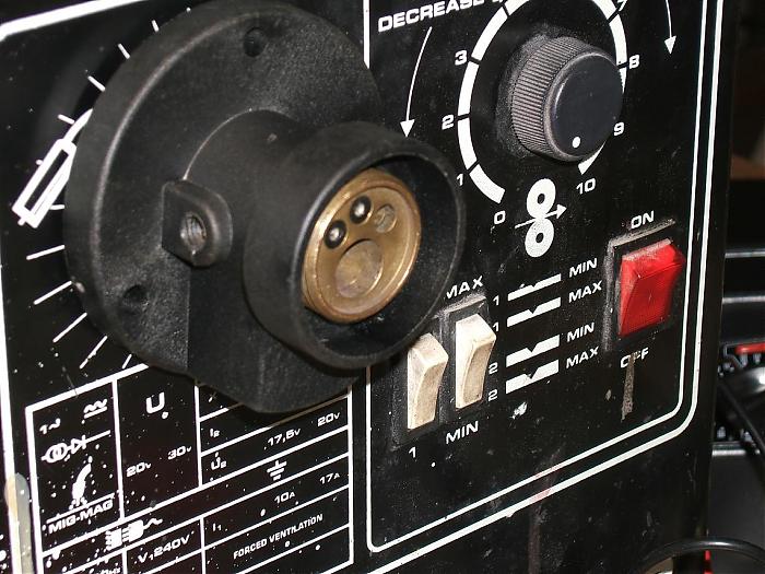

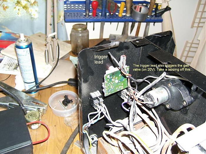

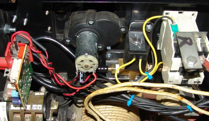

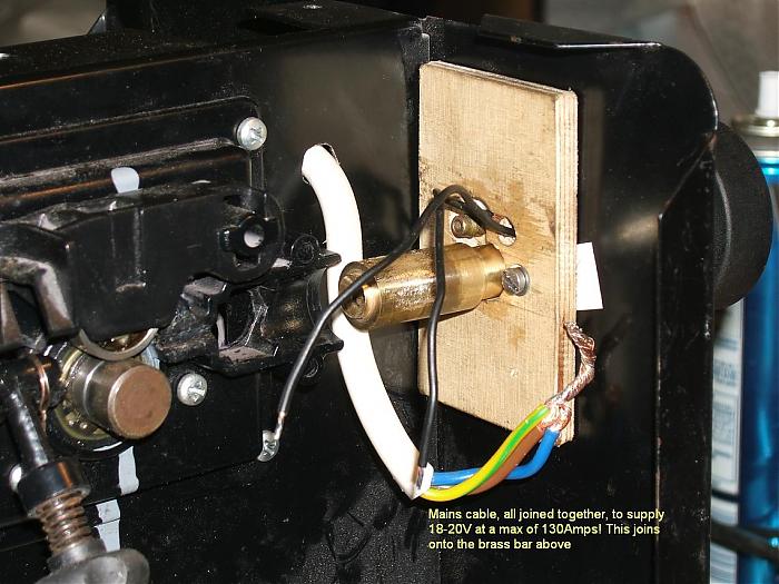

Details of build, as requested
Hi
Thanks to a few requests on the details of this conversion, I shall post them here as the picture files can clog up your in-tray.
I've annotated them though to help you along.
If you need great value parts, speak to Pete or Carl of Techweld, Gravesend, 01474 326403.
Be very careful working with the machine live - you need to trace the live wires, but don't zap yourself!
Good luck
