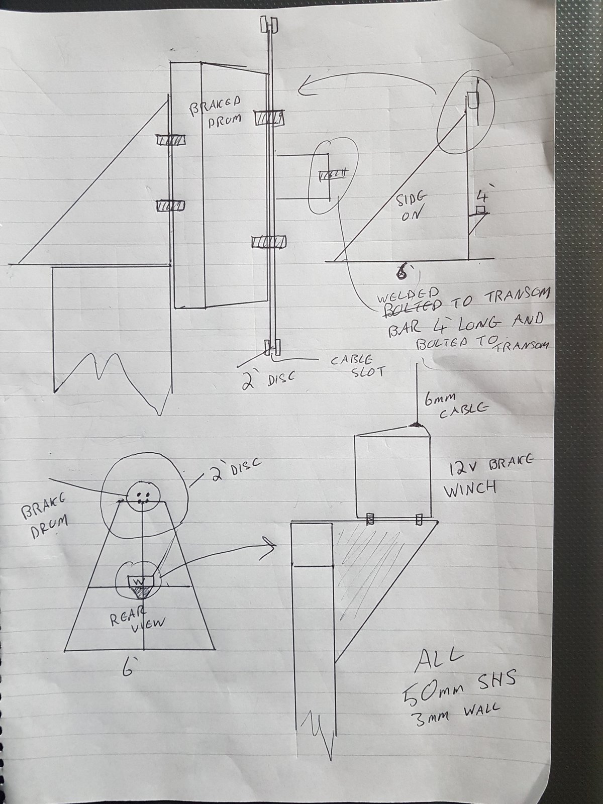

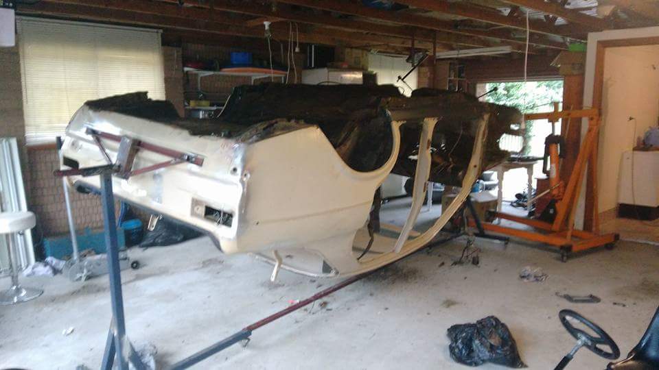

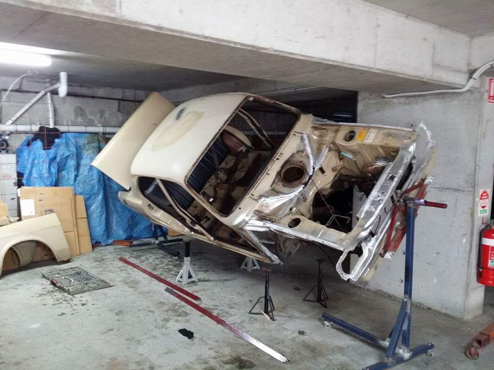

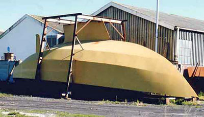

Sorry to divebomb the thread but do you have any more details on that jig Coo? I've the same job to do as the OP and that ^^^^ looks promising.Rather than have the danger of holding the load whilst rotating...

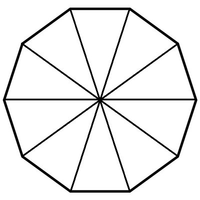

What about a 12 sided round rotisserie:
I will be massive though, but safer in my mind...
Awesome, cheers Coo - couldn't find it myself

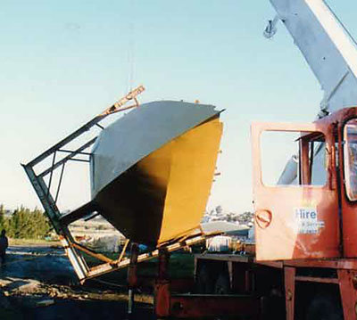

the hexagonal wheels seems a nicer way that a rotisserie as with a rotisserie you have to get the centre of gravity right or else the thing will be a ball ache to rotate.
A cruiser is not the same as a yacht, a cruiser will have removable ballast and the engine, if it's inboard, will also contribute to the ballast. This means the COG will be pretty near the waterline when it's empty.
In a yacht, especially a fin or bilge keel boat which has non removable ballast, the COG will be a good distance below the waterline.
It needs to be as the center of gravity and the center of bouancy/ floatation need to be a fair distance apart, with a yacht this give quite a high righting angle in a knock down, 165 degree ish if its a good one. On a cruiser like this youd be lucky if the righting angle is 100 degrees. Any flooding and the free surface effect would roll it.A cruiser is not the same as a yacht, a cruiser will have removable ballast and the engine, if it's inboard, will also contribute to the ballast. This means the COG will be pretty near the waterline when it's empty.
Could you not just sand blast the bottom seal with a good expoxy coating like you would with a hull plauged by osmosis ( though yours is dry suspect by the look of the bottom its suffered this fate too) fill the big dents chunks etc and reinforce with mat on the inside. Be a lot easier, you can apply the epoxy with a roller, 3 good coats rather than 1.
