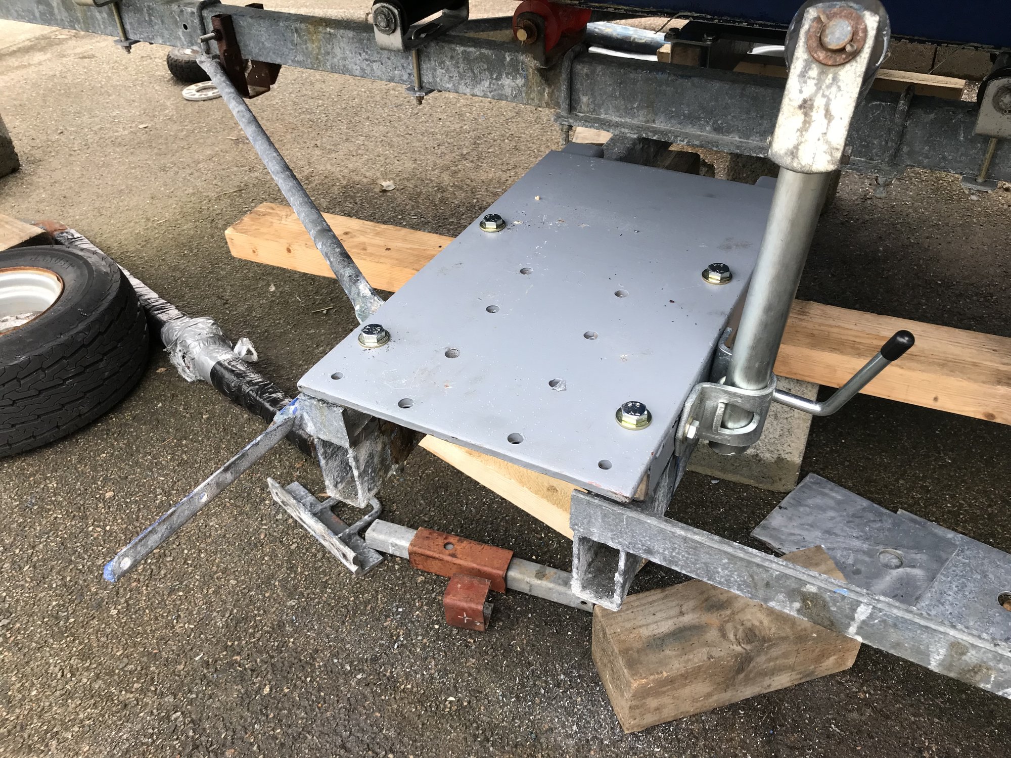

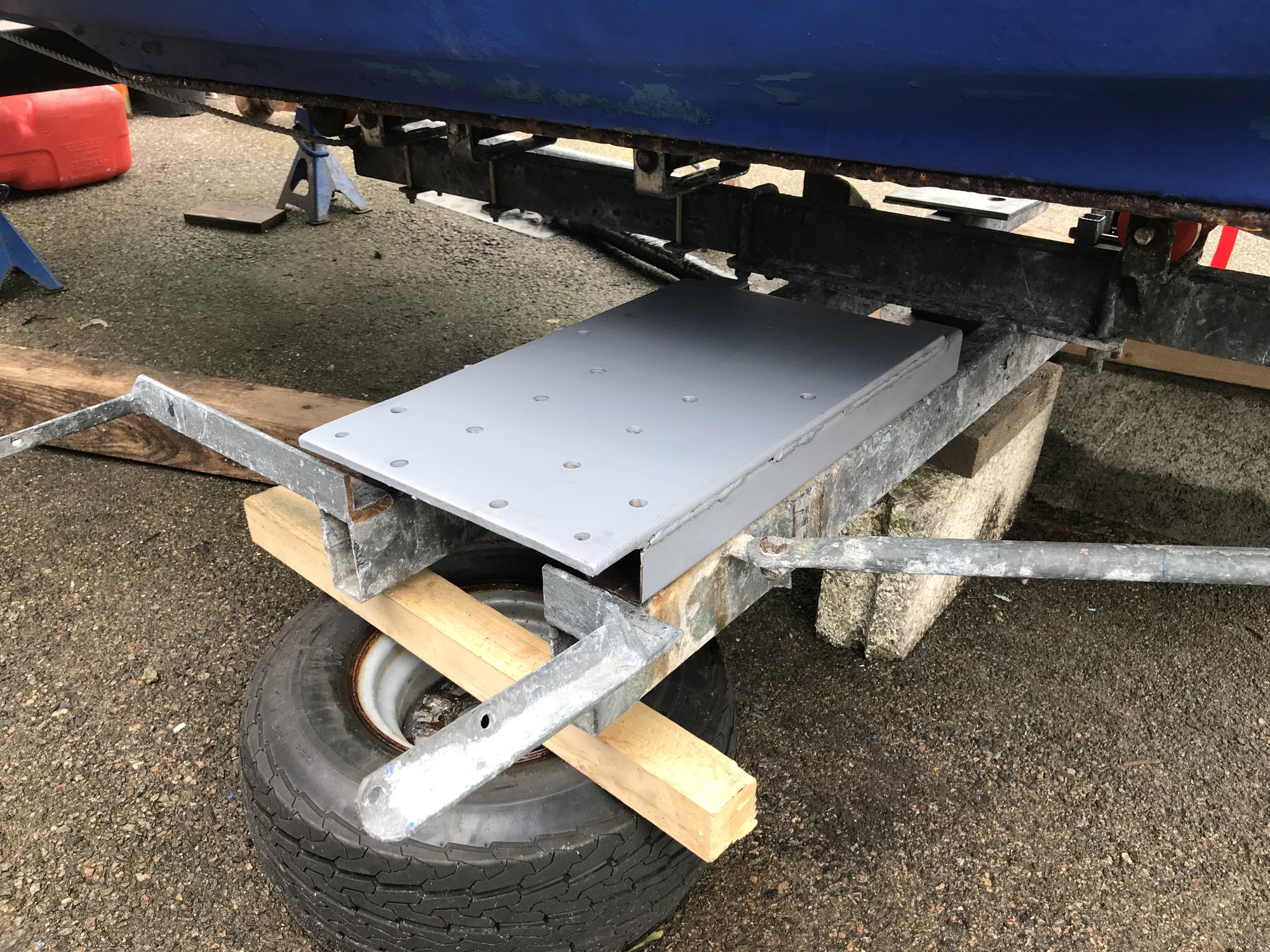

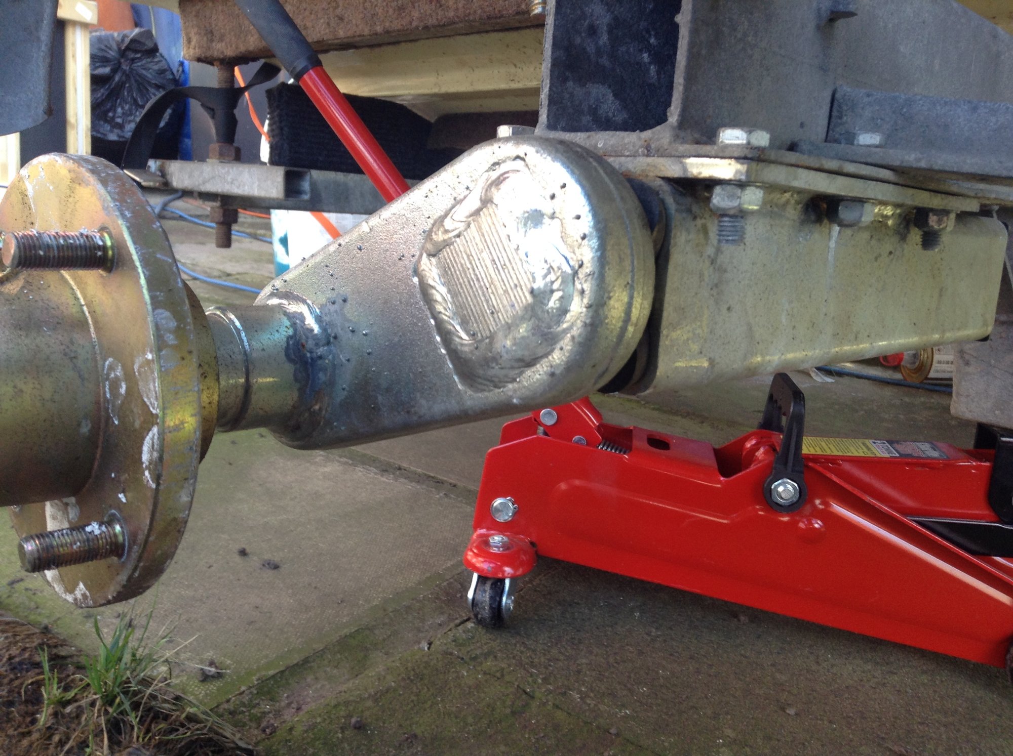

Yes there is a 6mm plate welded to the trailer chassis where the suspension goes with 6 10mm bolt holes in it for the indespention units to bolt to and if you ever need to change the units you just un bolt them from the plate that you welded to the trailer I'll put some pictures up tomorrow of mine for you one more thing my boat and trailer are 41 years old so the way it's done must be good the only thing I had to do was change the suspension units for pice of mind iAd I would recommend you Change your trailer from rollers to bunks so much easier to launch and recover than rollersCheers jig! 6mm it is, do you have a plate as well?

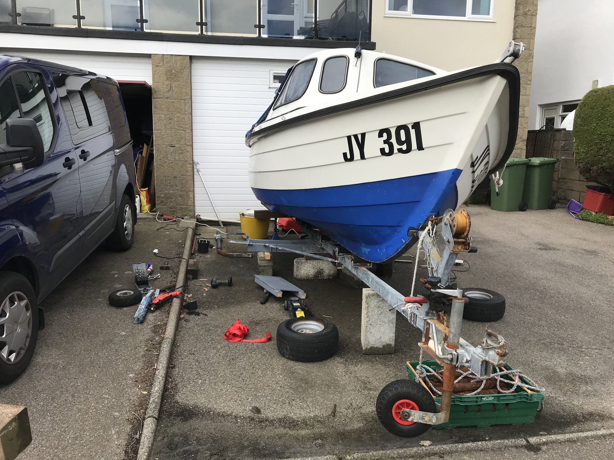

All in about 400 kgSome pictures would be great, how heavy a your boat??

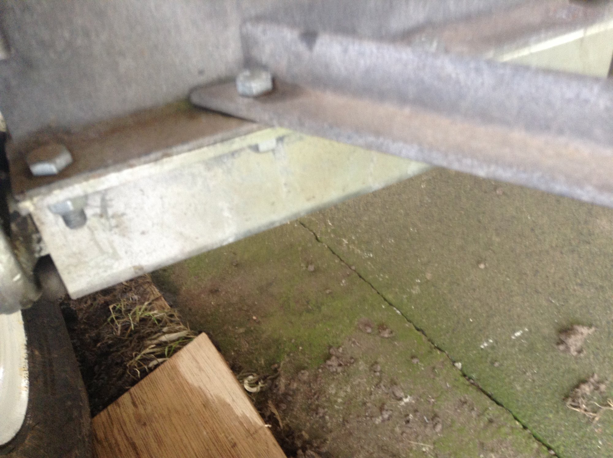

I'm of to do that nowBrilliant mate, exactly how I’m thinking, if there is any chance you could take a photo of one side that would be great.

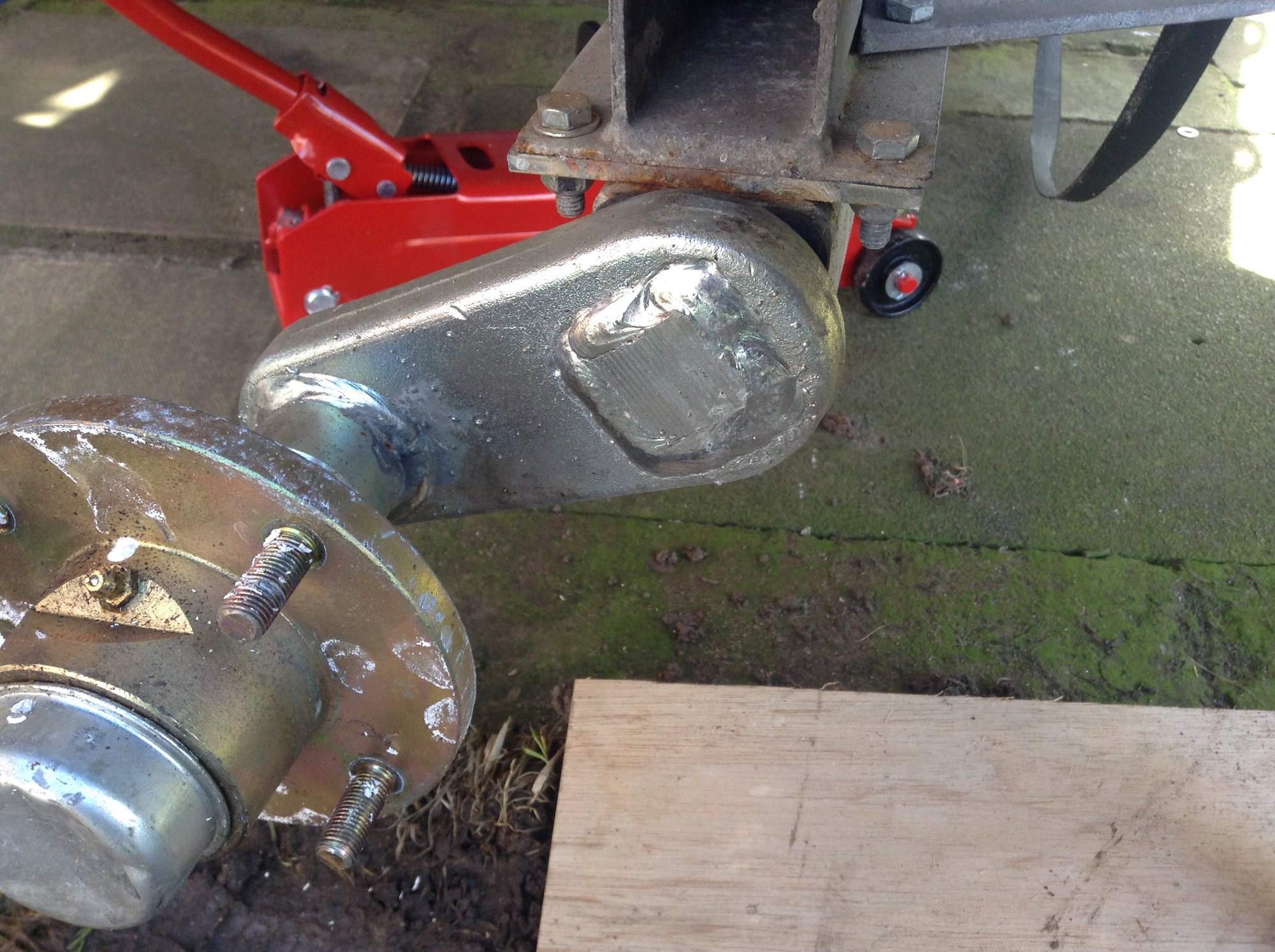

Here you go if you want any more or some better ones just sayBrilliant mate, exactly how I’m thinking, if there is any chance you could take a photo of one side that would be great.

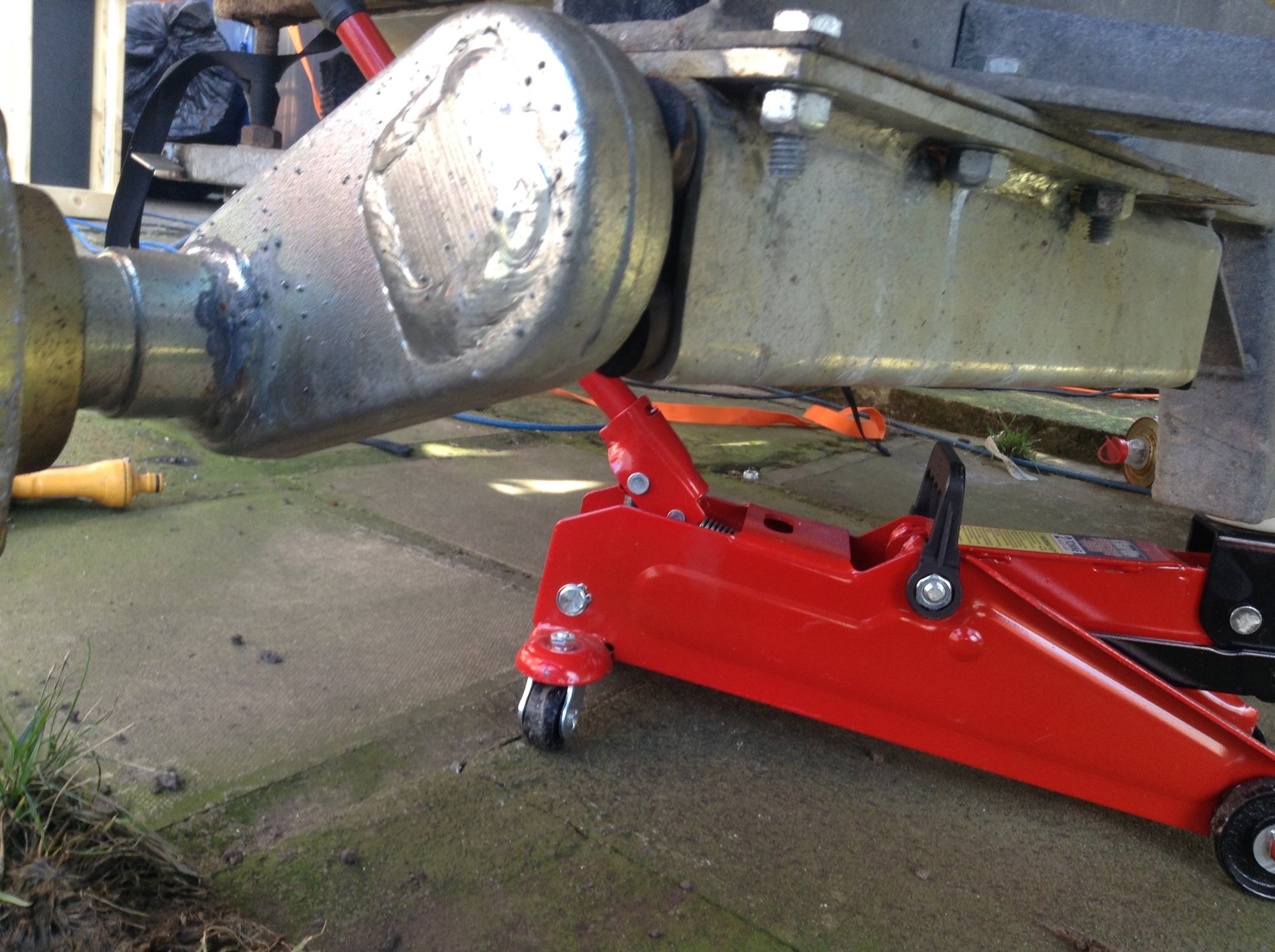

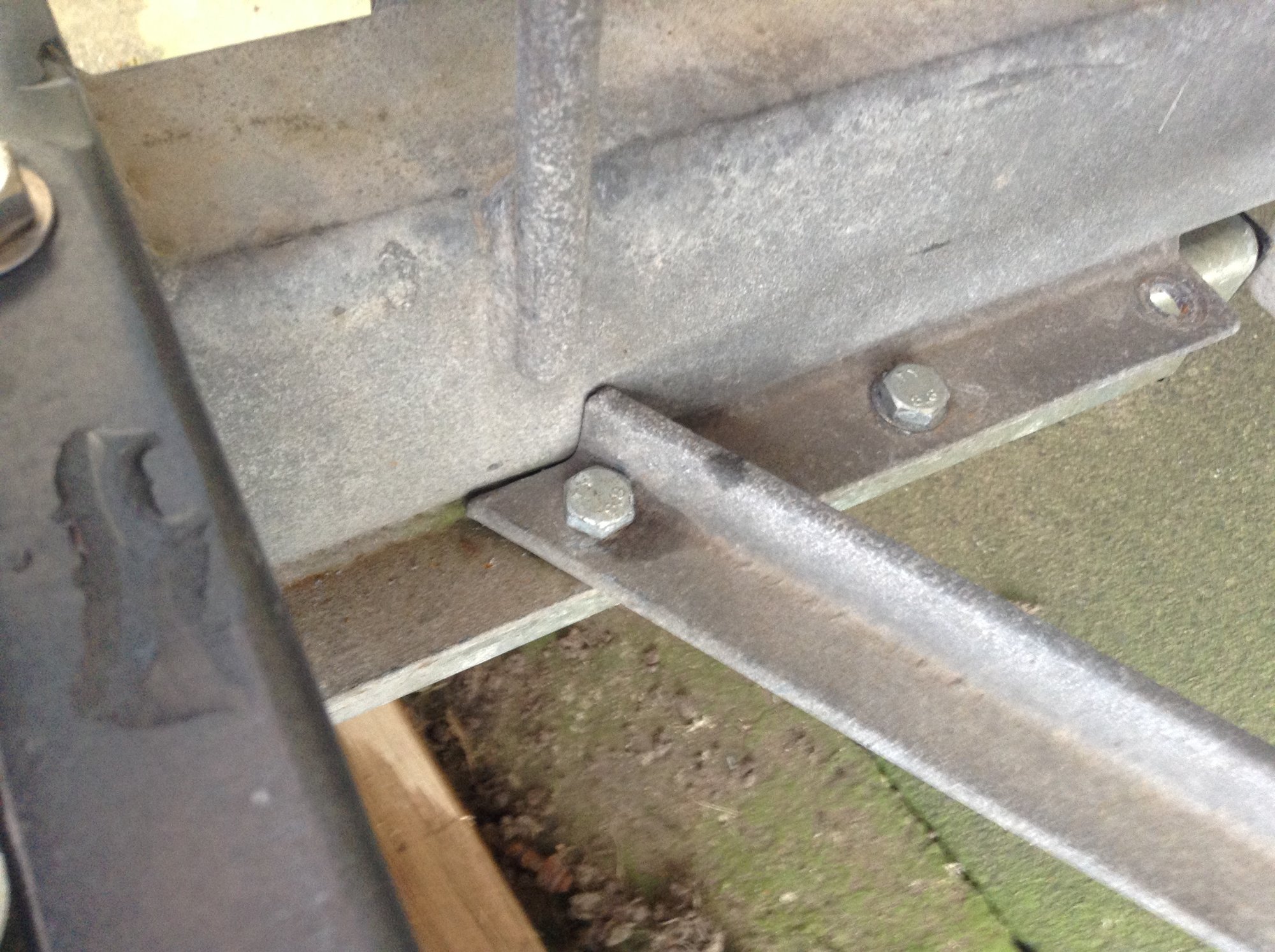

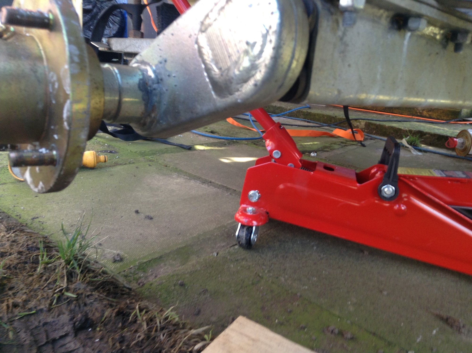

The bit underneath is the suspension unit that's how came from the factory 40 years ago and I would borrow a welder if you could otherwise the only thing I can think of is to preheat the metal but you'd be better borrowing a bigger welder I'll put some more pics up for youJig that’s great, slightly different how I’m thinking because you have your big box section underneath, still think 6mm will be enough??

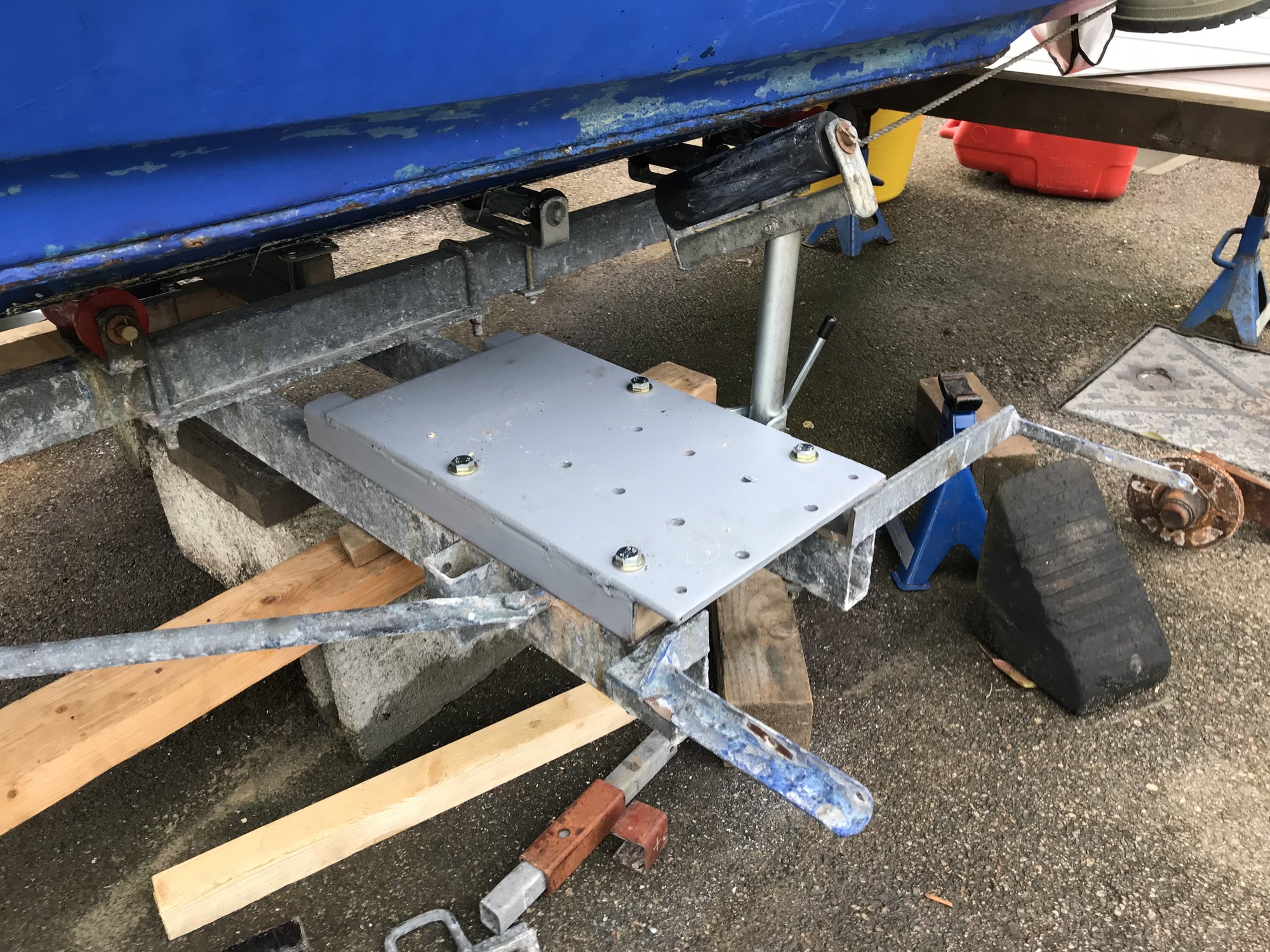

Also while your on this, if I’m welding thick 6mm plate to some 3mm box section, my welder only really works at 150max amps so I’m wondering if this is still enough as I will penetrate the 3 mill but not the 6mm if you get me.... sorry for the late reply been working! I have w mates welder I can borrow but would like to use mine obvs... (it’s a Clarke 151 en hobby welder)
Ok when you bolt it make sure you use the nuts that are squashed on one end I don't know the proper name but there better than nylock nutsJig thank you, I think I’m literally going to go with bolting the metal plate to the box section rather than weld, puts strain on the bolts but my engineering friend has given me 10mm plate for the same
Price as 6mm as he can’t be arsed getting the 6mm cut
