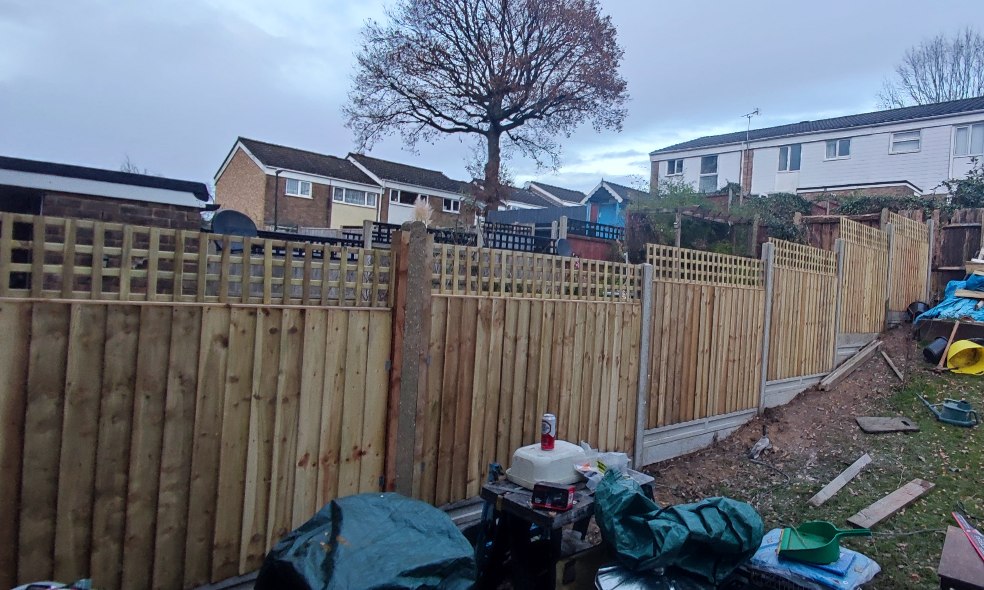

Thanks and smart looking fende thereFor the slope, use 6" gravel boards. Any timber at ground level will rot. They are generally much cheaper than 12" and on a steep gradient you can cut them to save digging. Where its steepest I have 18" of board. As they have tapered edge top and bottom, turn them around and they fit nicely.
