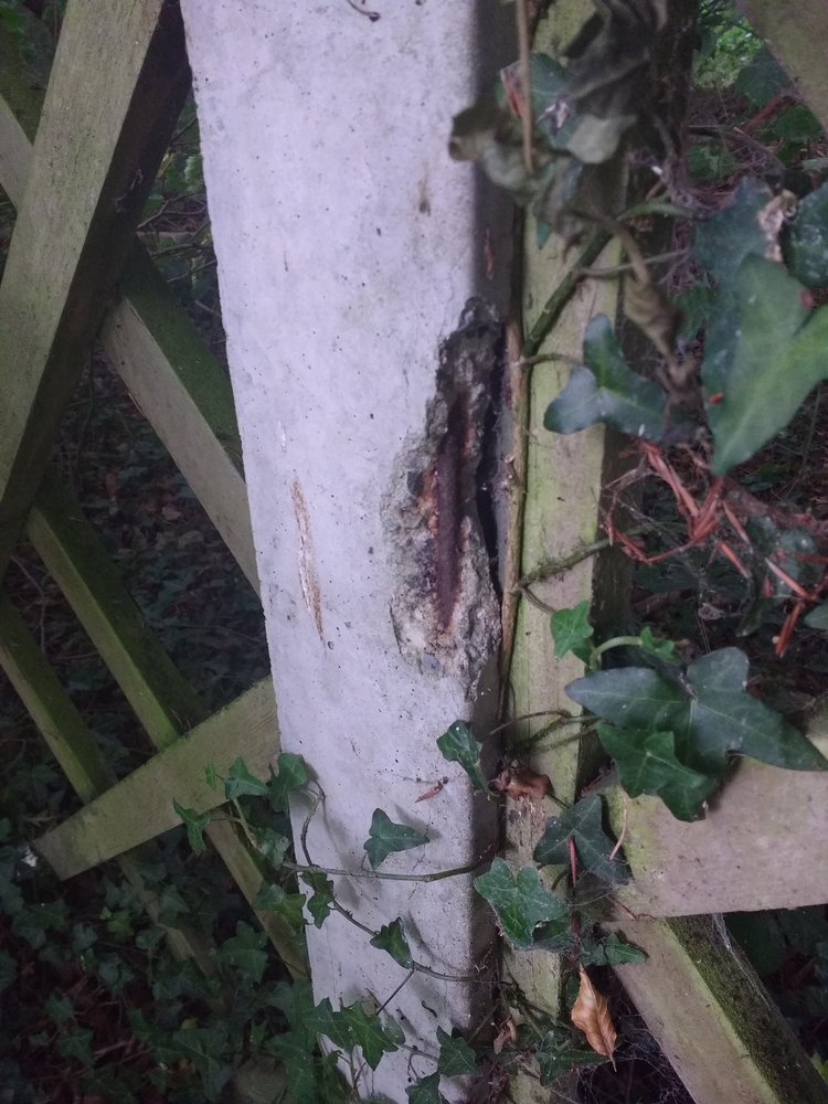

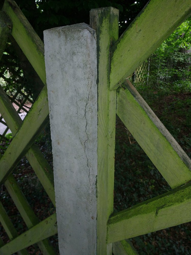

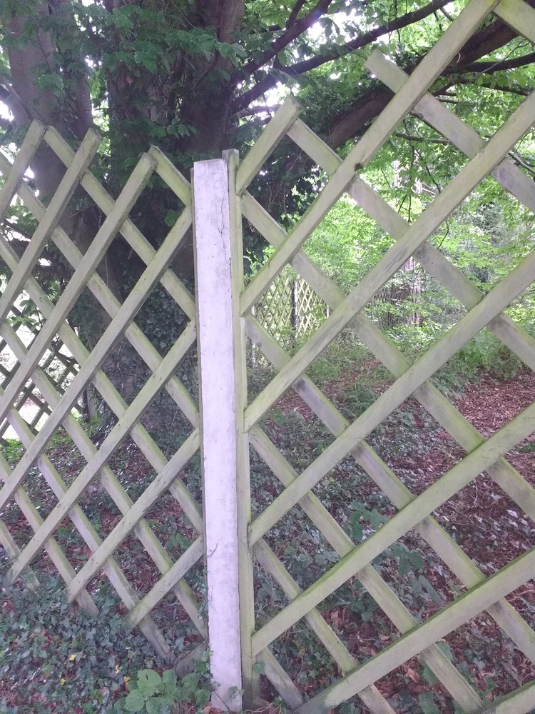

This is another one just taken. The overlapping, 2'x1's, are in there tight. I imagine during the winter they would swell considerably. Expansion is looking a possible cause then.
Tbh if there's no reinforcing in the nib then I'm half considering re-shaping the timber to allow for expansion with a shoulder or chamfer and sticking the loose concrete bits back on with CT1, Gorilla Glue etc.
