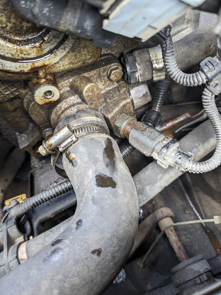

This is an odd one I've had on my son's newly bought 2012 Fiat 500.
It's also in the "Mini or Fiat 500" thread but I thought it would be of some interest in general to some of you.
Once warm there's a quite loud whining noise coming from the oil pump area, YouTube link.
Now this car had not been serviced for a very long time by the look of it so I thought it was the pump that's knackered!
But I did an oil and filter change anyway not holding out much hope but it seems to have fixed it!
A pretty amazing difference I thought!
I'm not sure on this but my theory is that the filter must have been blocked causing the bypass valve to operate thus making the noise?
What does the forum hive mind think?
three or four electrical connectors have to be removed to reach the stat so I checked these and all seems well.
