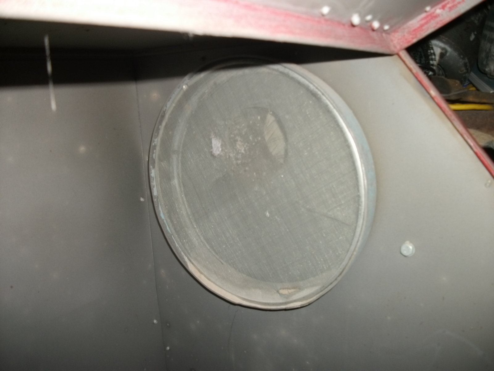

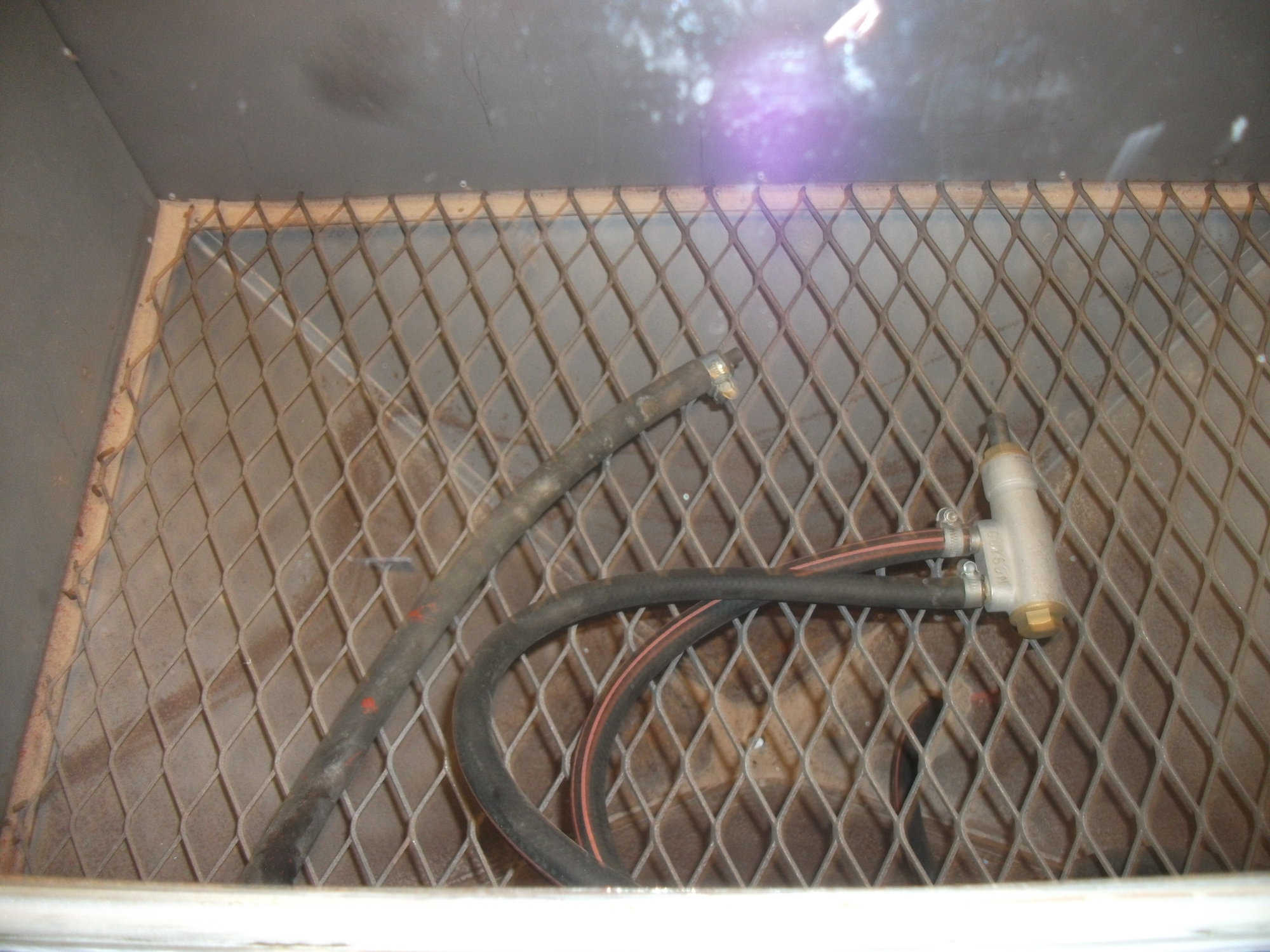

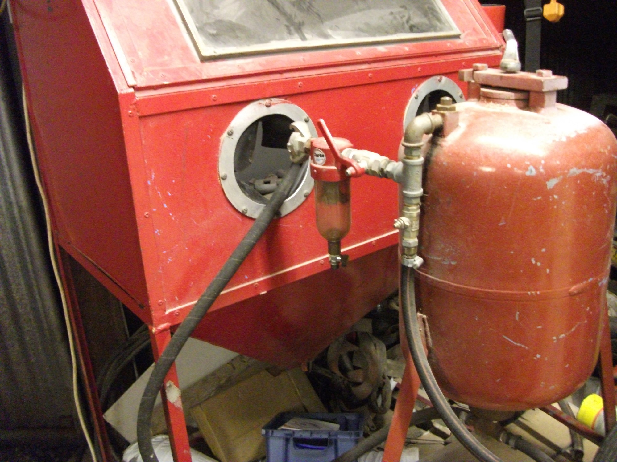

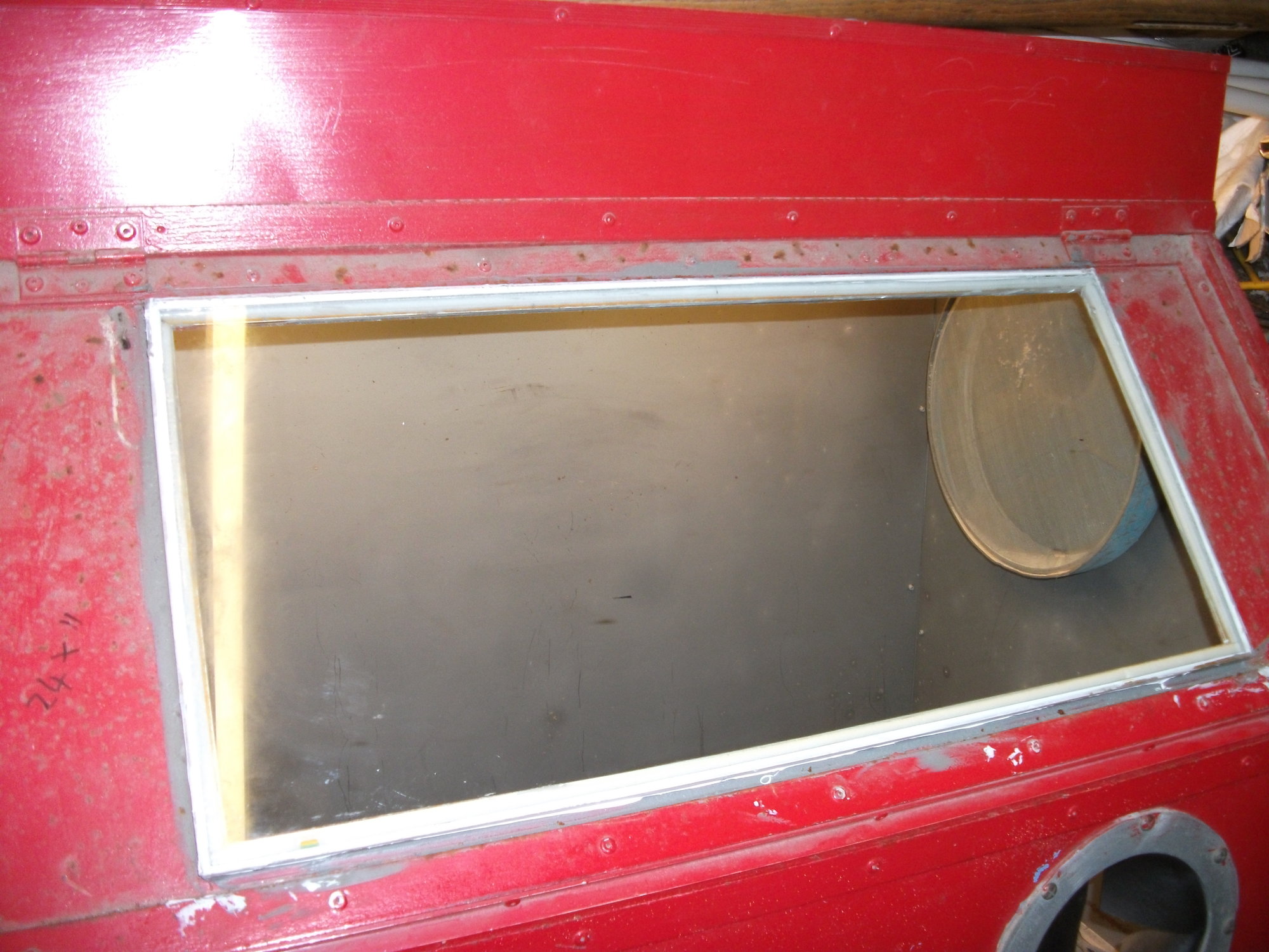

sandblasted some gear last week in cabinet and it seemed a disaster . couldn't see the job because of all the sand flying all over . even though it has the 4inch woodchip extracta on it had a manifold to clean for a mate today same thing then i realised i cleaned the cabinet out put the metal grid back in and forgot to put the rubber mat back in that covers most of the base apart from a bit round the edges . sand everywhere being blown up . mat back in and its working perfectly no dust or sand at all apart from the blast nozzle
