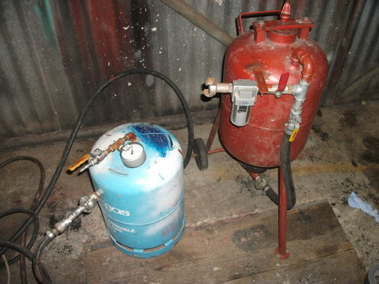

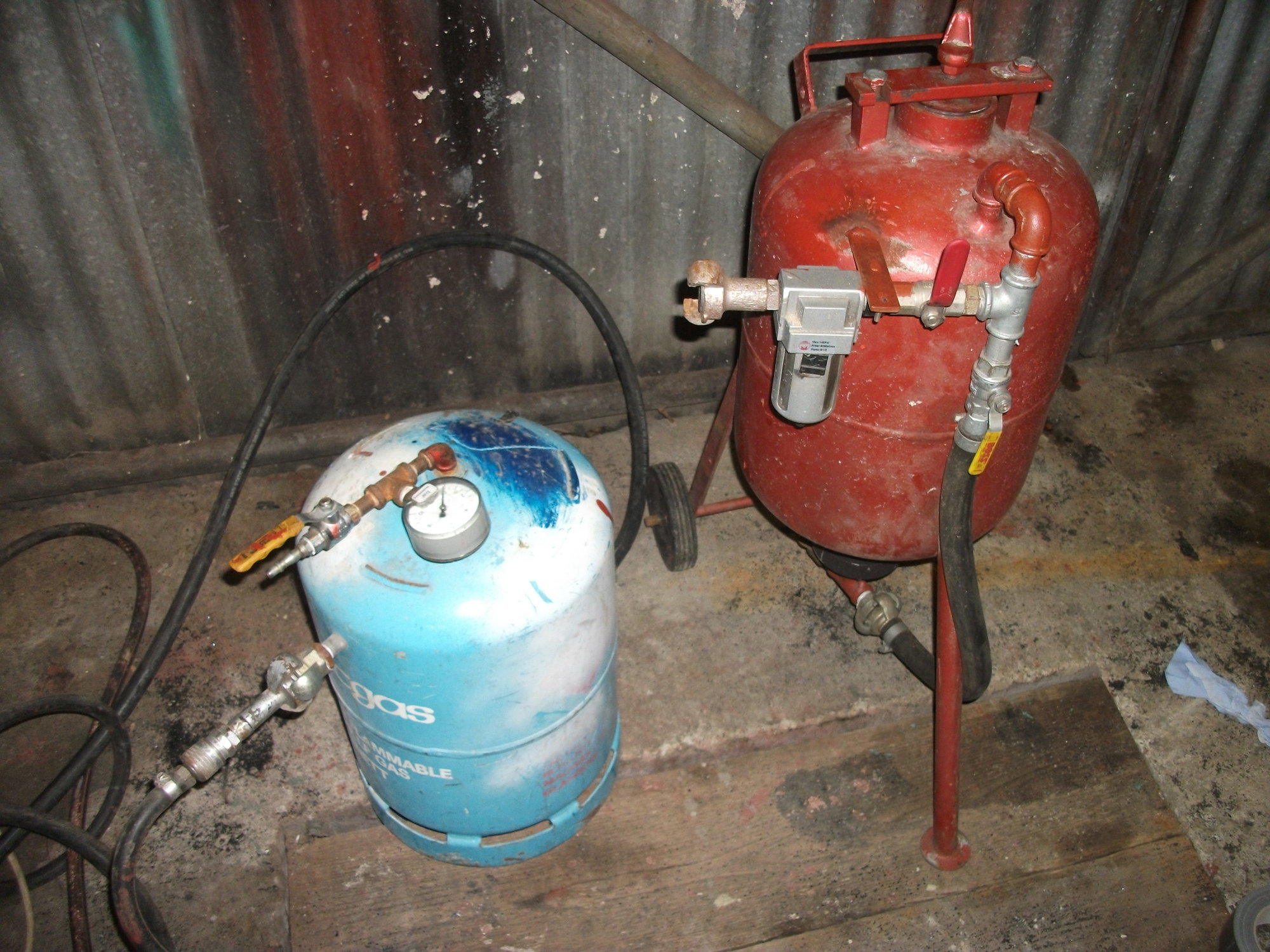

Mine is an ebay clone at half the price, I've changed the grit valve pipework for bigger sizes and put a tungsten nozzle on it. Works great with 2x 3hp belt drive compressors but I need to cool the air to stop condensation carry over when blasting for a while.
Grit currently costs between £4 - £5 for 25kg bags depending if its crushed glass or copper slag.
