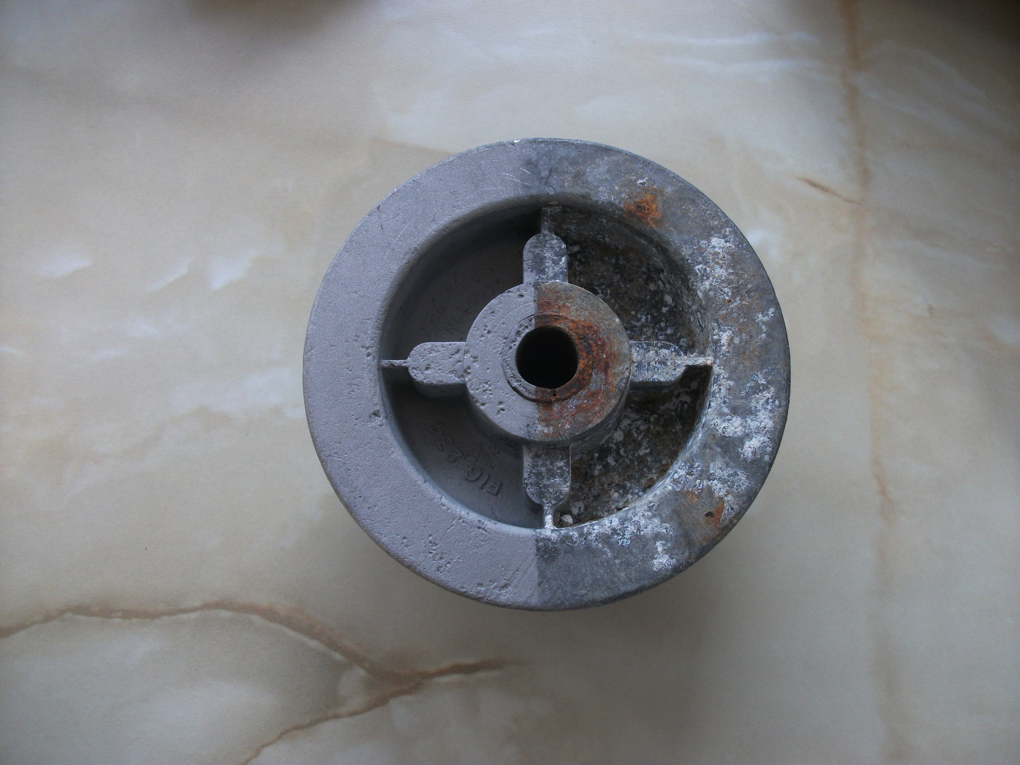

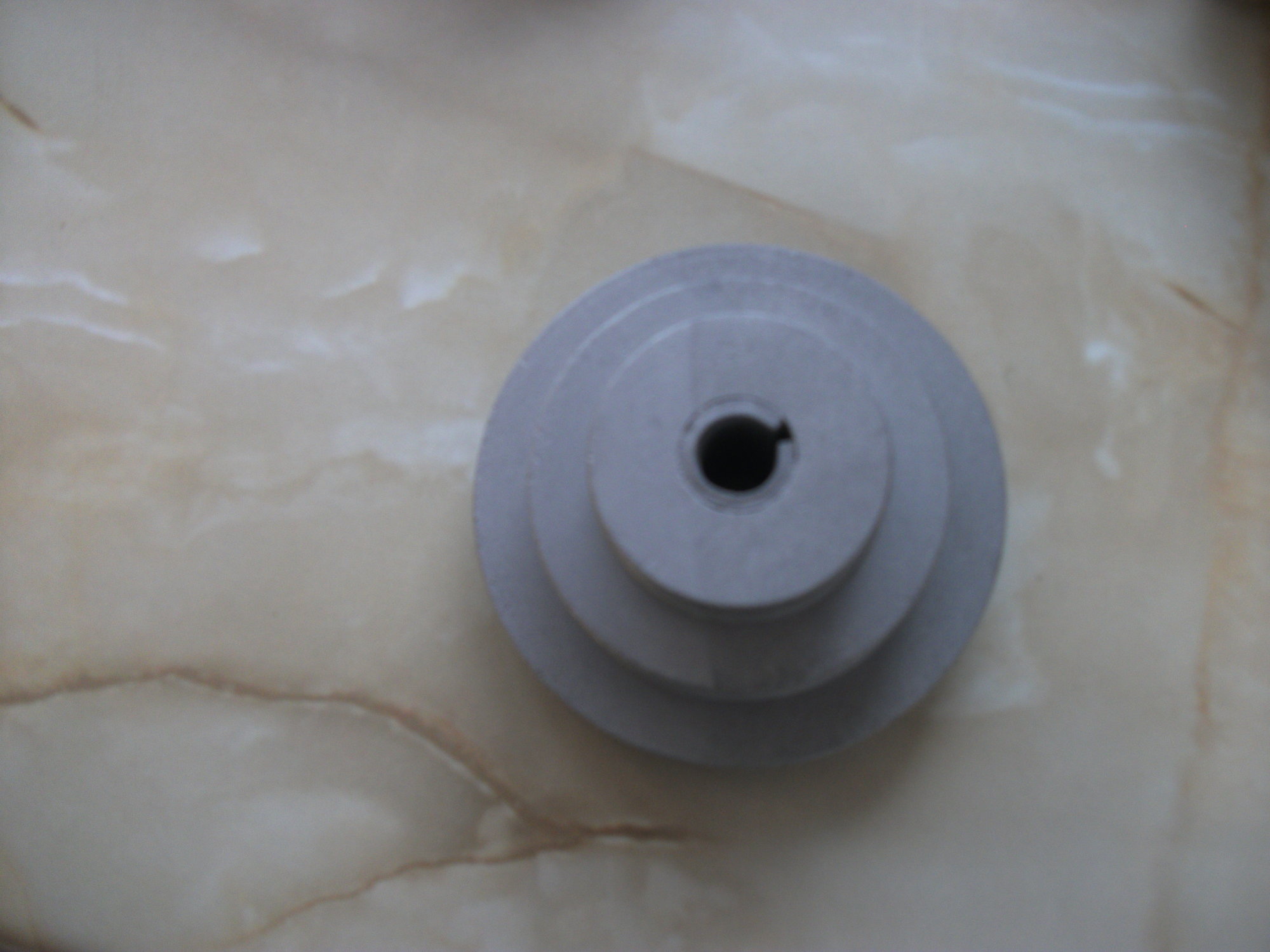

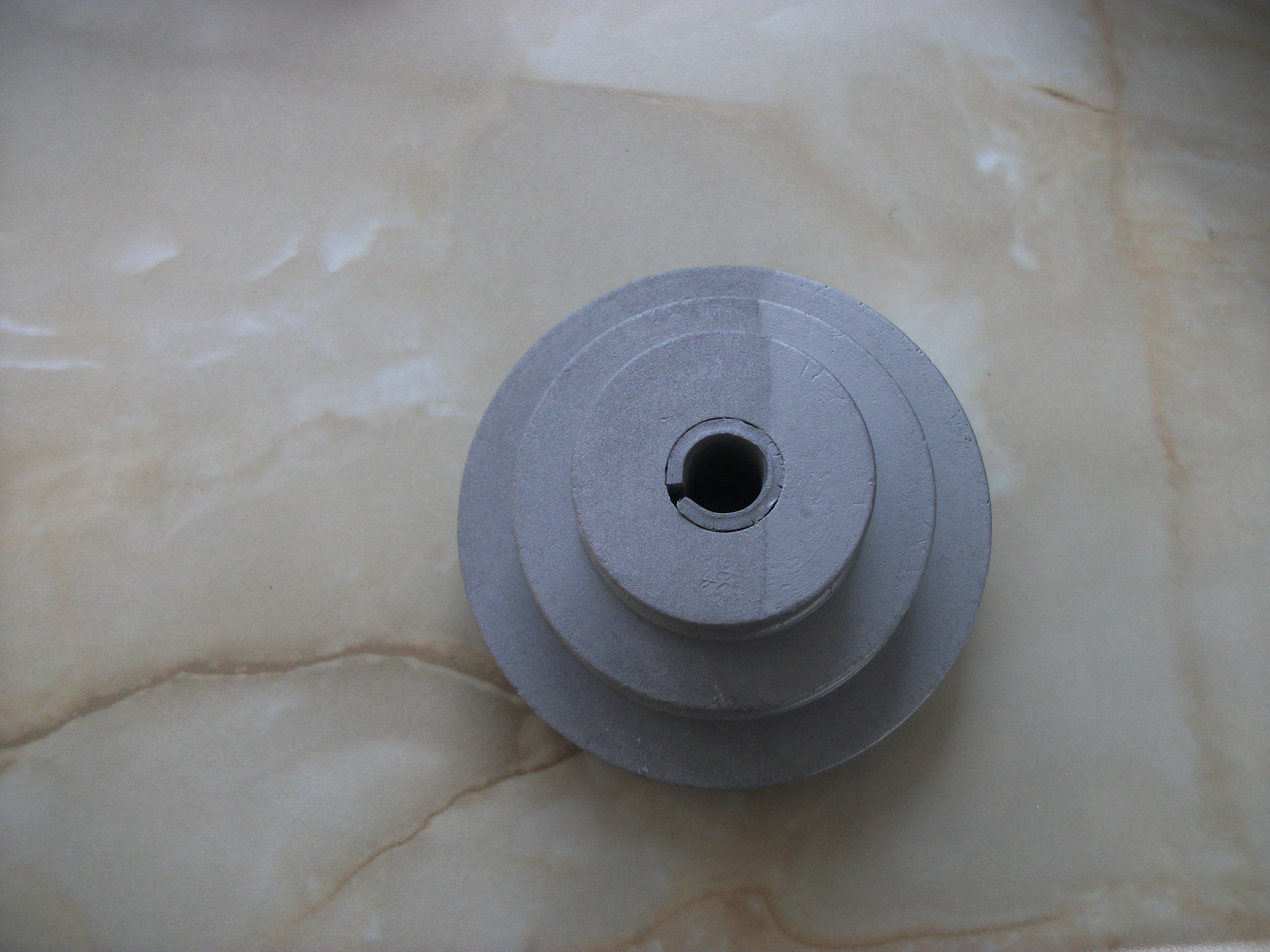

just thought id show the results of sand and beads on an old aluminium pulley for comparison .one shows just with sand to remove rust and corrosion blasted at 90 psi the other side is sandblasted then half masked off then beadblasted using a suction gun in the cabinet one a matt finish the other a smooth satin finish . I keep the beads clean by using sand 1st. if its carburettors and machined stuff it only gets beadblasted as not to alter any tolerances
