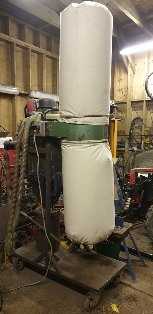

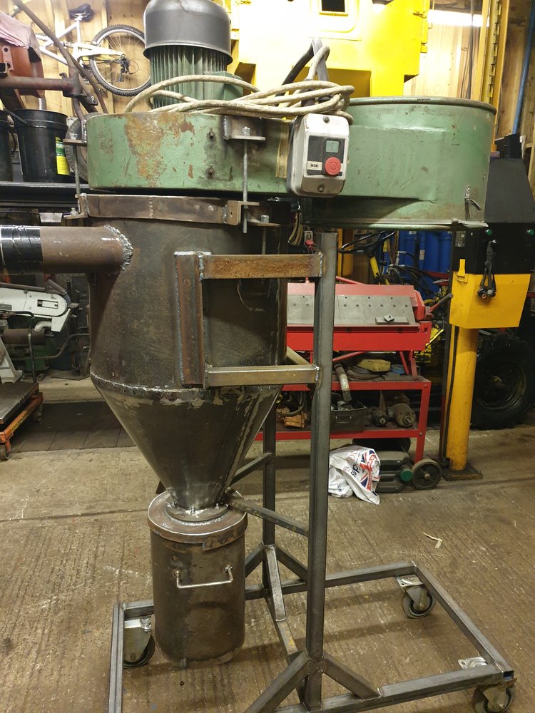

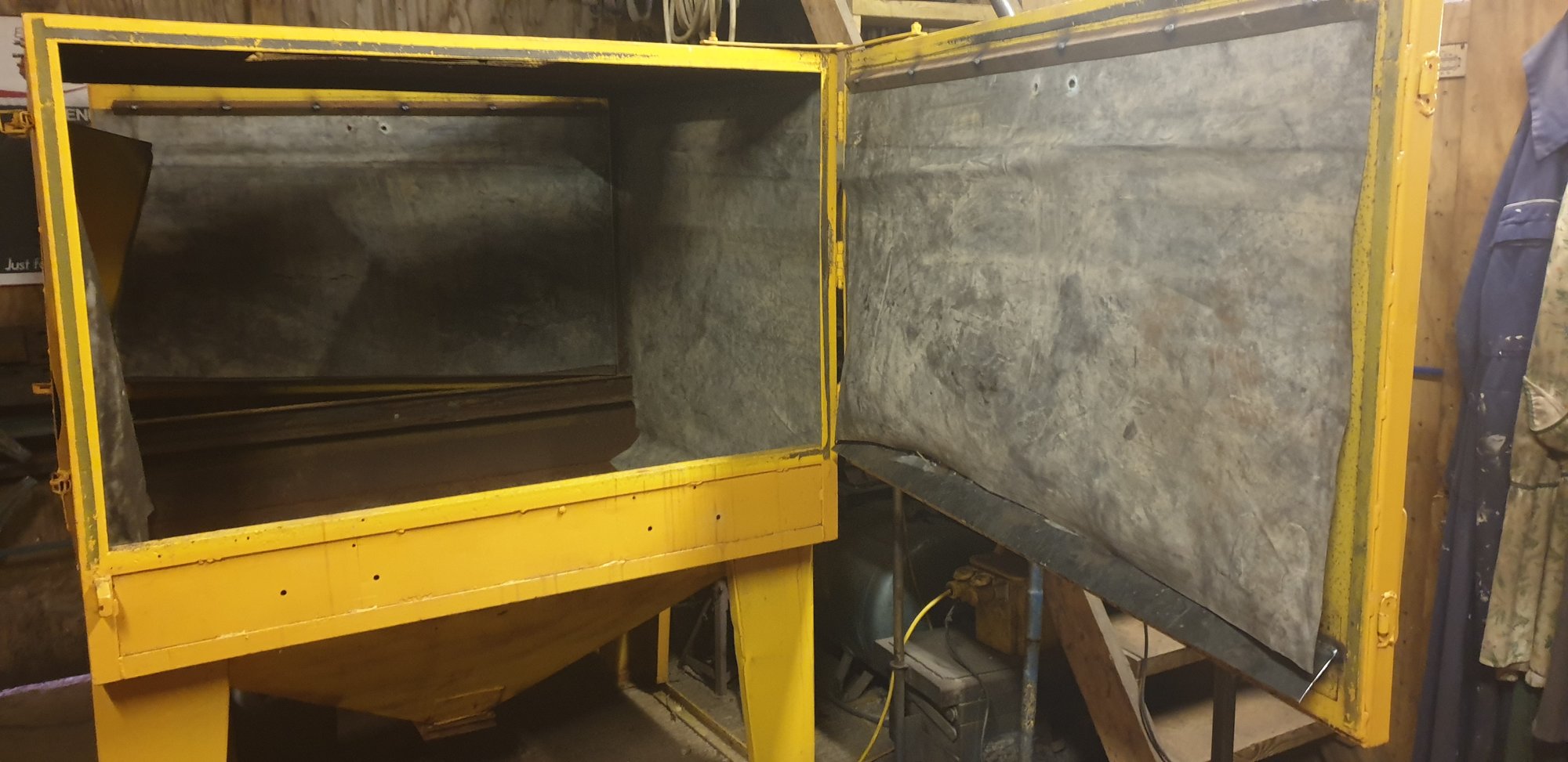

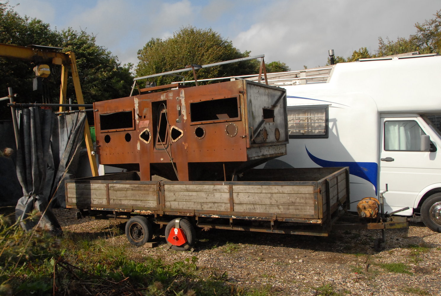

Thought i would share my latest project getting my blast cabinet up together.
Part 1

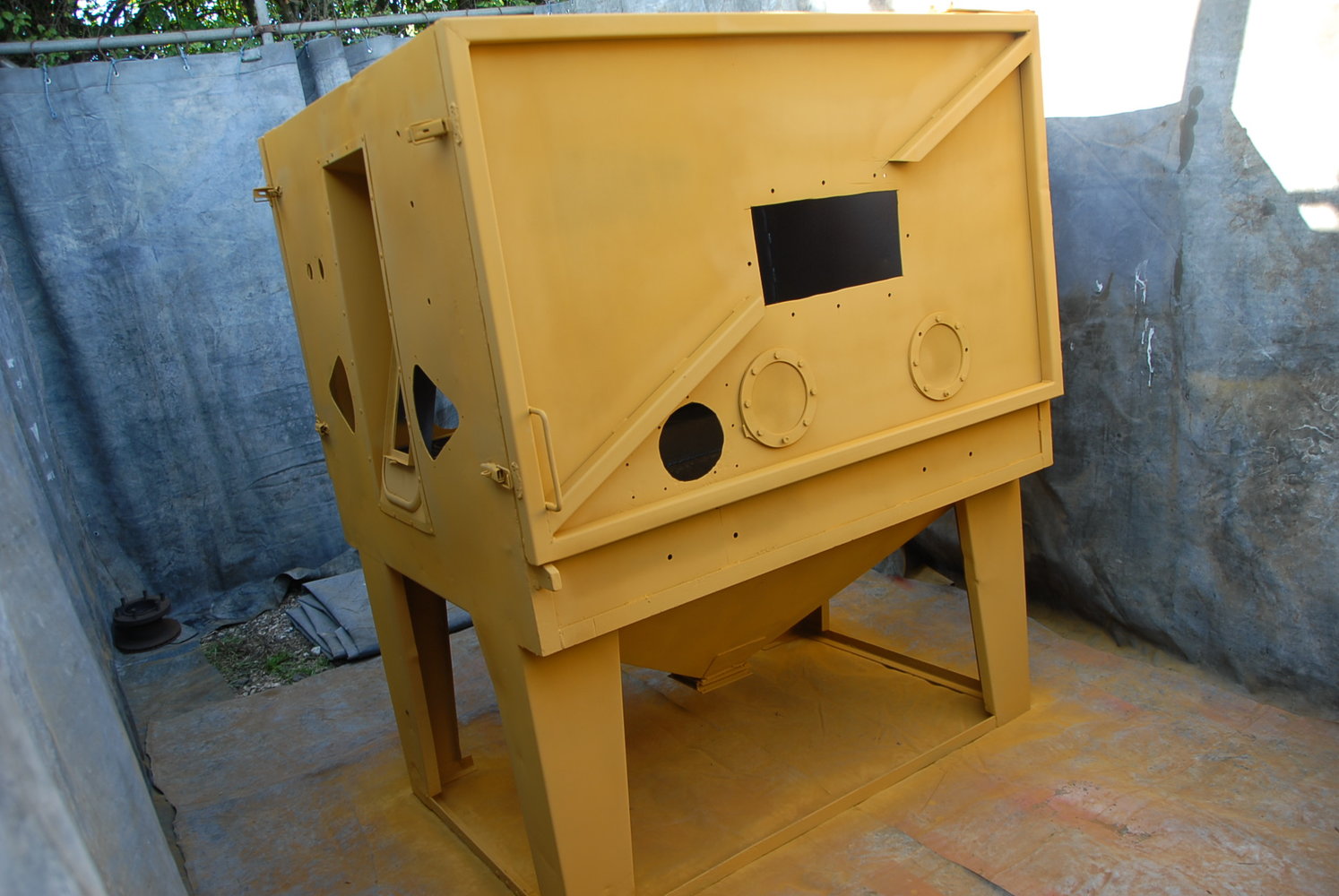

This is how it was, its a proper guyson one it must have cost an absolute forune to have custom made. Its just a little bit to big for me

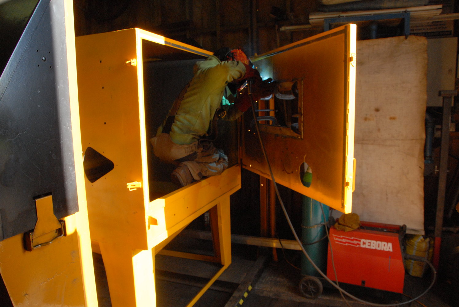

So i chopped off the both ends and im left with a good middle section.

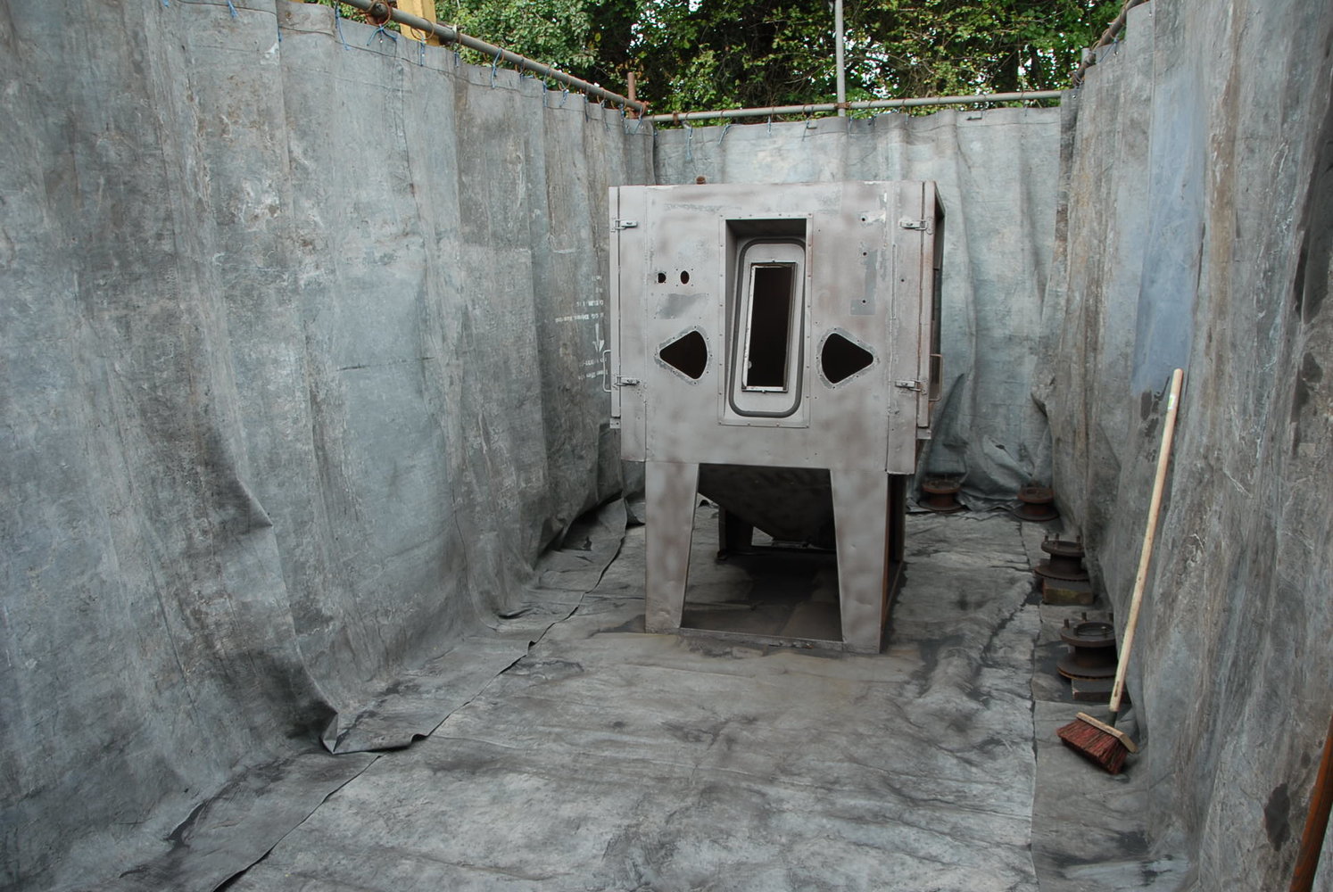

I welded the doors back onto the middle section then blasted it.
Primered and top coated

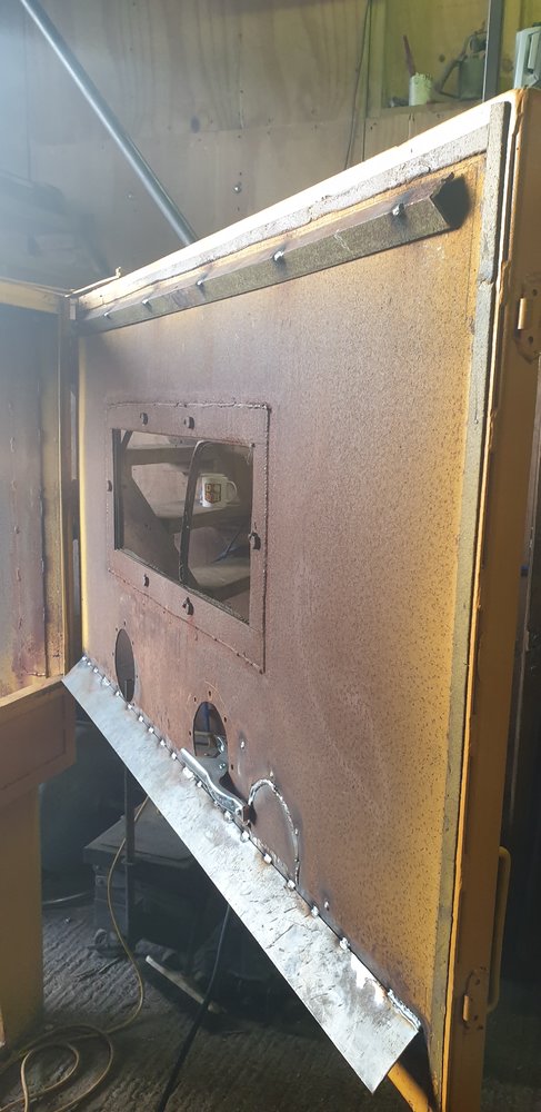

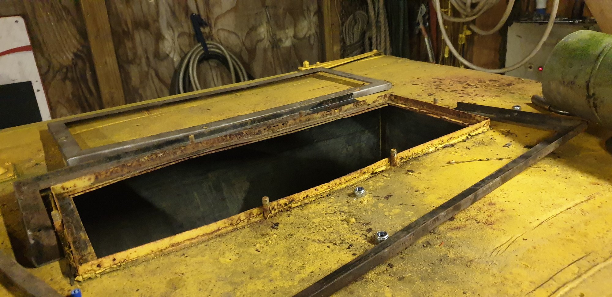

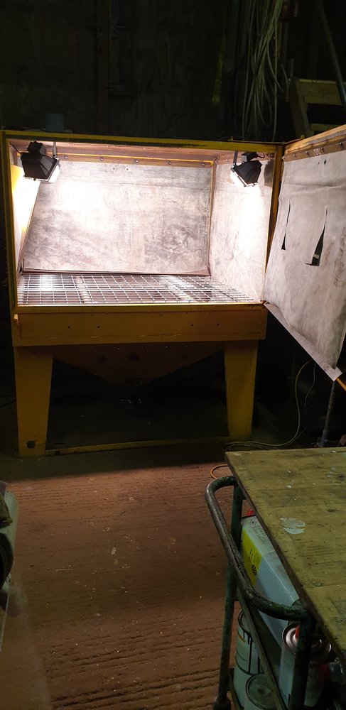

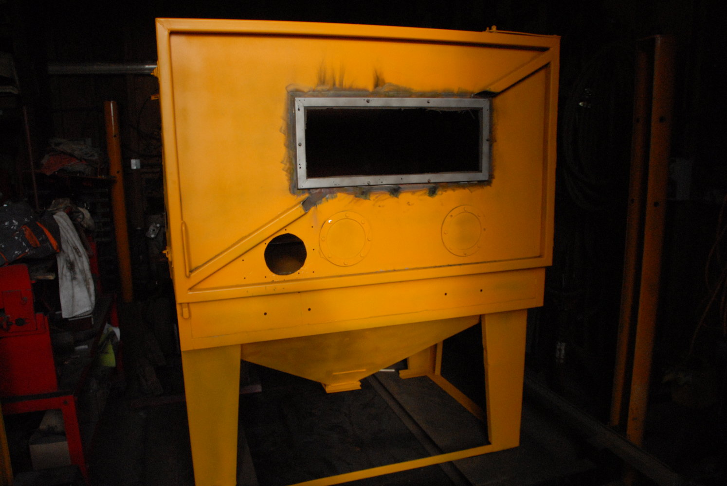

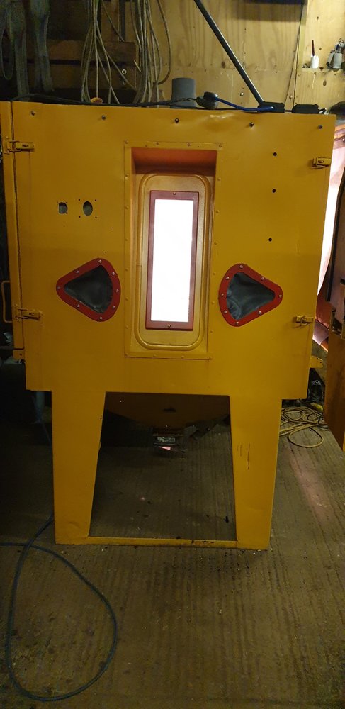

Then because im a bit of a dxxx axx sometime I decided to make the side widow bigger

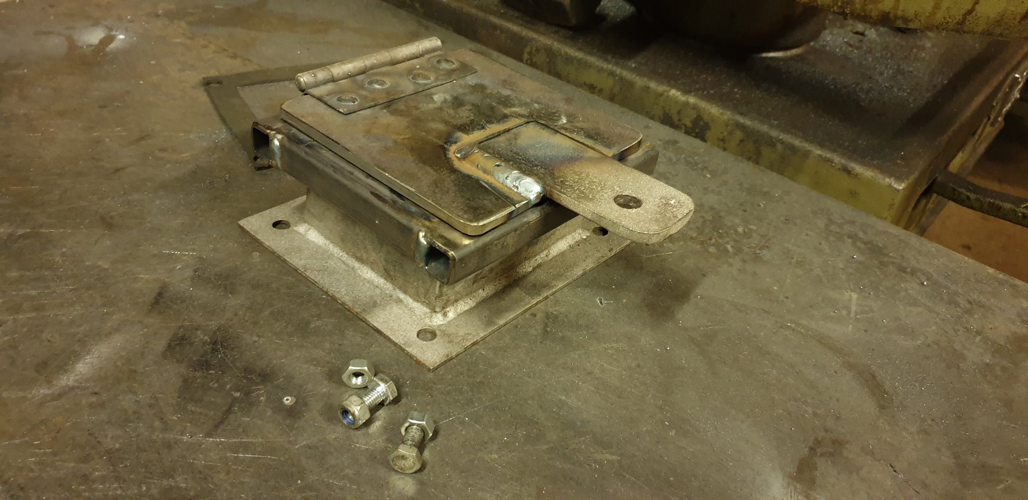

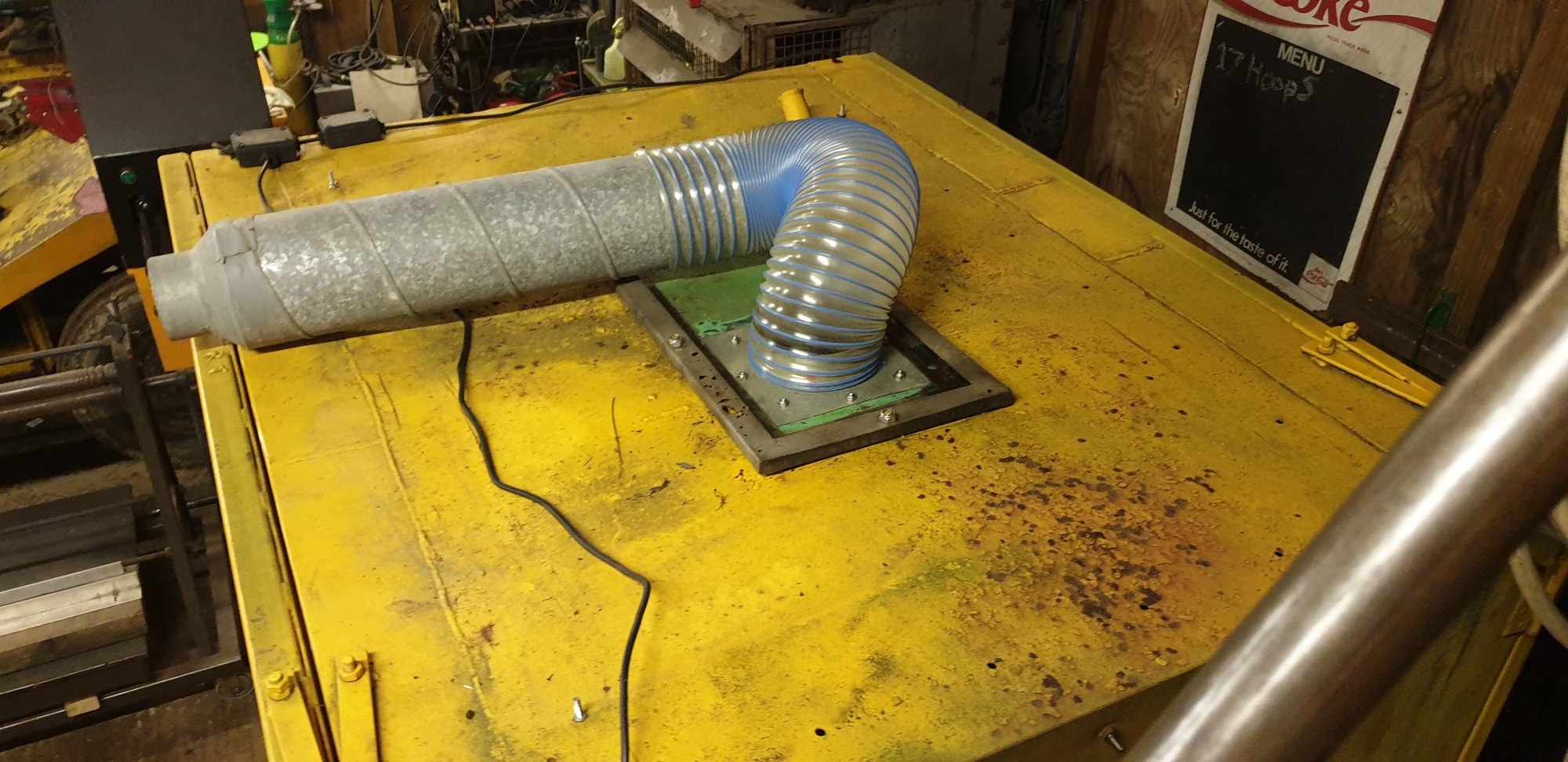

I made up some clamp bars and a grit kicker (bottom of doors) and fitted the rubber lining all round the inside

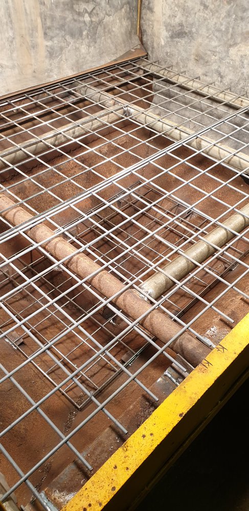

made up the internal grill frame support

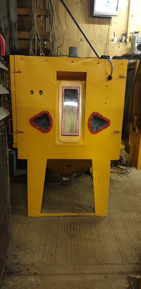

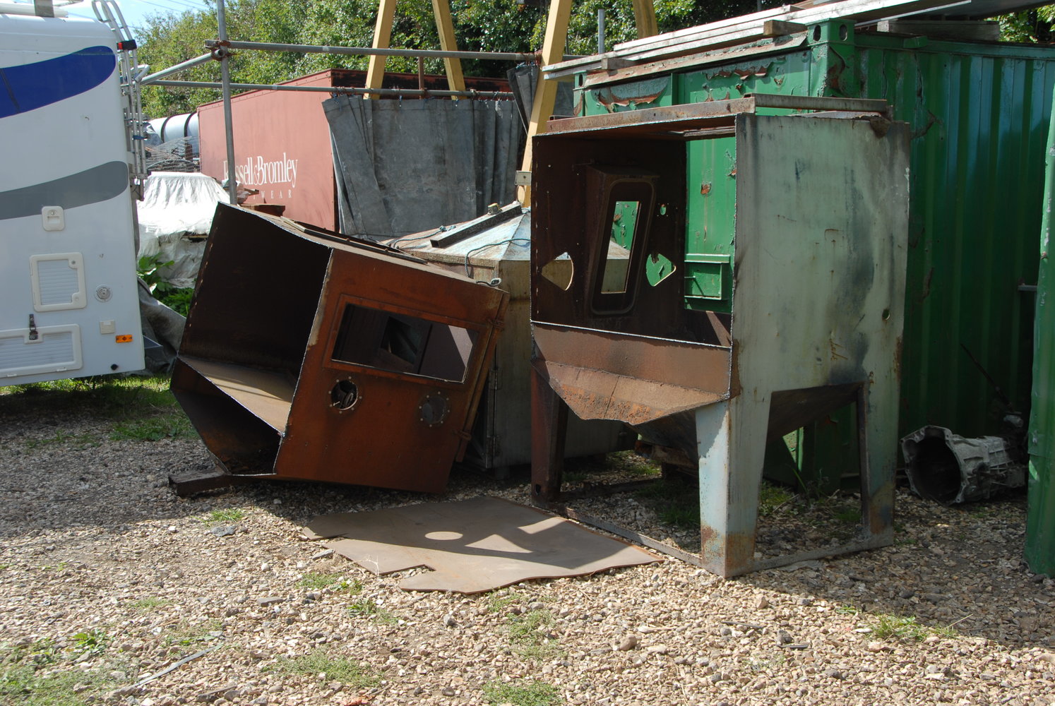

Part 1

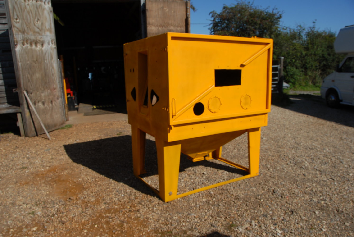

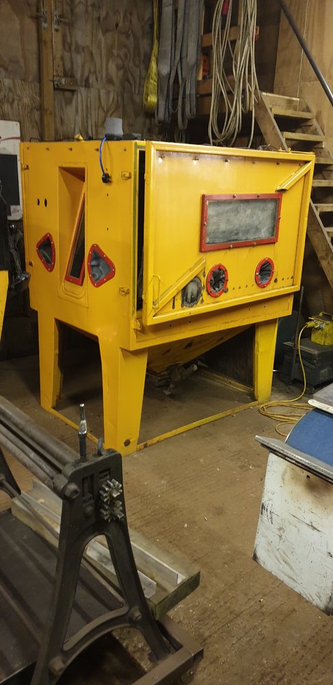

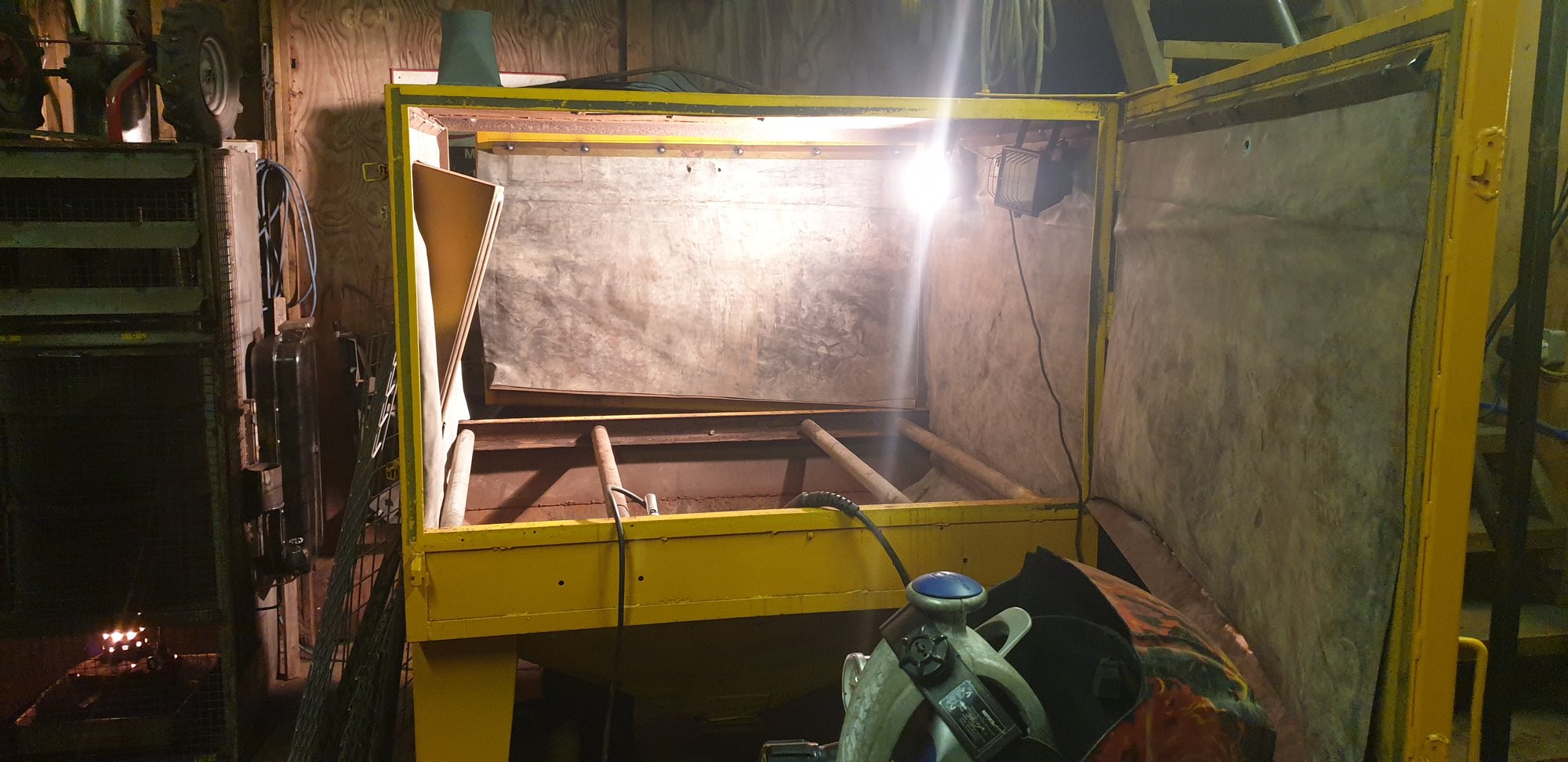

Part 2 coming
