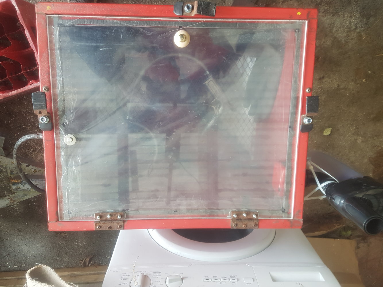

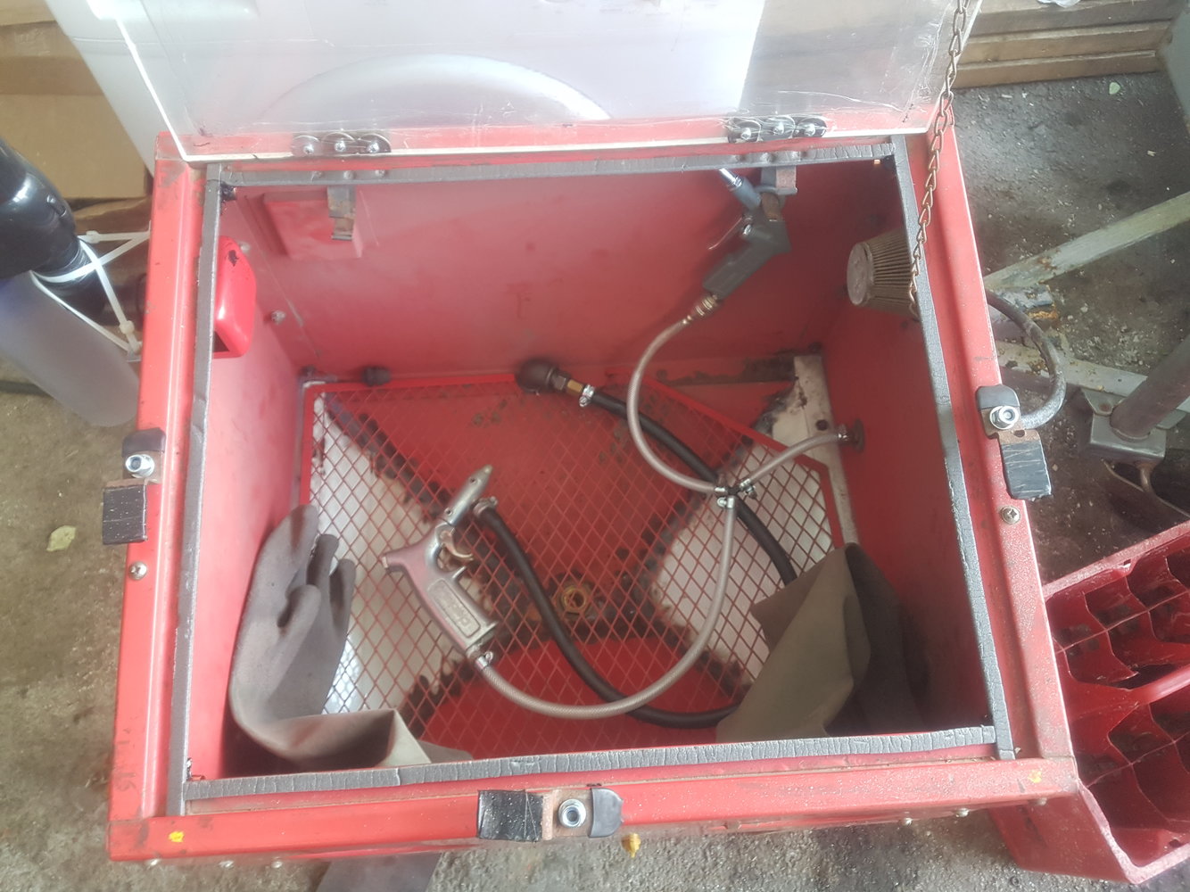

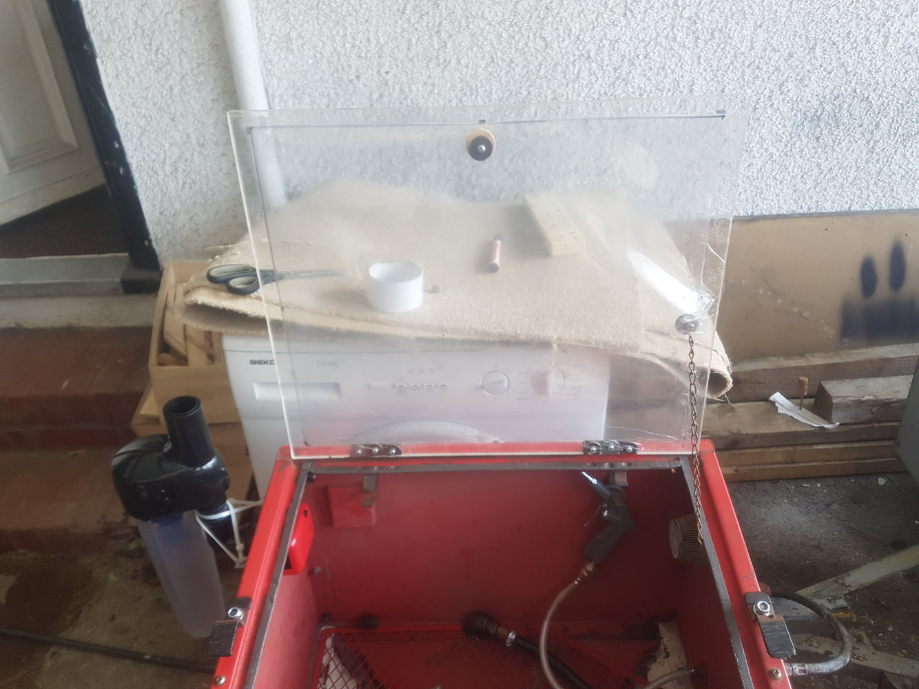

I have one of these cabinets. When I first used it without an extraction hose I suffered with a bad cough even though I had a dust mask on. I resealed the door and that helped a lot. I then made up an adaptor that I could clip on to the exit port on the back and linked it to a Henry. That really helped. I found that the clear door protection film soon clouded over and wan't easy to clean. So I invested in 50 A3 clear printer films and a couple of rolls of 1/2 inch double sided tape. I made up the films with the double sided tape around the edges, making sure the smooth side faced the inside of the cabinet. These were easy and quick to change and a lot cheaper that the proper ones. As regards the blast nozzles, I found you can buy them in bulk on Ebay. I bought the smallest nozzle size as they wear pretty quickly if you have the pressure too high. I kept the inlet filter. The light is rubbish and I found it best to blast in poor light to stop the reflection in the viewing window. The media pick up on these is rubbish as it keeps sucking an empty pit and you end up tipping the whole cabinet up to redistribute the media. It need a pyramid hopper not a ridge hopper. Perhaps modifying so that the media falls out of the bottom and gets collected in a receptacle and sucked up again would be better.
