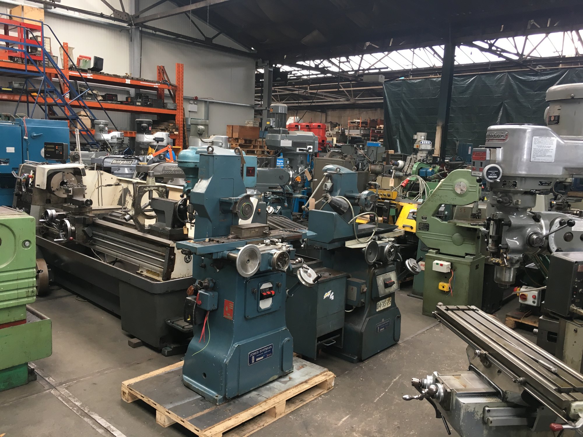

“premises” / Toy shopView attachment 228134 A view of the premises
