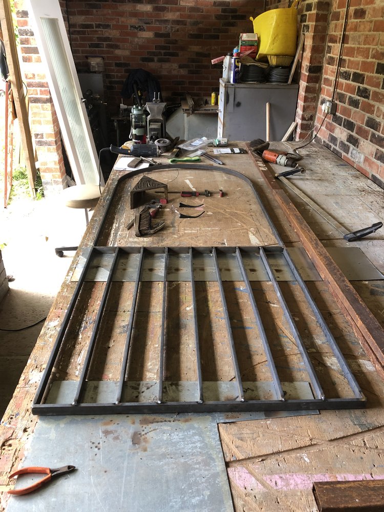

I am not a full time blacksmith (although quickly heading that way), I have been doing a lot of fabricating gates etc locally and general repairs, but it is the traditional skill that interests me more than the modern fabrication that a lot of people are doing.

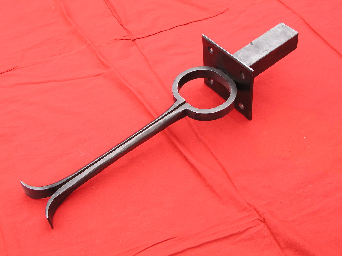

I'll start, today I have been making tools to make a traditional gate, starting with forming the mortises and tenons.
For the mortises, a small slot punch, drift to drift from slot to round and a 10mm pass through drift.

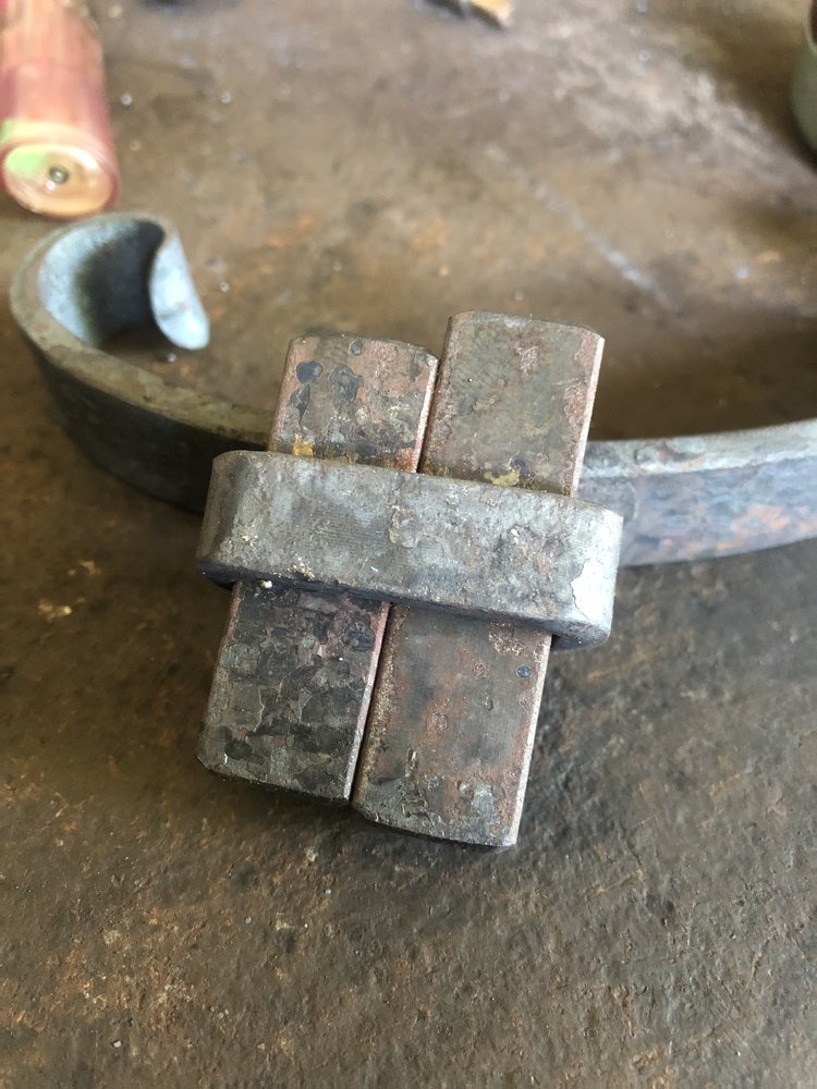

A spring swage for refining the tenons, 10+12mm (shockingly this is probably the best MIG welding I have ever done).

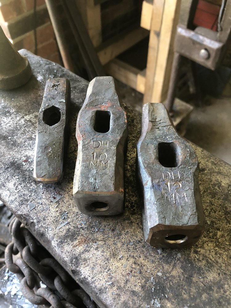

Yesterday I made three monkey tools to dress the shoulders of the tenons, 8mm, 10mm and 12mm.

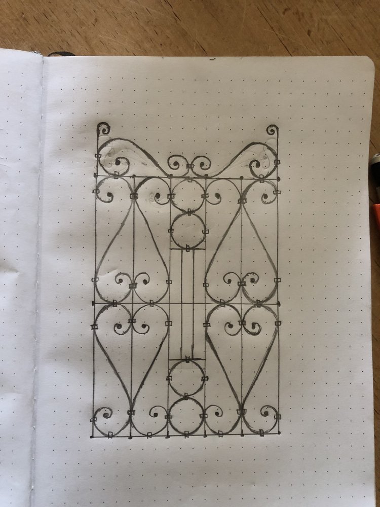

And my first attempt, pretty pleased with that.
