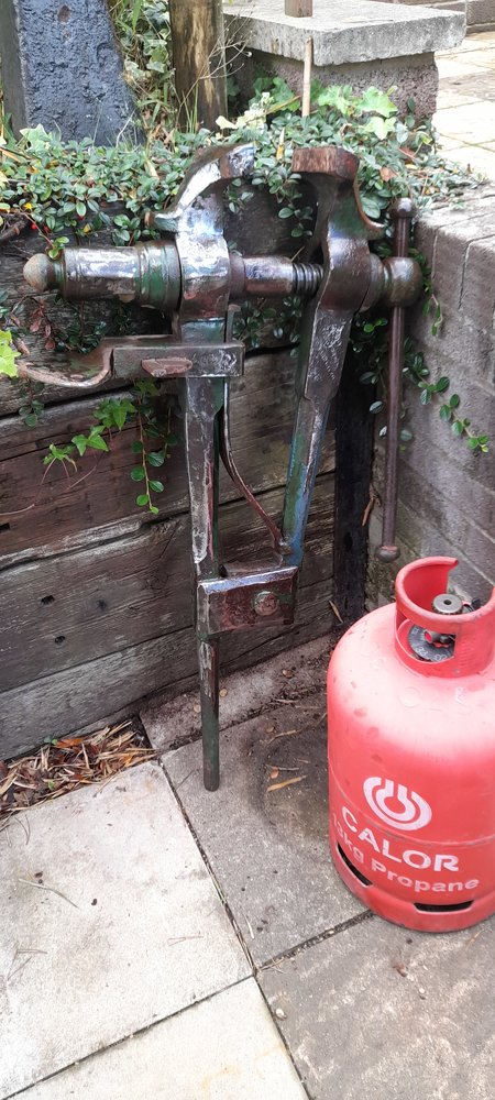

Can you forge weld steel (or iron if you like) to cast?I have always known them to be cast steel components which are then forge welded where necessary. You wouldn't want to forge the intricate shape of those jaws from stock materials!
You can see signs of it with the lower moving jaw brackets - forge welded in place for example. I suspect the jaw "inserts" are also separate components forge welded to the cast (and forged!) jaw bodies.
