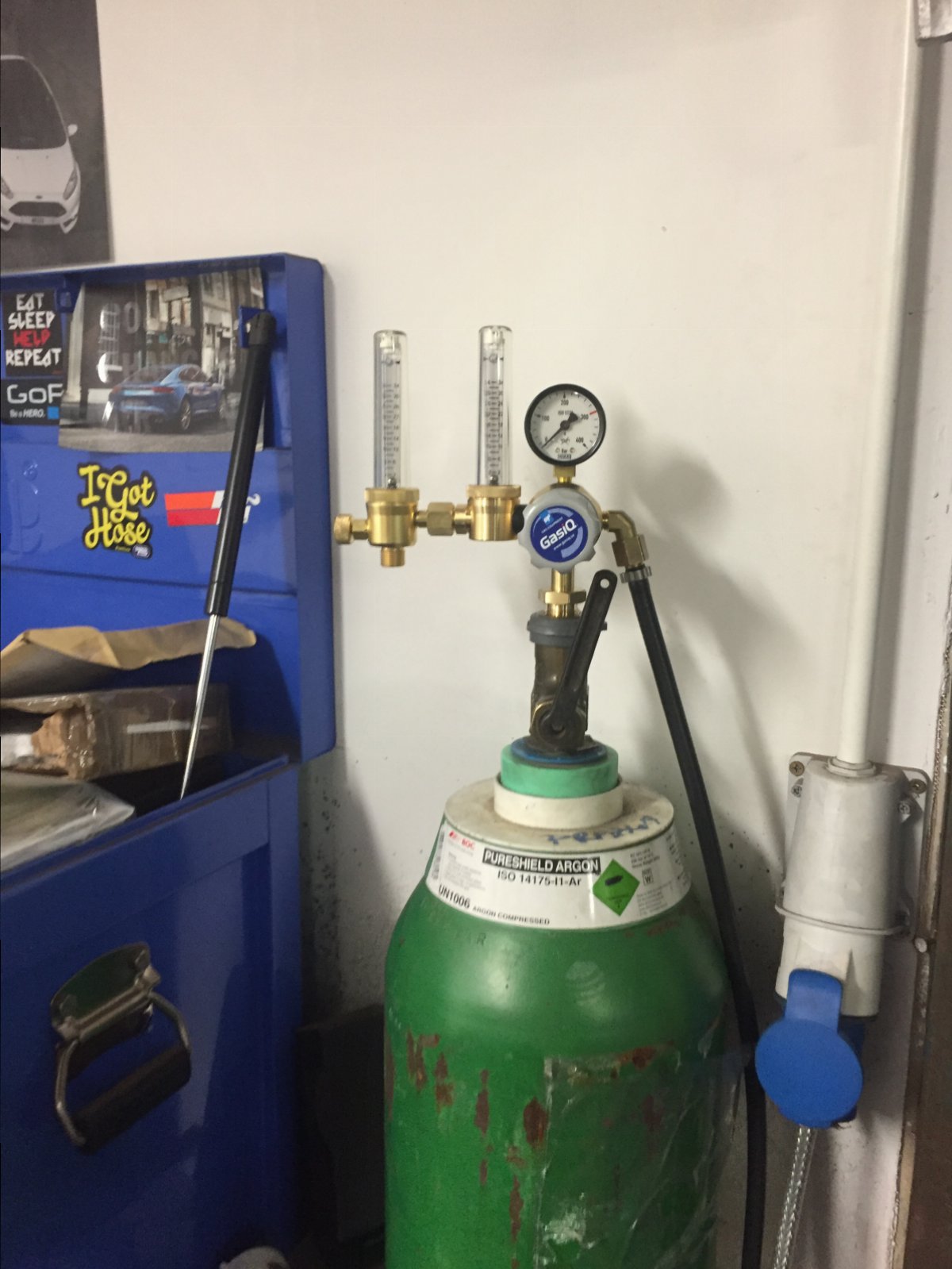

Stupid if you ask me, a top end regulator over £200 and it doesn't suit the application it's designed for. I don't know any industries which need 32lpm of purge gas nor welding gas unless youre talking purging an entire pipe system. I couldn't imagine running mig over 25lpm. Robotic applications? Who knows. Just want a gas saving regulator now, the elga just offers the neatest solution.[/QUOT
