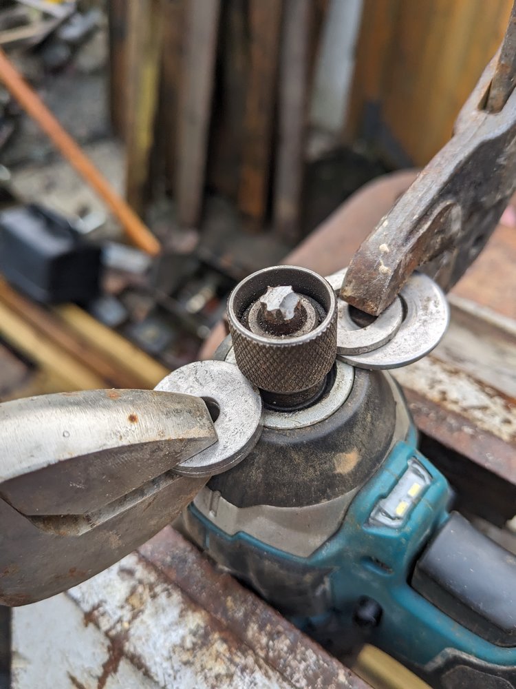

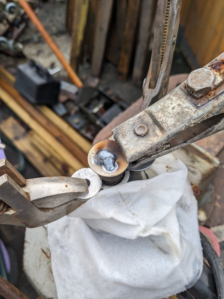

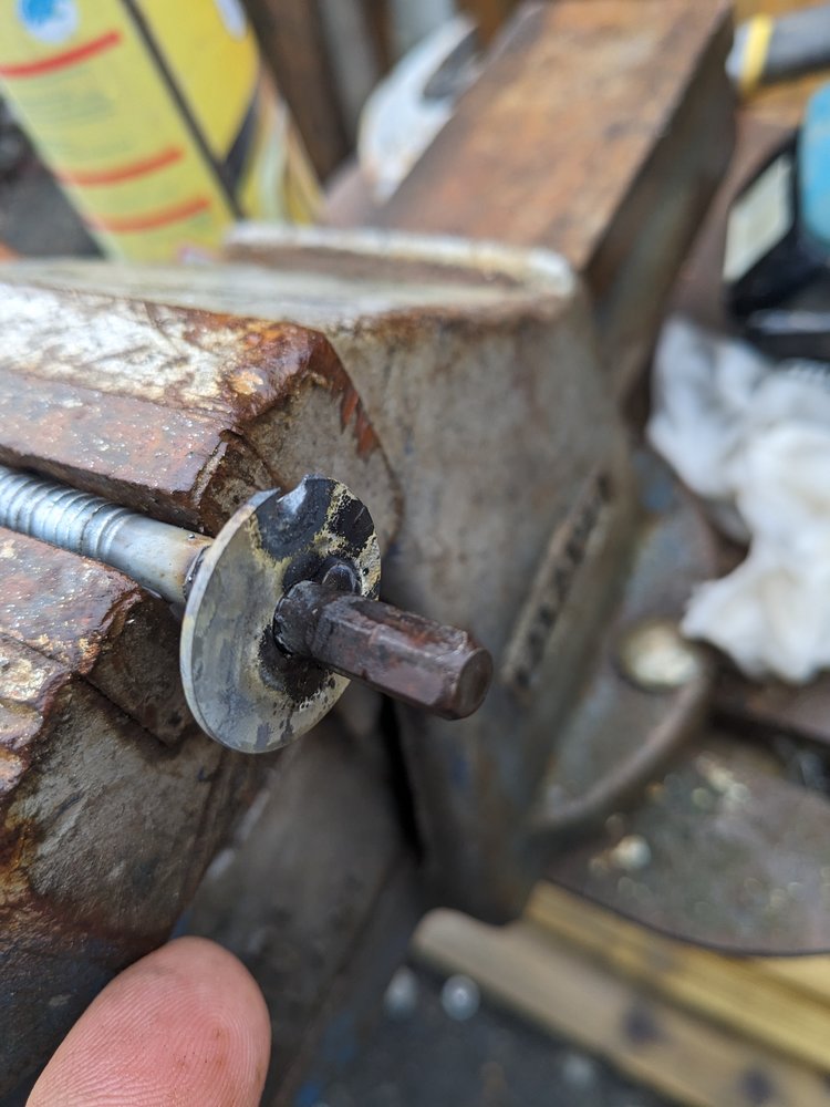

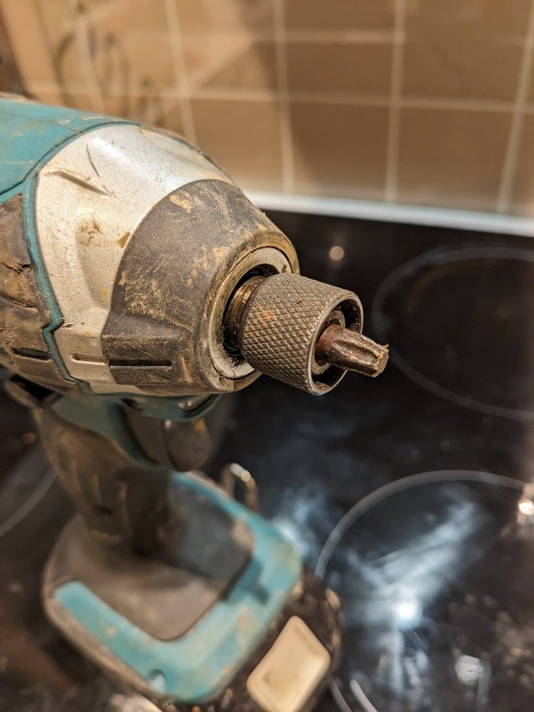

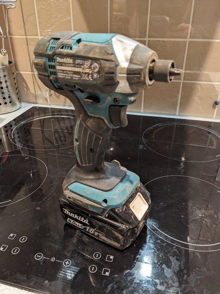

So Muppet here used a rusty torx in my impact driver and it's now stuck
Tried holding bit in vice but no joy it's just crushing and slips out .
I'm thinking to mig weld a bolt onto the end of the bit to get more purchase the tap the body of the driver with a soft hammer pulling the sleeve back at same time of course ....
Any one with better idea ?? Cheers folks
