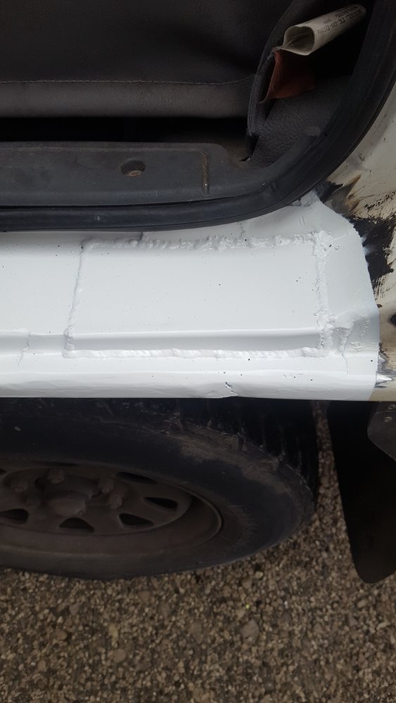

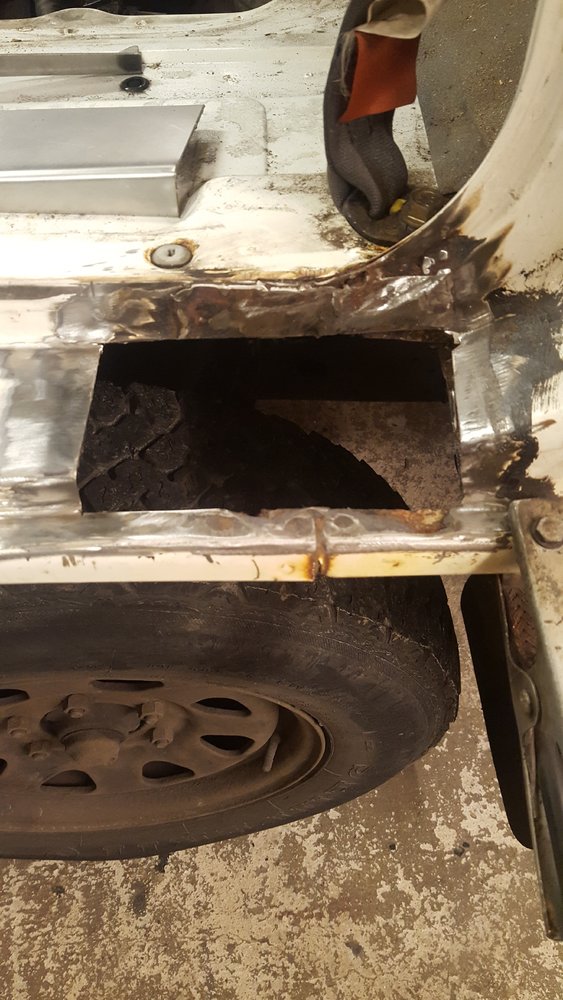

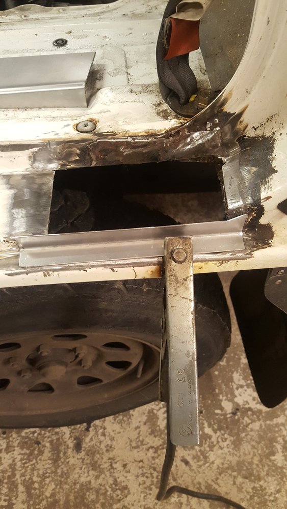

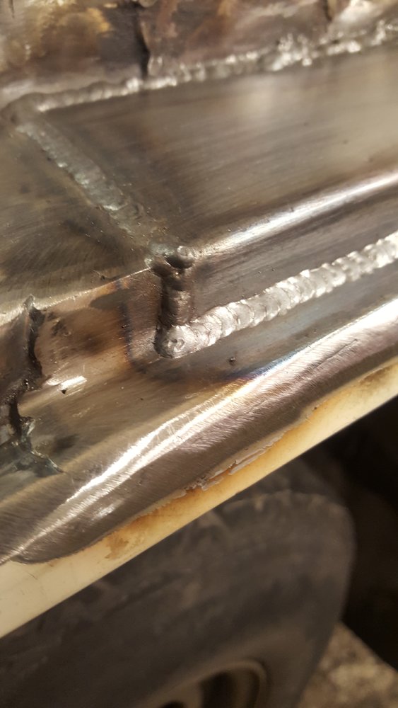

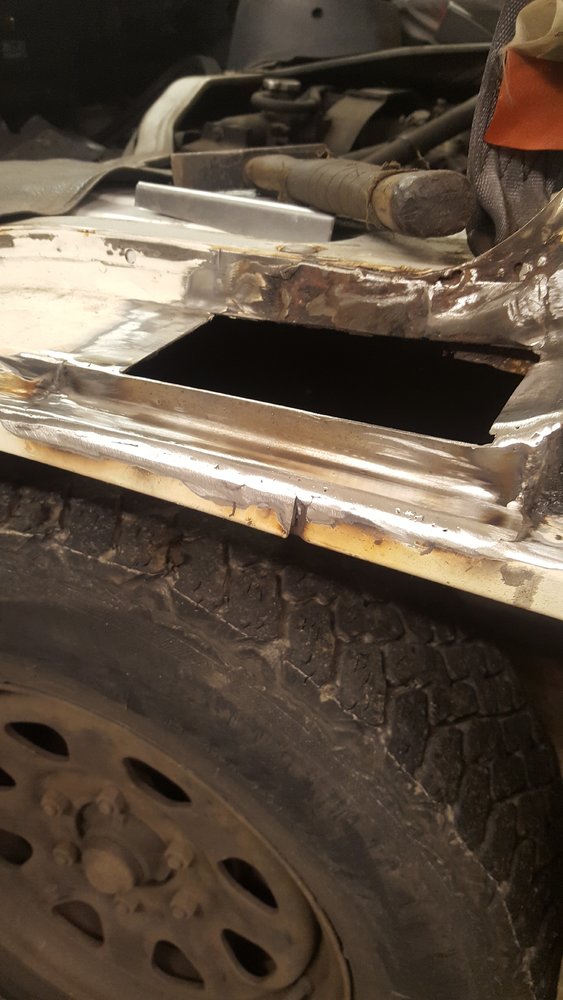

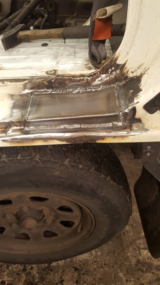

My trusty old 1999 Nissan Cabstar which just refuses to die had a fail on its class 7,small hole on the nearside wheel arch near the seatbelt anchor point...Recieved my off cuts of thin plate from @Theblackbox today so found a couple of hours to carry out the small repair...It had been done sometime in the past (not by me) but very poor and MOT inspector put his hammer through it
anyway pics tell the story and bit of brake pipe this week and re-test time on sat morning.
