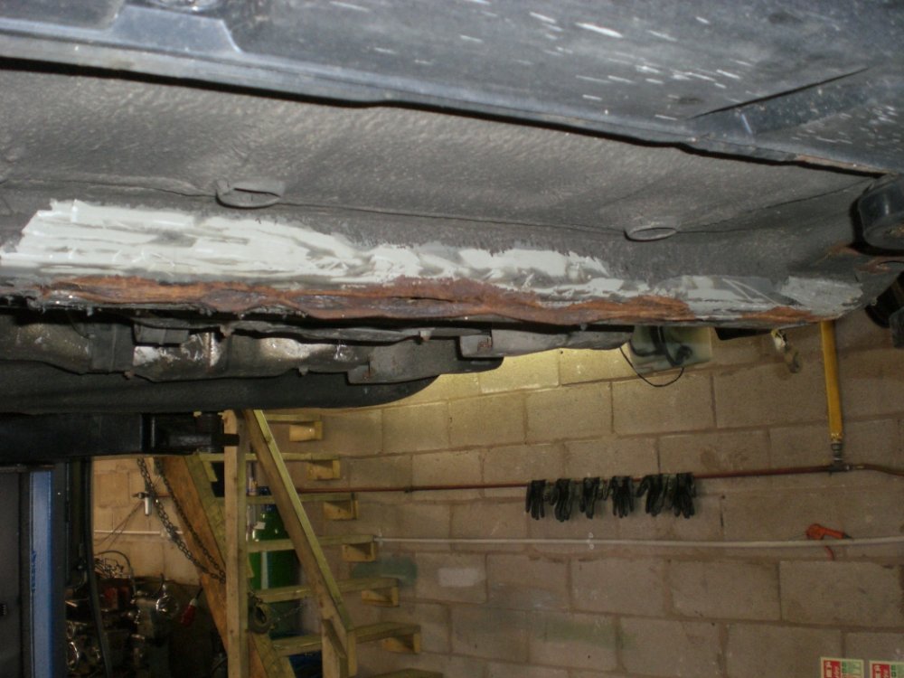

Just thought I would sling up a couple of pics from a while ago when I repaired a rusty section of chassis rail on my car

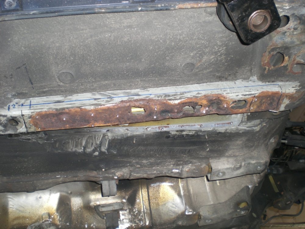

There was lamination where one section is sat against another, this is after prying it a little with a lever
Cut away a section of the overlapping piece
Then cut out the next section

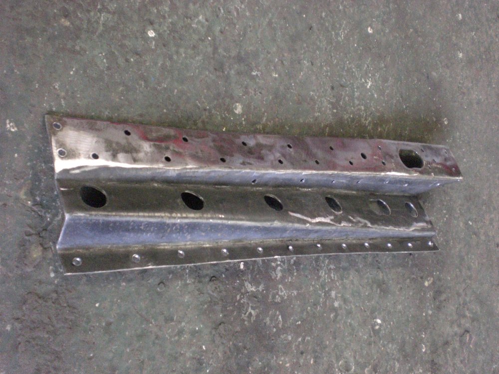

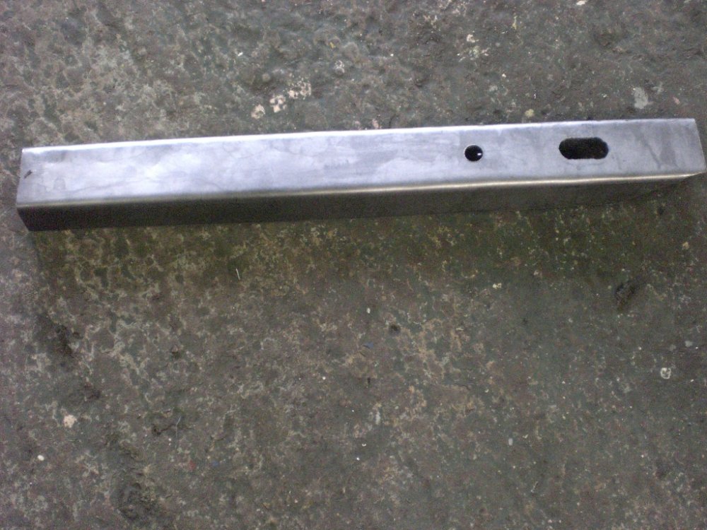

Made a new section

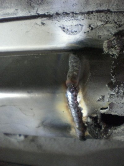

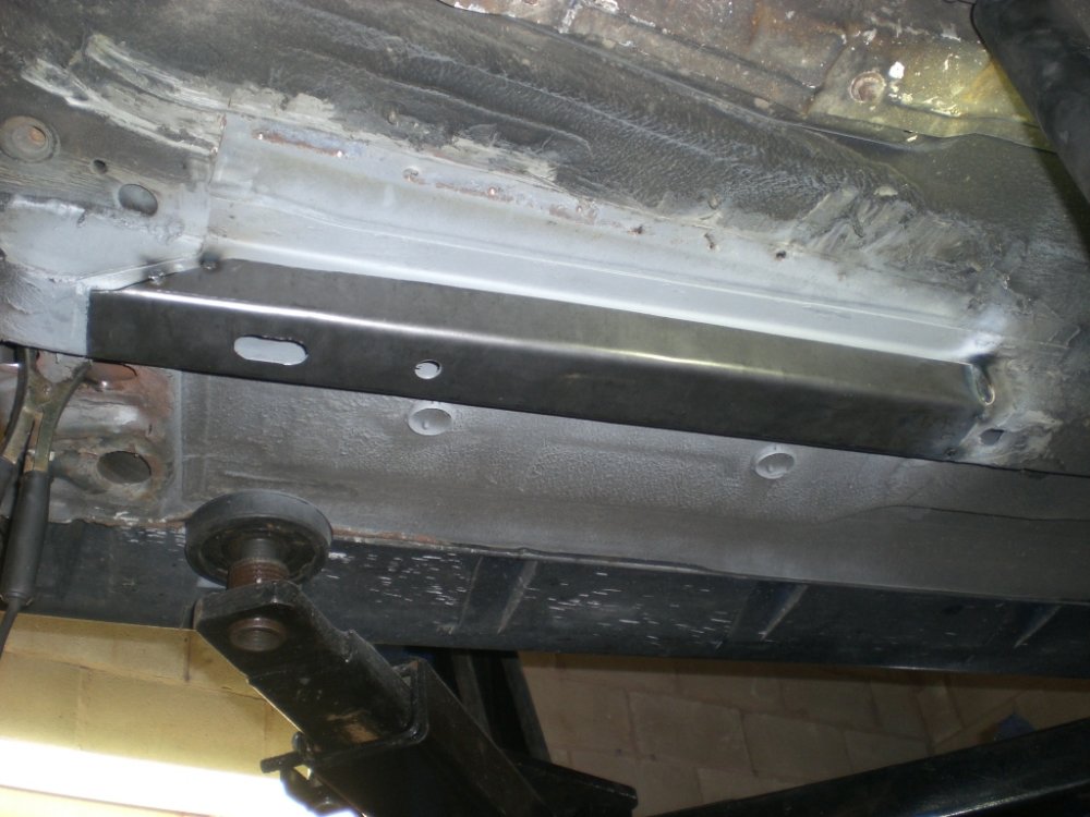

Beginning to weld it in
Made a new section for the next part (this took a few hours to hand make from 2mm)

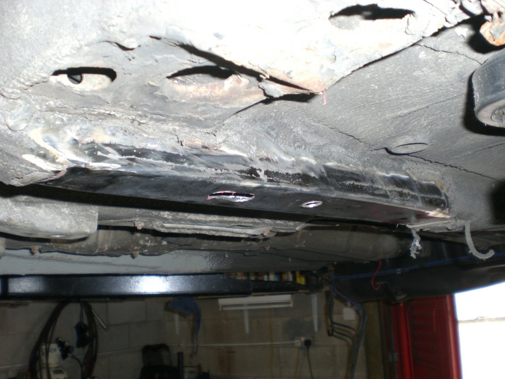

Working against gravity

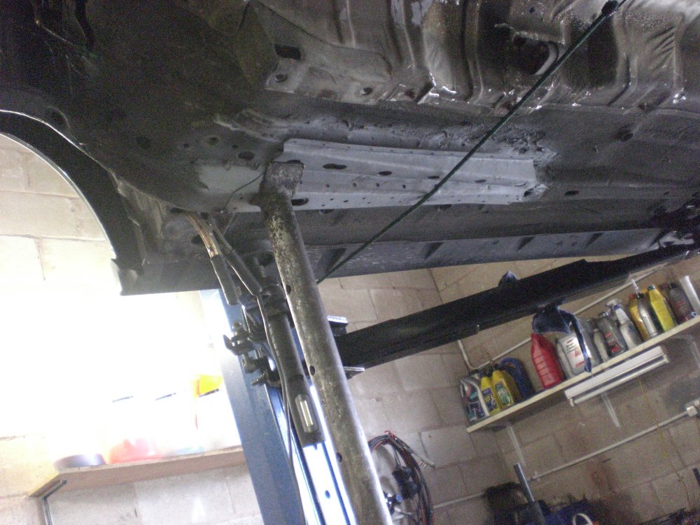

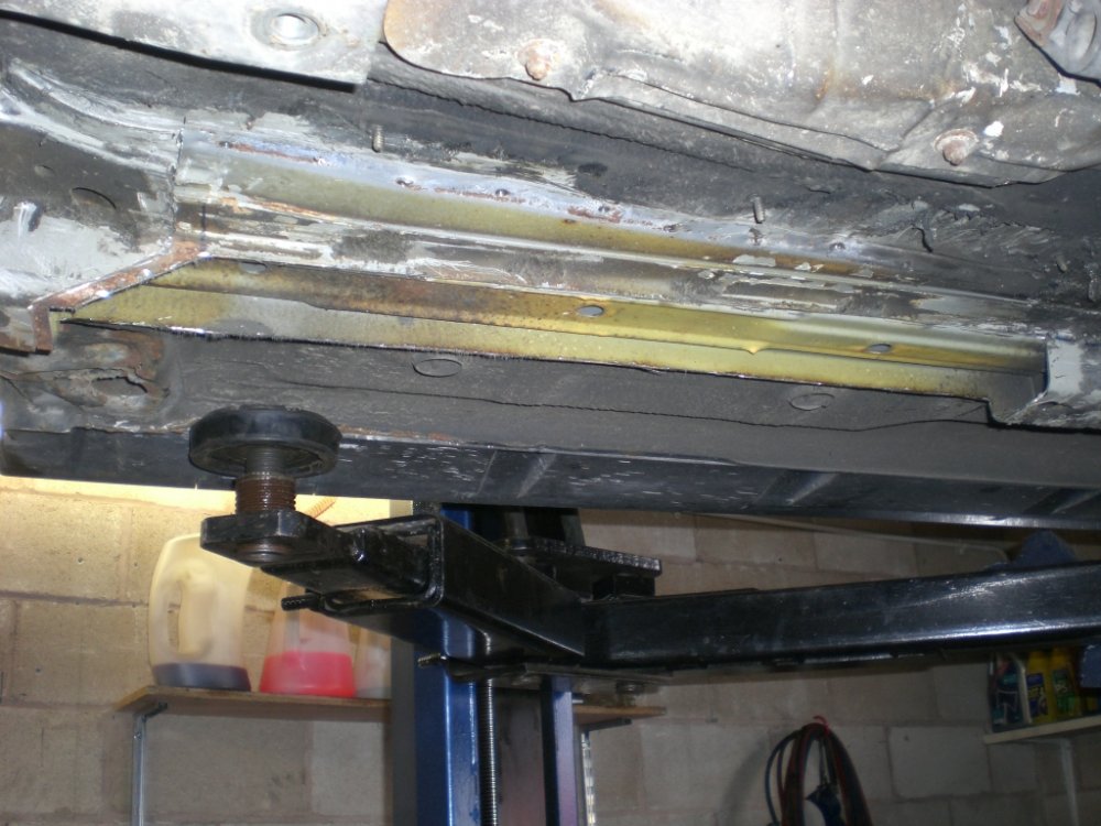

That was it for the drivers side, this is the passenger side - same script
