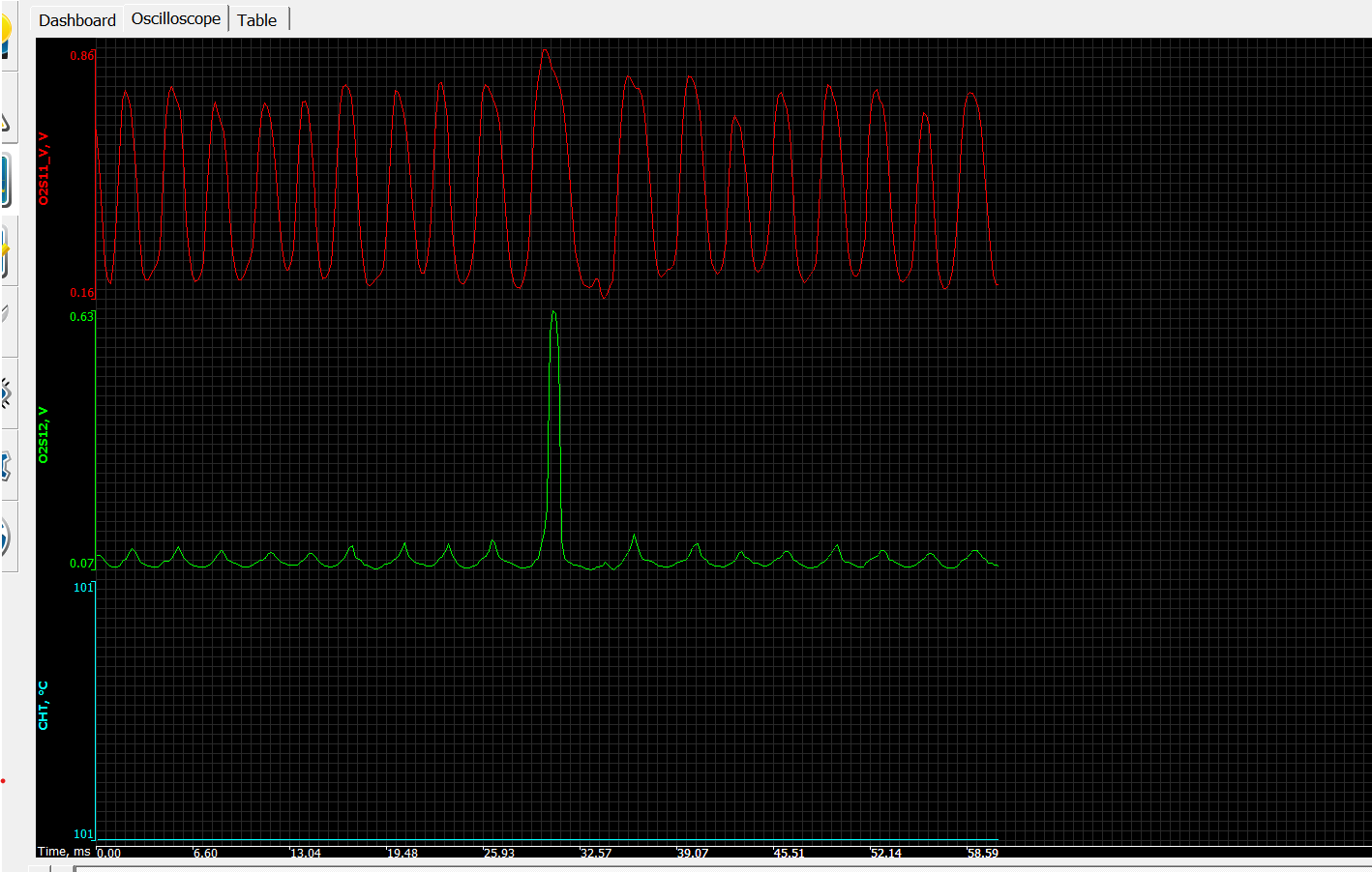

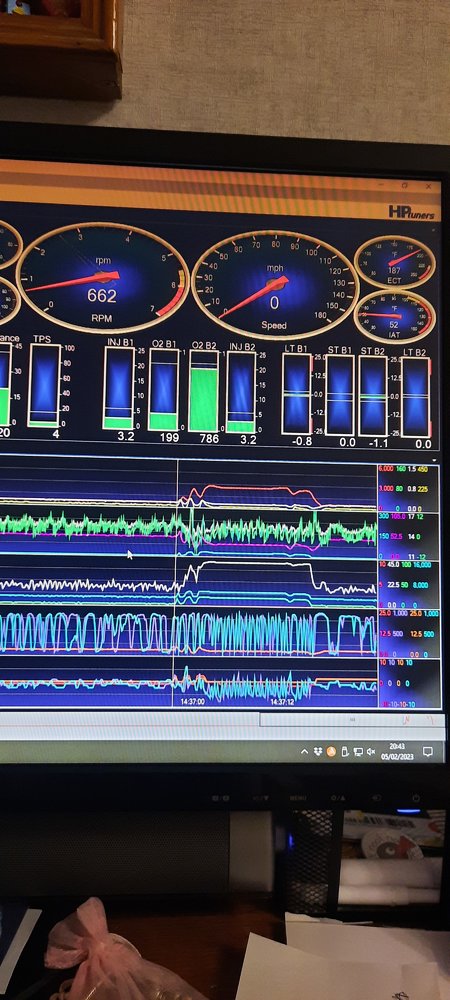

hovering around 0.1 v or soNarrow band sensors always cycle usually between 0.1mv and 0.9mv i don't think your seeing that on the scanner ?
the plug and wiring length match up , seller checked against rego, and my own checking suggeted it was correctThey definitely supplied the post cat sensor?
A new post cat sensor not rising above 0.1V is generally a sign you've just fitted a pre-cat sensor...
back probe the connector with a pin or something ?‘
I would be confirming readings with a meter or scope at this point’
I said this in post number 2….
Anyone can play parts darts, start with the basics….
Your approach seems reasonable, however, if the ecu input for the sensor was damaged in some way, it could affect the reading the sensor is trying to provide…hence why I said jury rig a supply to the sensor and measure what comes out….(makes sure you measure the supply going to the sensor first…and match it, don’t just stick 12v on it)back probe the connector with a pin or something ?
analogue meter , one side earthed other into the signal ? see if it matches what live data says ?
If the output voltage is around the figures quoted within this thread, then your meter on the 200mV range should suffice, or switch up to the next range….
