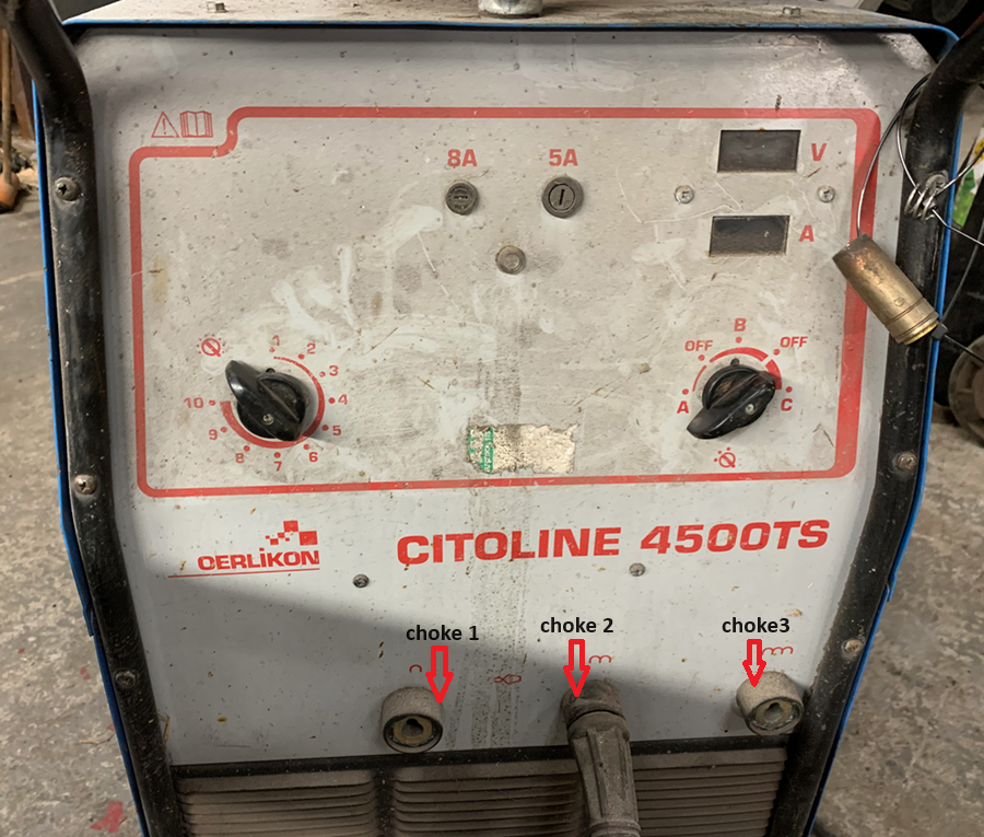

Finally got to do a couple of small welds and tried choke 3 setting, I could tell as soon as the arc started it was much smoother, though it was an easy position weld, thank you.you have to see which choke suits your setting. If you weld with a spray arc, this no longer has any effect.
