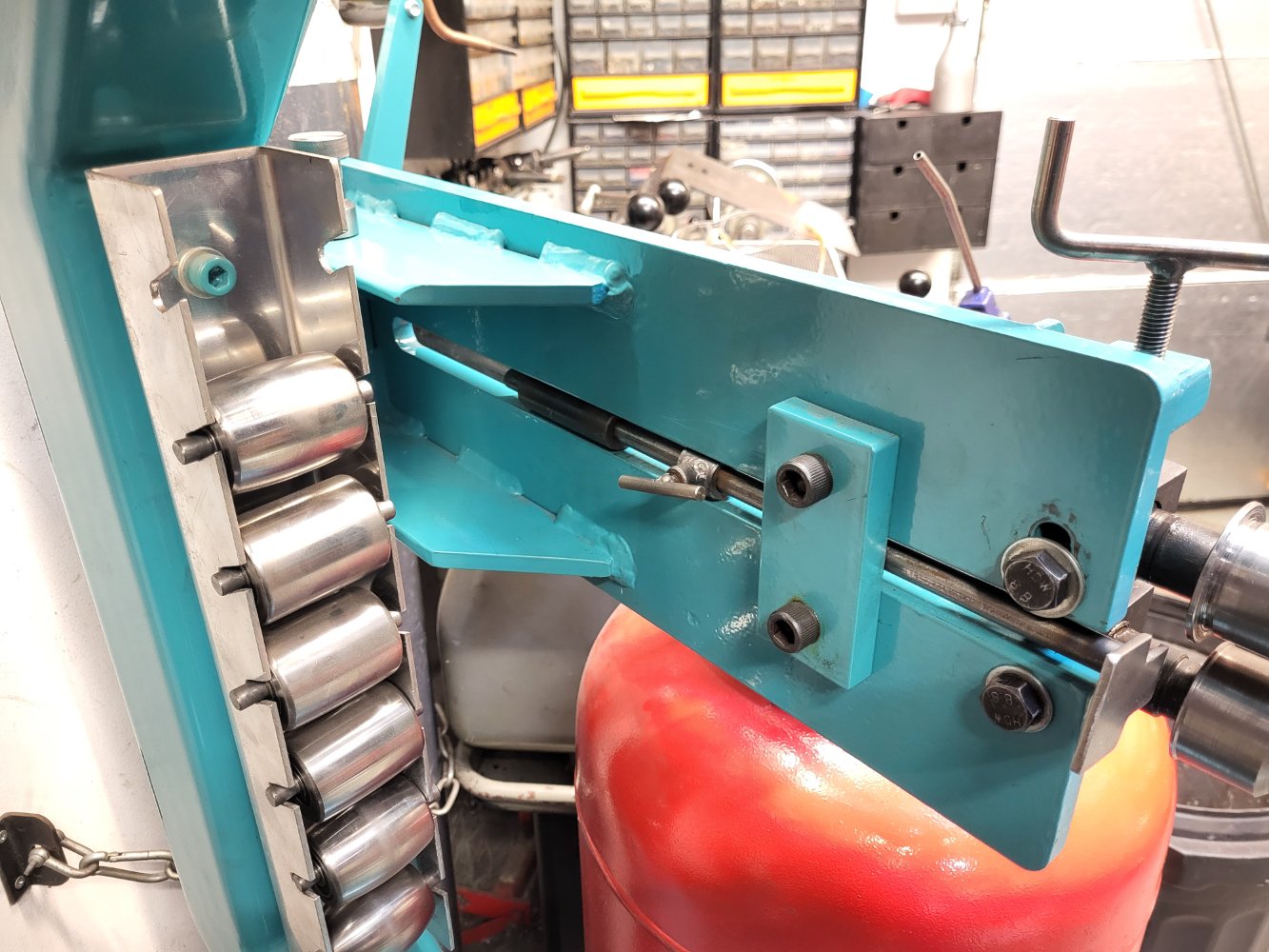

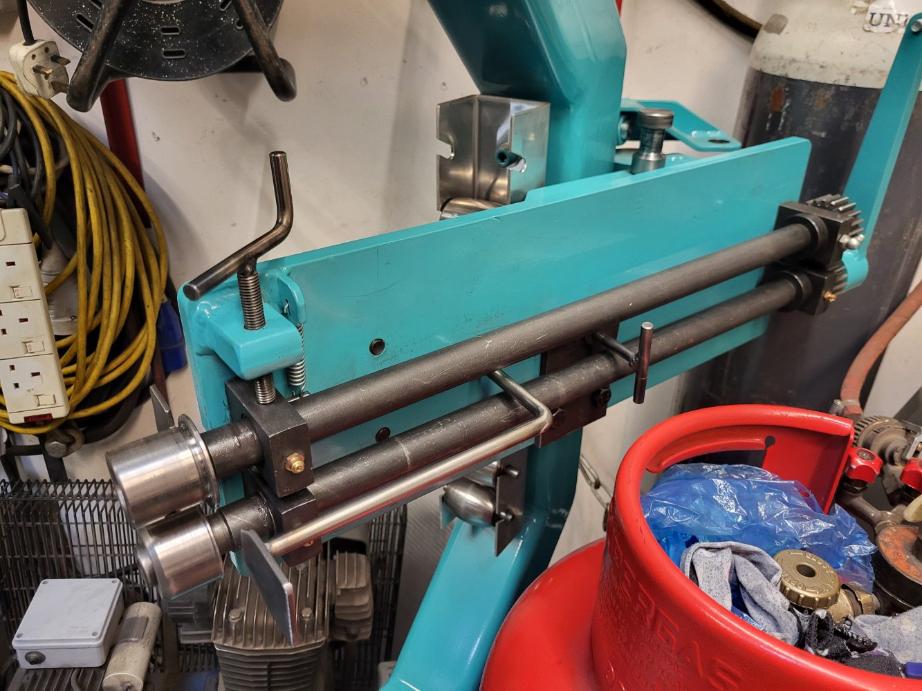

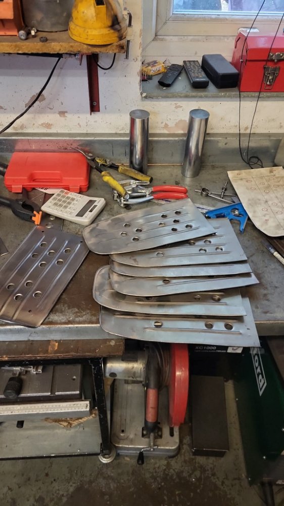

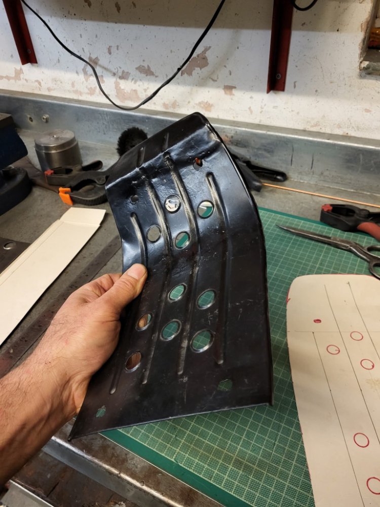

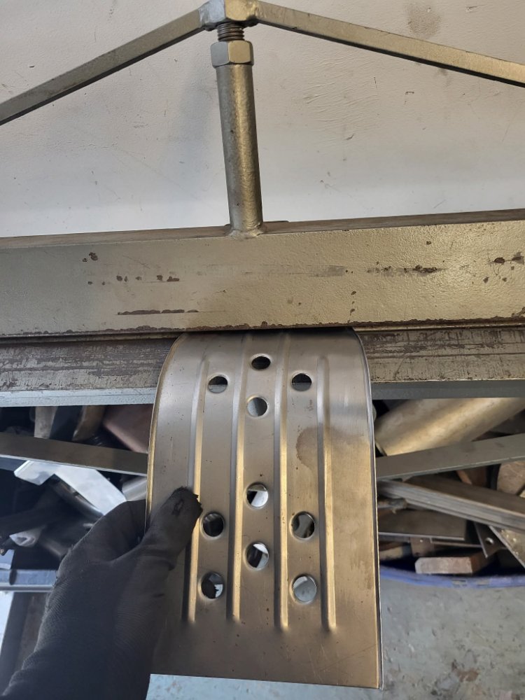

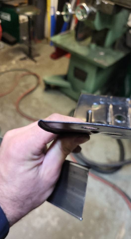

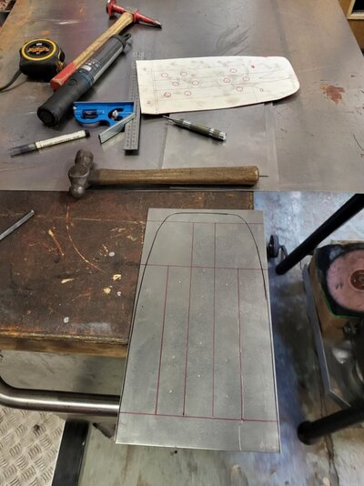

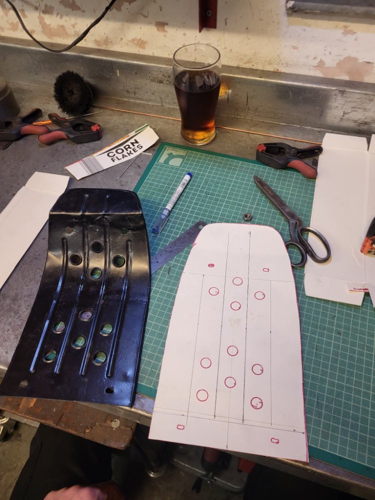

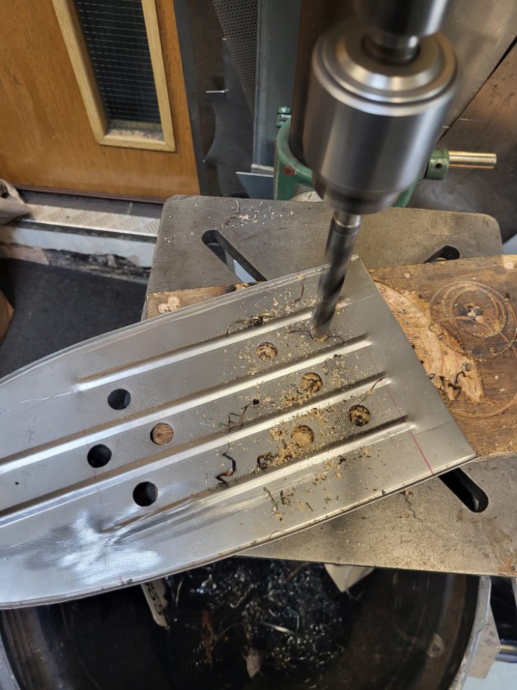

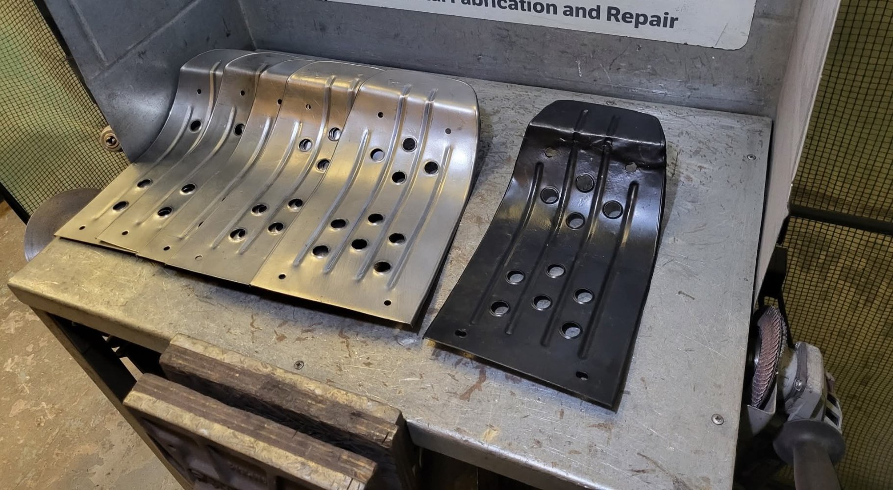

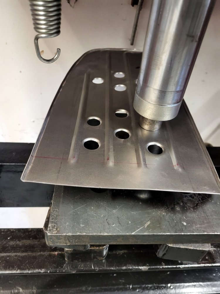

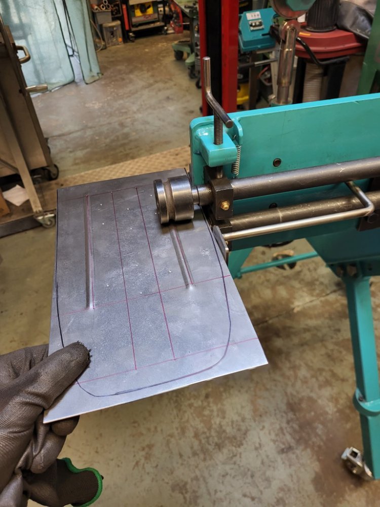

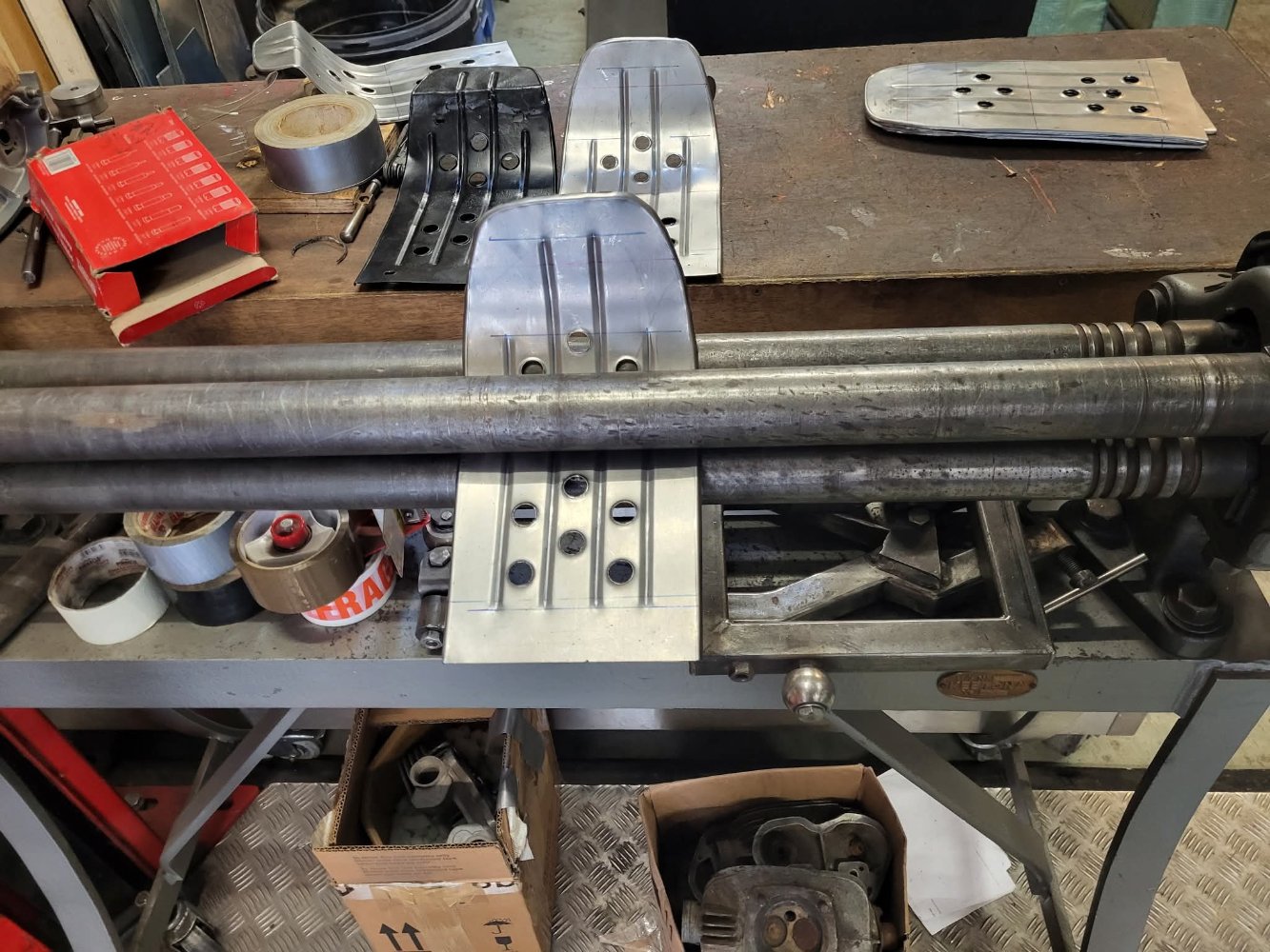

Had a job in this week to make some engine guards for a rare little Italian moped.
I had to make the edge and dimple dies specifically for this part.
