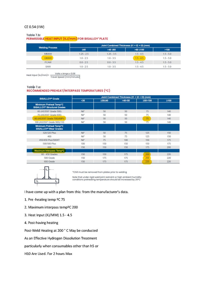

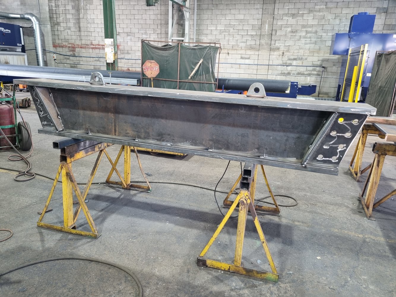

If you are afraid of the 3mm gap, what does the WPS say about this?The consumables are set.
It's above my position, but I'm sure the material has all the relevant mill requirements and records as this is a recurring job.
I'm worried about the root run in that gap of 3mm in that restrained joint cracking.
