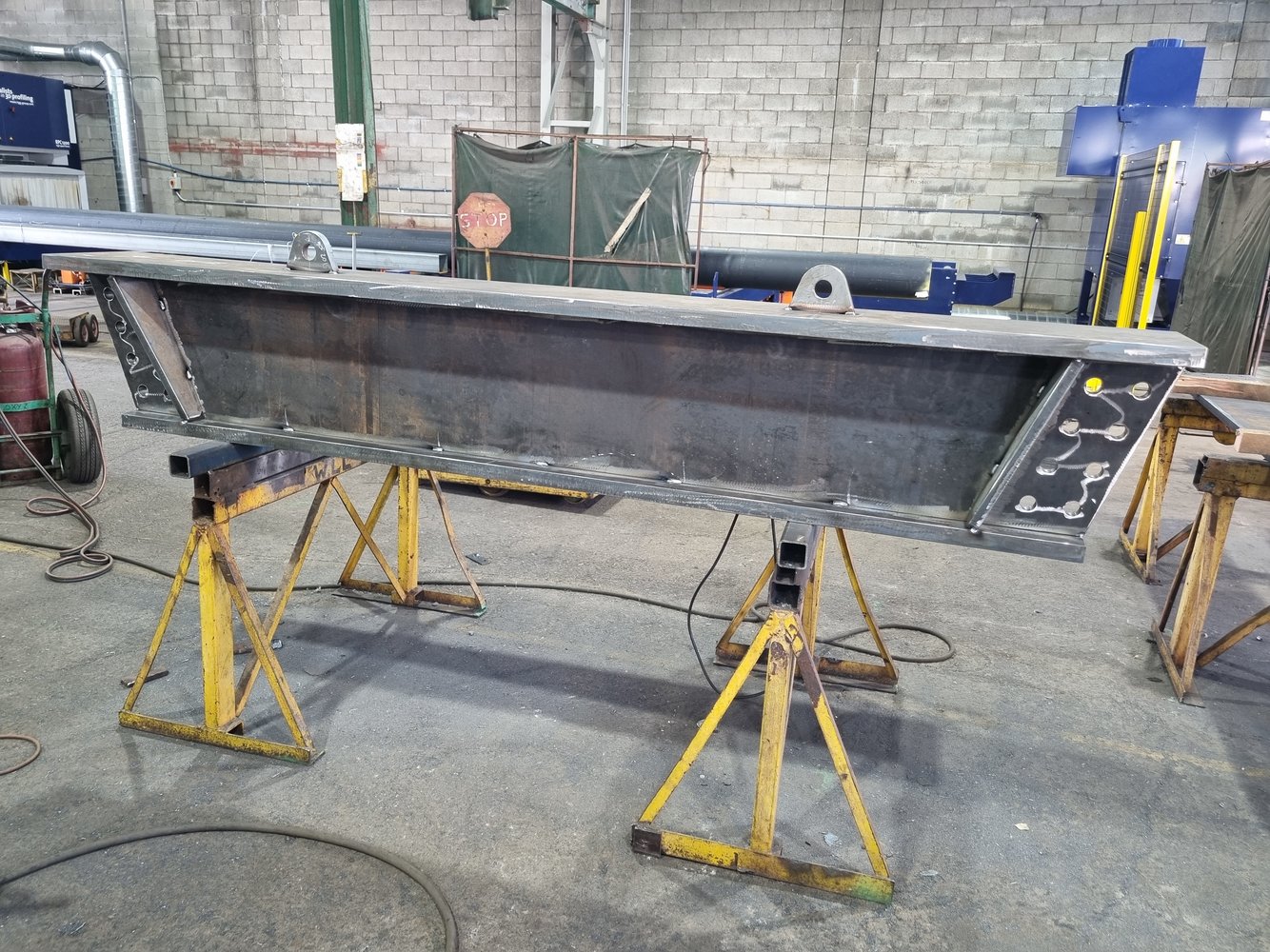

Fabricated some cross members, 32mm flanges,25mm webs.
Material is 700gr, all fillets 8mm.
I have some gaps of around 3mm between 25mm stiffeners and the flanges on an angle, any suggestions about welding these gaps, GMAW 5/2 gas, 1.2mm CrNcMo solid wire.
