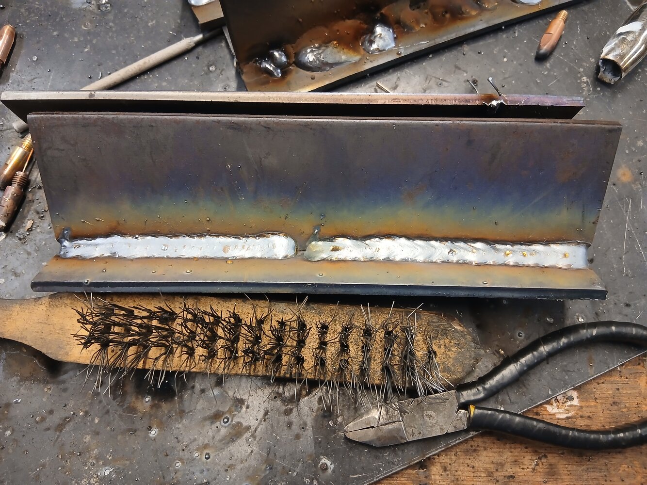

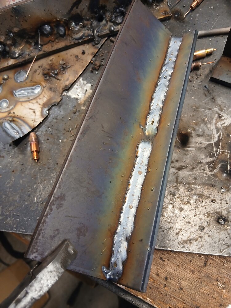

It's not too much better on the MIG side. The voltage looks correct at max volts. I'm seeing fluctuating figures from 23.3 up to 25 volts so the volts are all there. The max wire speed appears to have dropped. It now welds horribly globular at max volts and max wire speed, although there is sufficient wire speed further down the voltage range. It seems I will be getting the screwdrivers out again.
