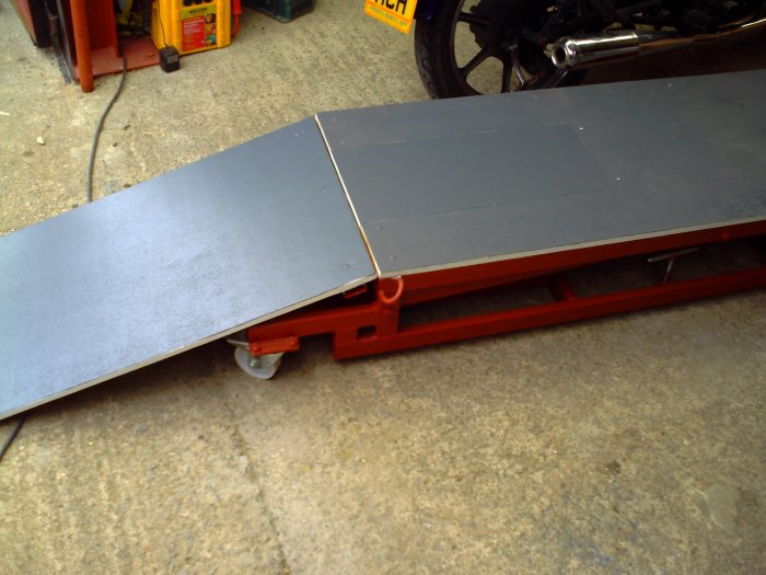

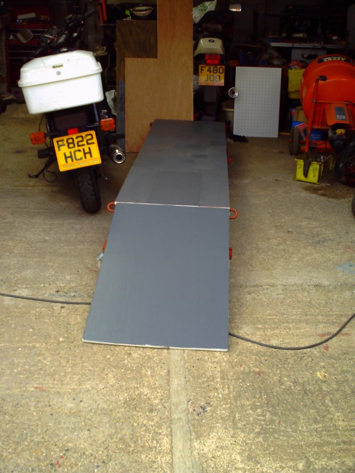

Brilliant!!![]()

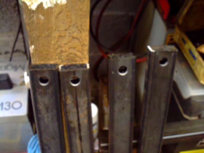

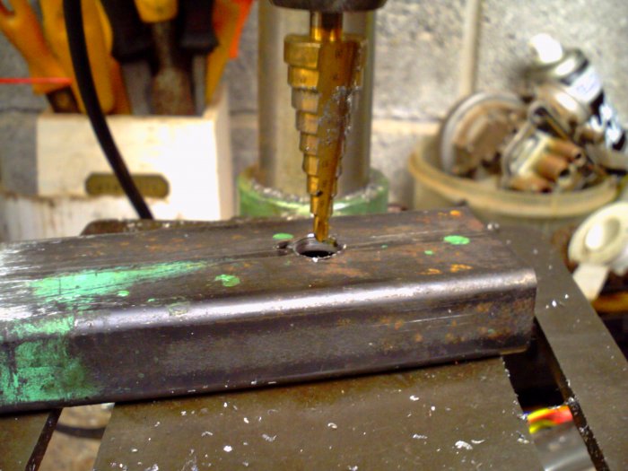

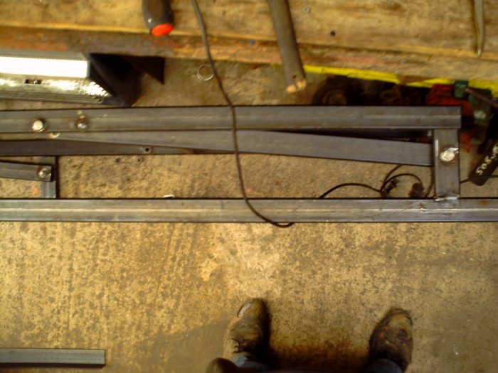

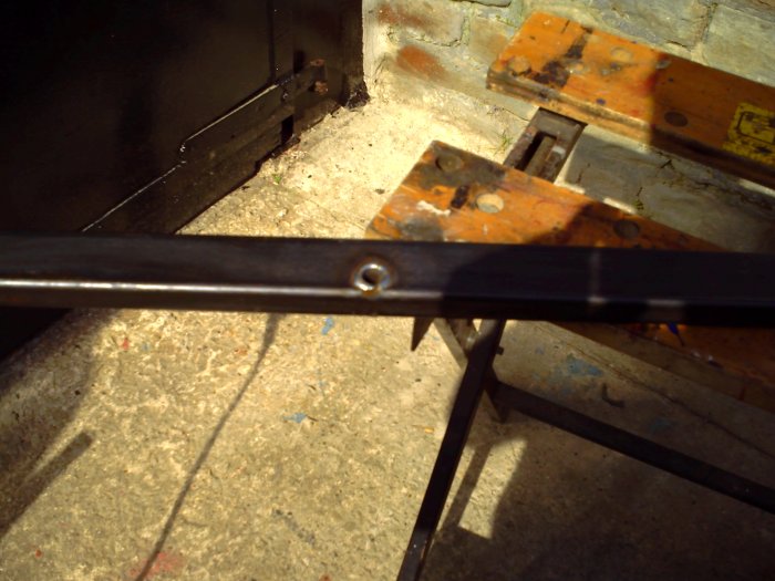

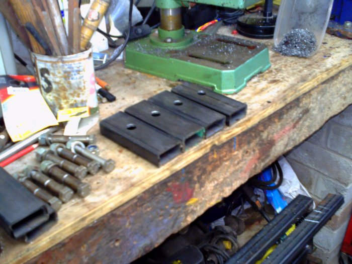

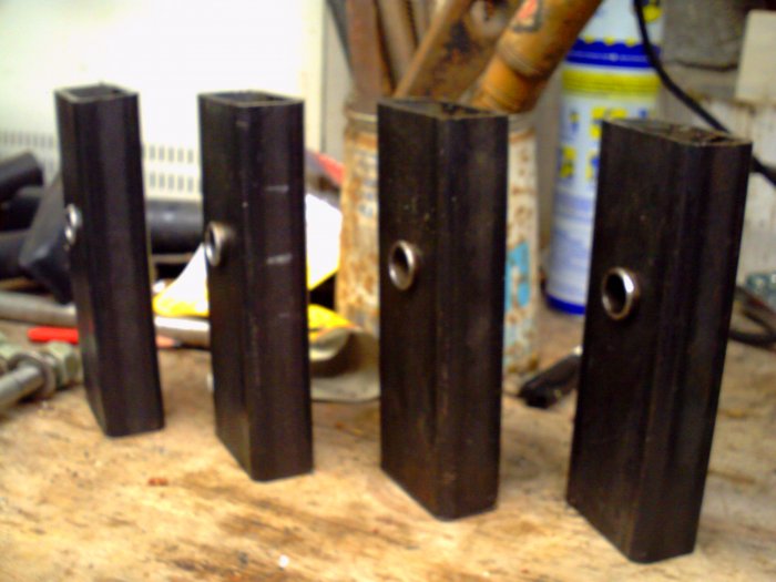

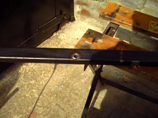

Do you have any more pictures or description of how you've done the pivots/bushings? That's a question I've been meaning to ask; How to do pivoting points?![]()
Tube and shouldered bolt?
Bit of tube I found in my scrap pile was just over 12mm ID and fitted the stainless bolts with a nice amount of working clearance.
Bushes cut to have about 2mm protruding either side to give something to weld to once welded in they were ground back leaving roughly 1mm proud either side which gave enough operating clearance between the frames and uprights and retained most of the weld strength.
heres some pics
