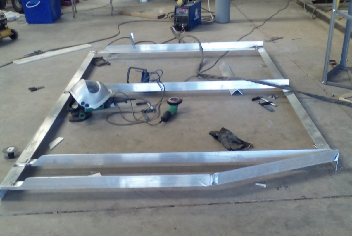

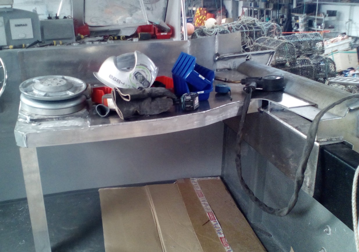

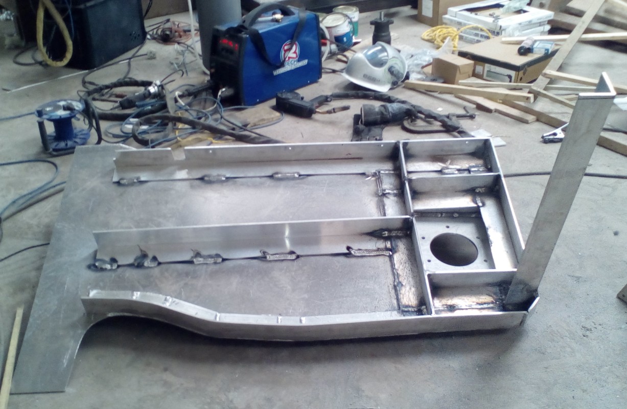

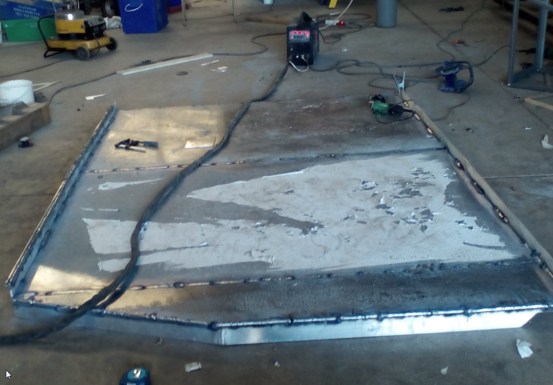

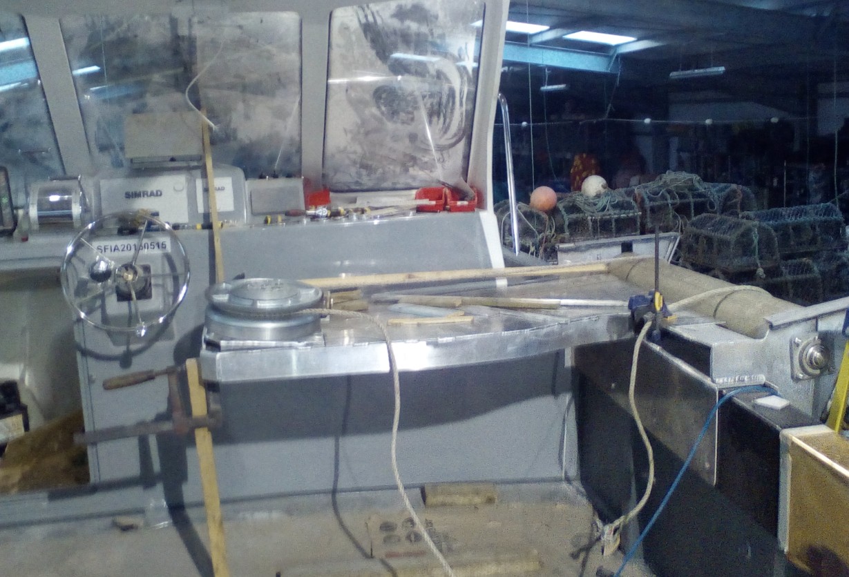

Bit more progress today, made up a hauling table and an angled base for the hauler, the MTS has no problems at all with the 8mm Alu
Table is made of 5mm 5083 with 3" x 3" x 1/4" 6082 angle, the hauler base is made up of 8mm 5083.
Will be milling out the top of the base tomorrow to accept the hydraulic motor and mounting holes and then will hopefully get some more angle underneath and then the base welded to the table.

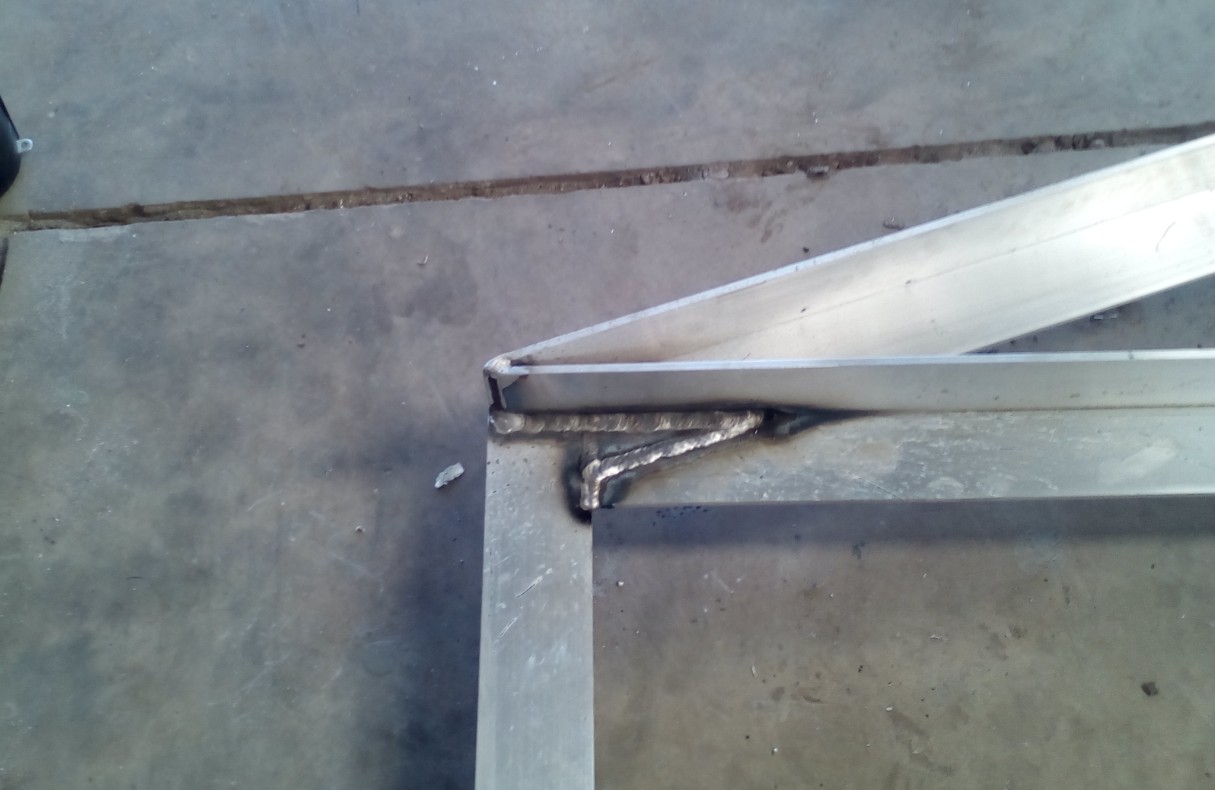

Will have to try and rig a camera up with its own helmet so I can block the backlight and also look at the weld itself rather than having to try and watch it via a camera screen, hopefully that would make things a bit clearer.
