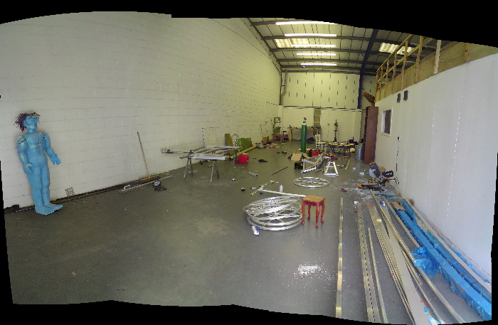

Hey y'all.

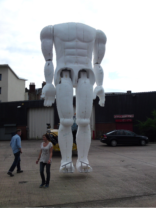

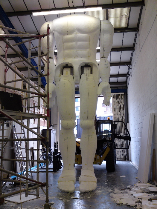

I've a big project on at the mo which is a bit off the wall, viz, I'm designing and building the skeleton and operating frame of a 7 metre high puppet. We're starting to have something to show for it, so it's time to put up some pics. Sorry, these don't show too much, but in the first pic you'll see a blue fella on the left. Apparently it's going to look a bit like that... not that i'll be doing the exterior covering, which is polystyrene.

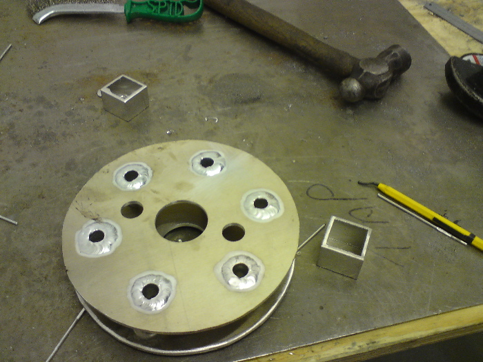

The "puppet" won't be operated in the normal fashion, by a big hand pulling bits of string, instead there are a load of wheels and pulleys inside which will operate the legs and arms. The whole affair will have a telehandler boom through his back to hold him up.
Don't forget - 7 metres - his knee is higher than my head! Sorry the pics don't show much, more will follow.

Workshop and big fella.

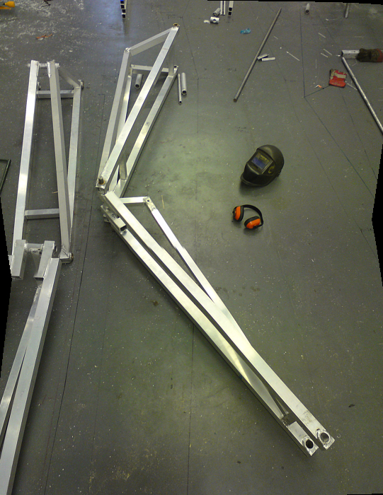

Upper leg

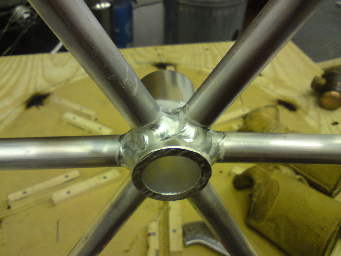

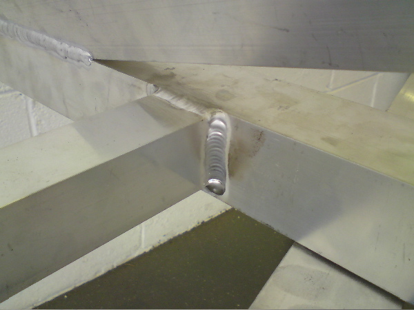

Just to show I can run a decent bead at a push.
