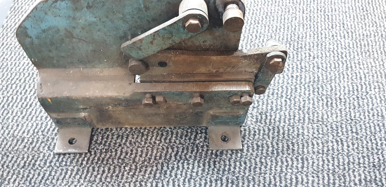

I'll be interested to find out if they're any good, from the horses mouth rather than merely Googling for a recommendation.

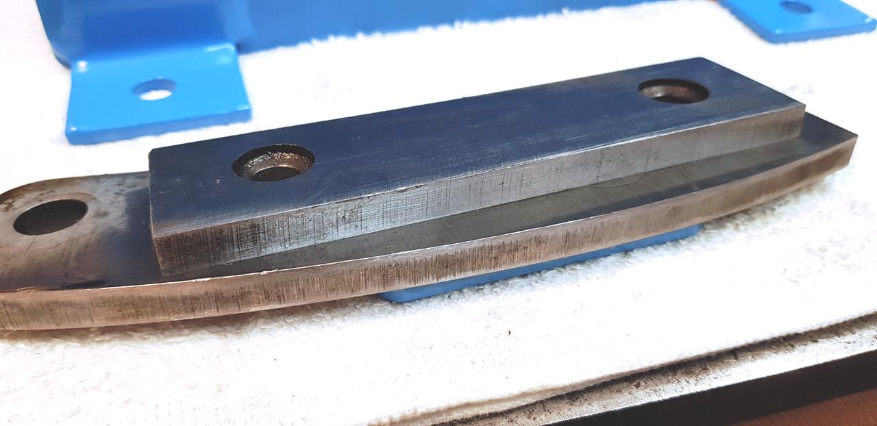

I hesitate to suggest anyone because I have used a professional blade sharpening outfit once: for my precious, irreplaceable twelve inch blades from a mitre trimmer I restored. Basically, I paid good money for them to be ruined beyond usability. They ground them so short they would no longer reach.
My other interest is to discover what if any special profile should be maintained. Easy to imagine they're a simple dead square right angle with a flat grind but I'd be interested to discover if that's true. I know some cropper/chopper/trimmer blades have a slight concavity, dunno if that's also true for these big crude sheet croppers.
