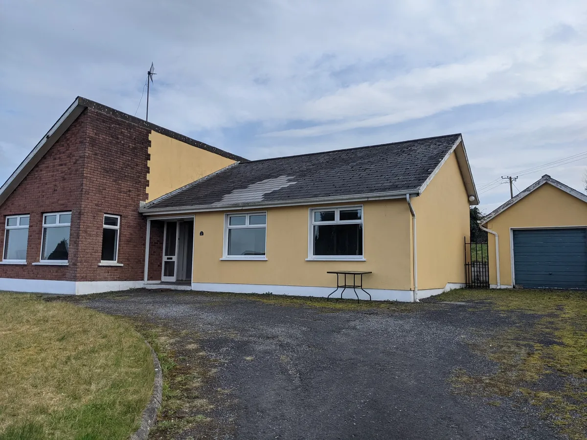

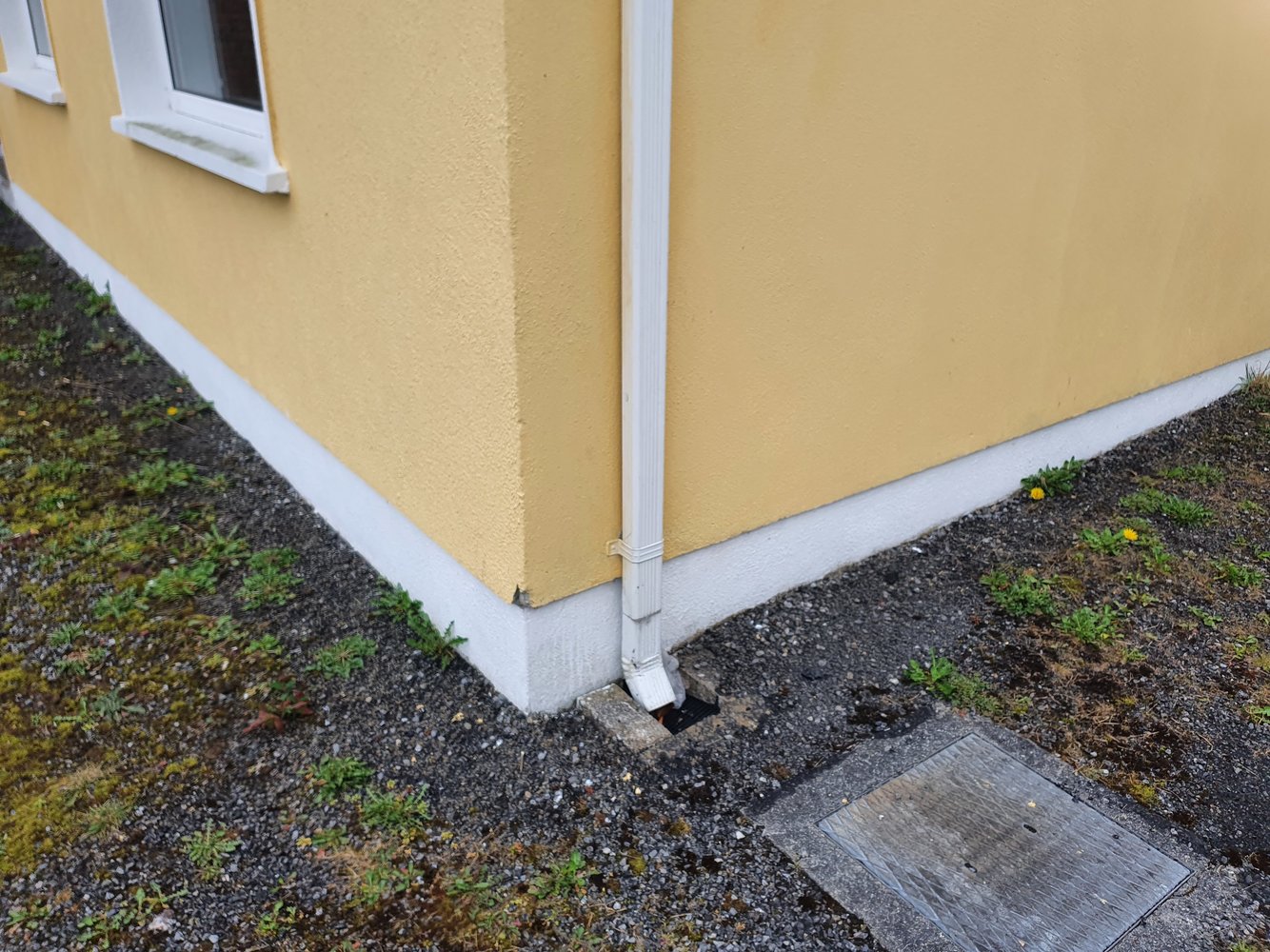

I would say alot of the problems come from that down pipe...I bet it's constantly getting blocked, looks like it's simply a brick built gully...full of shingle

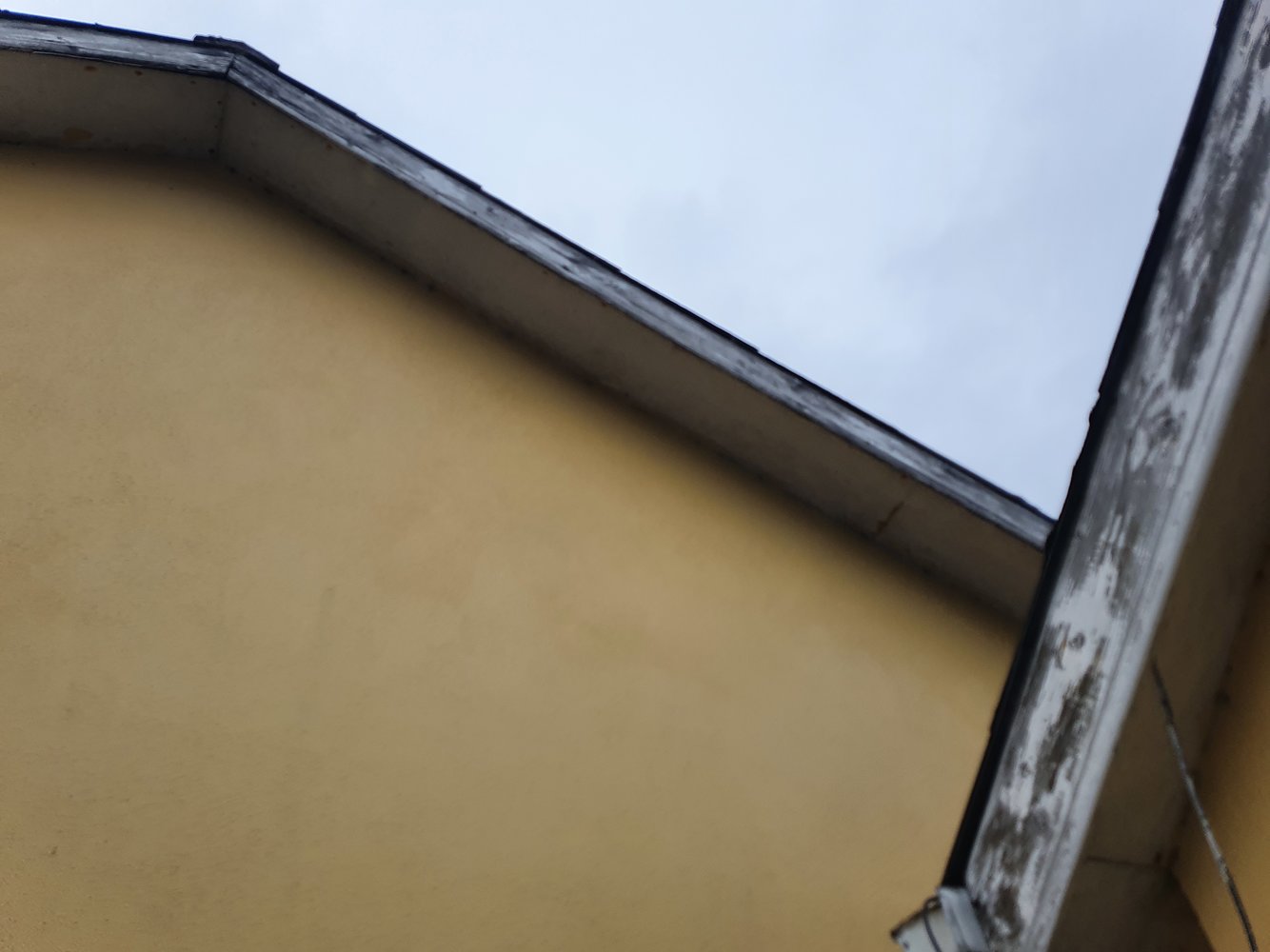

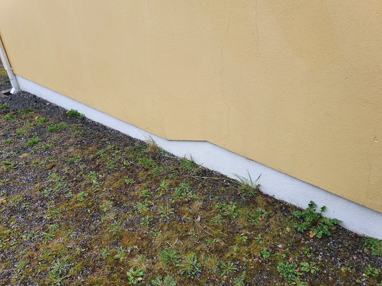

From reading all the above and looking at the following pic -- Keeping in mind there is no mould on the rear bedroom corner.
There is slight decline from the rear of house towards the front, so possibly excess damp is sitting towards the front side of the gable and the rear side is just that bit higher.
If its in a location youand significant other like at the right price, get it bought. Nothing that cant be fixed once you have a good dig and understand what it needs.

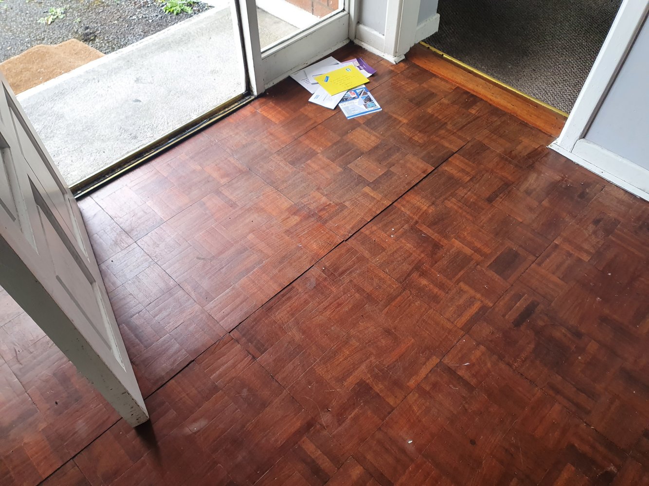

Are the floors solid or wood?
Jump up and down in each room and youll sharp tell.It's just me.. I'm currently trying to eek out whether or not the auctioneer is bidding me up.
The floors would be solid. In the sense that, as others have suggested. I haven't often come across floors suspended with rafters etc.. They don't feel hollow to walk on if that makes sense.
