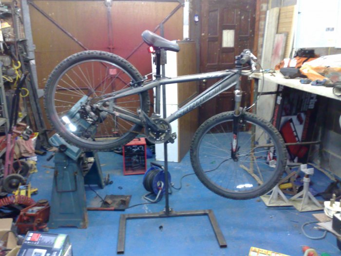

My nephew wants me to make a stand for him ,i've had a quick look on eblag and got a few ideas ,just wondering if anyone has made one ?.....what size clamps will cover most bikes?....any body got some pics,especially of the clamp ,many thanks Gav

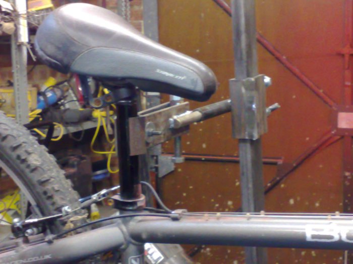

Thanks for the replies ,will have to be freestanding ,portable would be best,he spoke of a clamp on the seat stem and is quite happy to use old inner tubes to protect the stem ....food for thought ...any pics would be useful,..prefer to use a tried and tested rather than re-invent the wheel ......cheers all Gav
knocked a frame up out if 25x50 box i had here ,i will prob beef up the rod attachd to the bike clamp it was all i had here and i had to wait for a courier pick up,so couldn't go out and buy anything,,,,,thanks for all replies Gav

would think that was cheap.....brand new ?.........compared with kestrel link earlier......still nephew was happy with his ,doesn't fold as small as yours but fitted in his corsa
