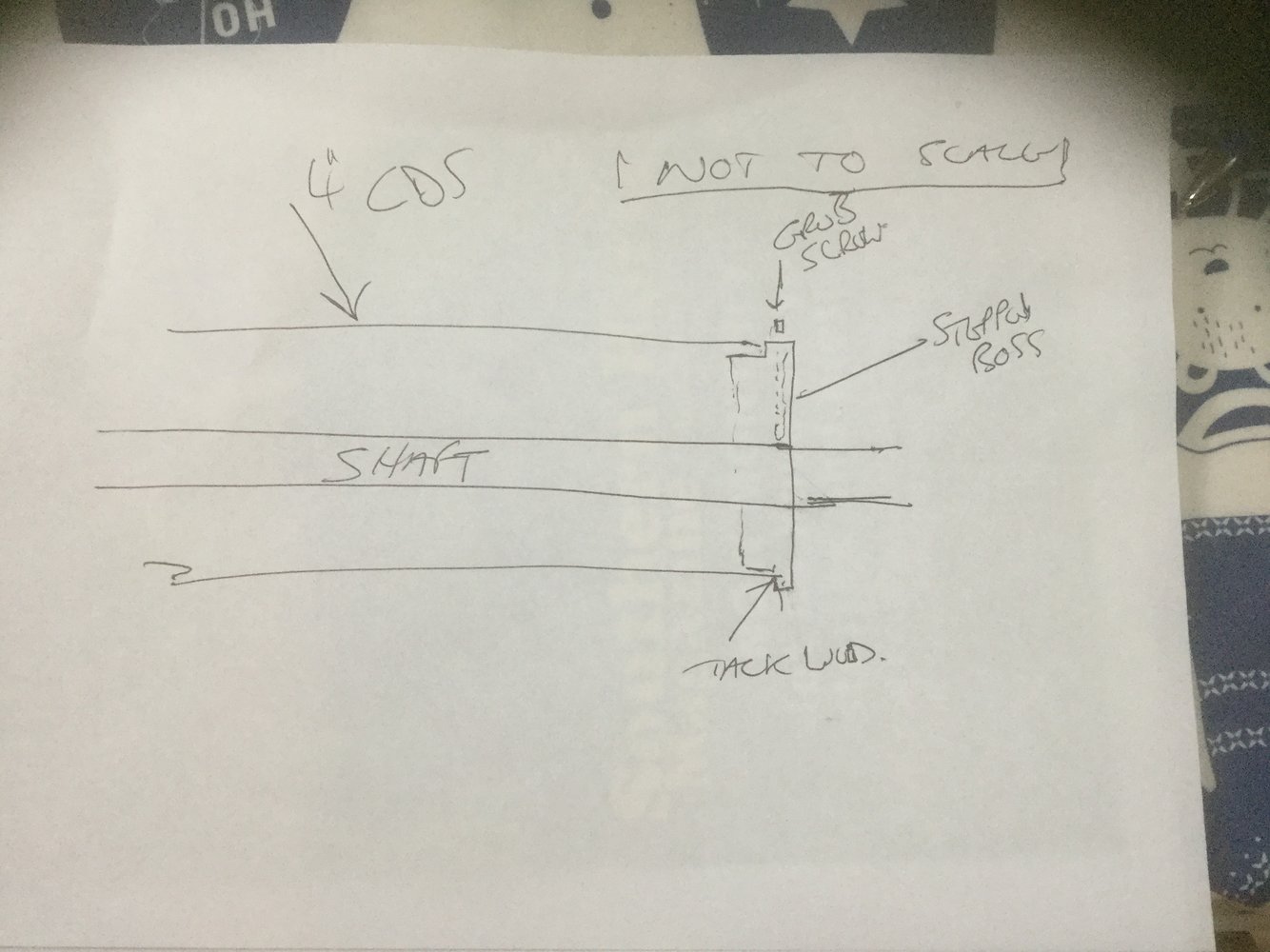

Basically, i want a drum to spin on pillow blocks, and ill have a pulley with a belt to a proper motor.
I figured the drum would be a bit of 4" steel tube, that id weld caps onto the end of, and, i guess, either weld stubs onto the caps, or run a bar down the whole length.
But if its spinning, im never going to get perfect alignment, and it will wobble all over the show.
Maybe i could get it close and then find somewhere with a big enough lathe to just skim the outside of the tube and the end (and then the other end) but is there a way i can do it in house?
I guess i could set it all up, and then somehow mount a grinder of some sort on a carridge, and grind it whilst its spinning, but it may be easier, and with a better result, to find someone with a big lathe?
