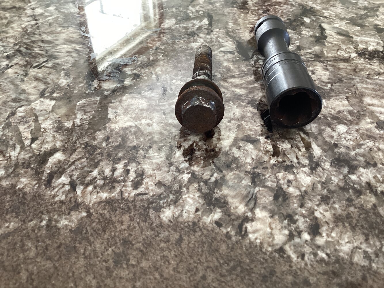

Whatever gas you use, the bolt has to get to (almost) molten red - if it hasn't got hot enough it won't release. Tbh oxygen with propane is the game changer here......or get a cheap welding set... I only have a canister blow torch though.
