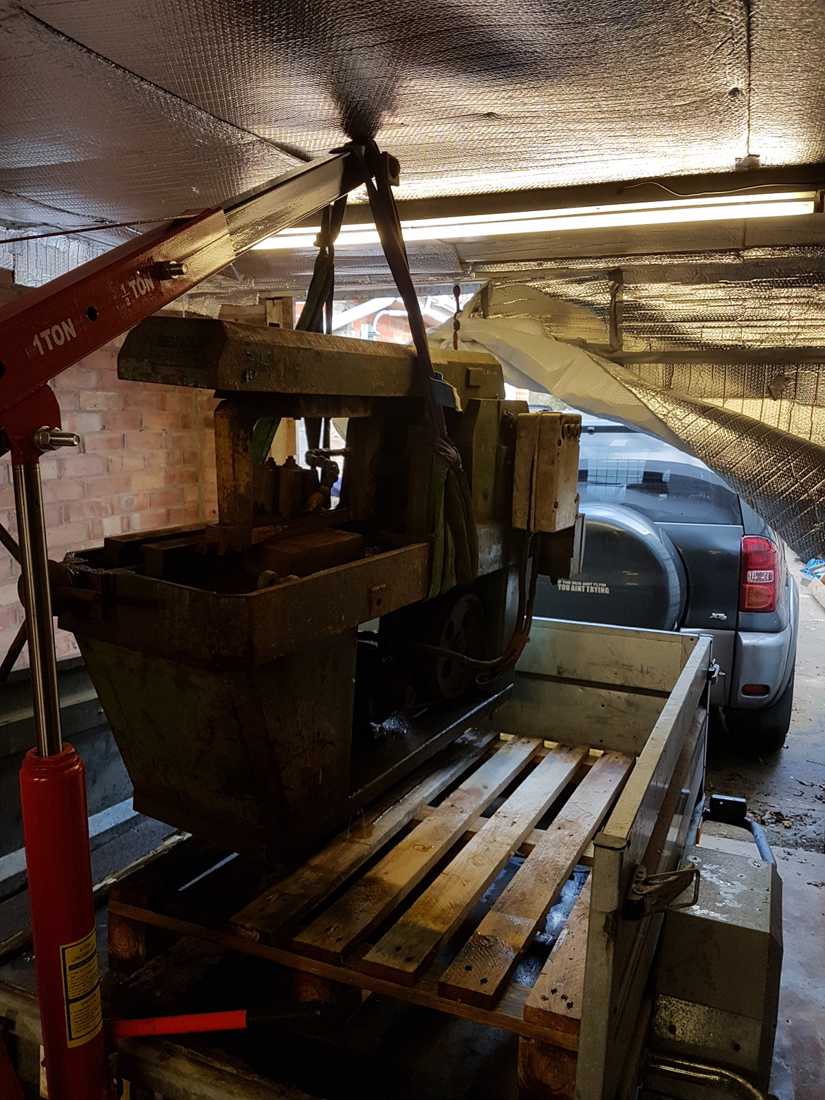

That would be 2 pallet spaces.
It could be done if on a custom pallet. You are allowed 120x120 so put it on a 2m x 1.2 pallet.
Needs to be bolted or strapped down.
Line the pallet with plywood.
Make sure the lifting point is under the centre of gravity!
A forklift makes life much safer.
A tail lift will cope with 1000kg but the closer to the limit the harder it gets.
I have bought things on Ebay before - travelled to the seller and palletised myself. Then sent through one of our networks.
Even a Bridgeport is safe IF done right!
