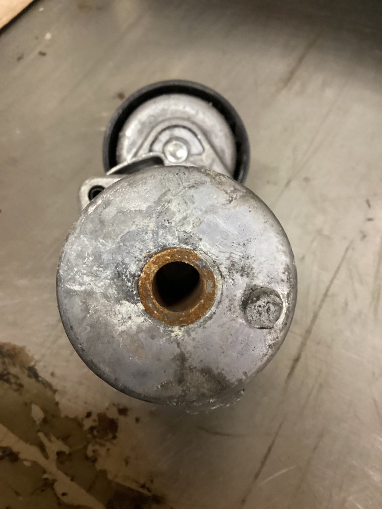

I’ve a bolt from an auxiliary belt tensioner which has snapped off in an engine block, steel bolt alloy engine, what’s the best way to drill it out?, I’m asking because I’ve not had much luck in the past with doing this.
Bolt is around 10mm diameter, I’ve got some cobalt bits and I’ve also bought a set of left hand drill bits made by Sealey, couldn’t find decent cobalt left hand drill bits, I’ve also got an easy out kit, bought a spring loaded centre punch as well for getting started.
To make it even more difficult I can’t see the area I’ll be working in, I can get a drill in but it’s too low down to see it without removing the bumper and rad pack, basically the complete front end in a 14 year old car.
I do have an endoscope which connects to my iPad so I’ve a descent enough screen size to hopefully get this job done, been putting it off for months now so I really need to get it done.
Should also say the bolt didn’t snap off during removal it happened in service, I’d fitted a complete new belt pulley and tensioner kit so I don’t know what the hell went wrong, the belt was fitted correctly, it’s a 2.0D BMW 116, there’s a round alloy positioning tang from the tensioner which also goes into the engine block and that’s snapped off flush with the block also, I can only surmise that the tang snapped off first allowing the tensioner to be stressed from side to side as the belt would be grabbing on and off snapping off its mounting bolt. Apologies for the long winded explanation.
Picture of the tensioner and the snapped off tang, what size drill bit should I start with, and then should I go up one size at a time? I don’t think the remnants of the bolt will be stuck in, it’s a new bolt and I probably used some copper grease when I fitted it, I can’t remember
